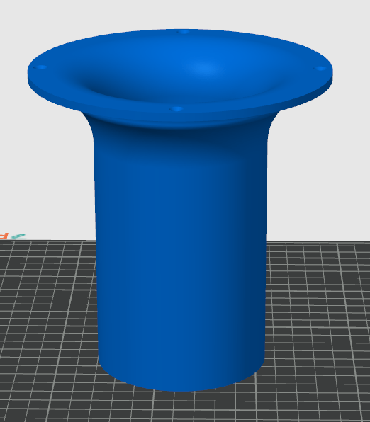

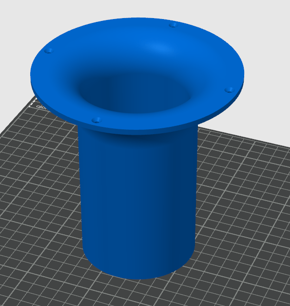

Need some help with my woofer and its port. Getting huge rise in deep bass out of this Peerless 8"
Just a tip - a good port design has a flare on both ends. The internal end is every bit as importiant as the extremal end.
Also the dimples will make it worse, just go smooth.
If you flare it gently over the full length you can make it shorter since the middle will be a little more narrow, but that doesn't reduce the output level ability so it's mostly win-win.

My ports have pretty extreme flares. With the advent of 3d printing I can make objects that wouldn't work so well with injection moulding.

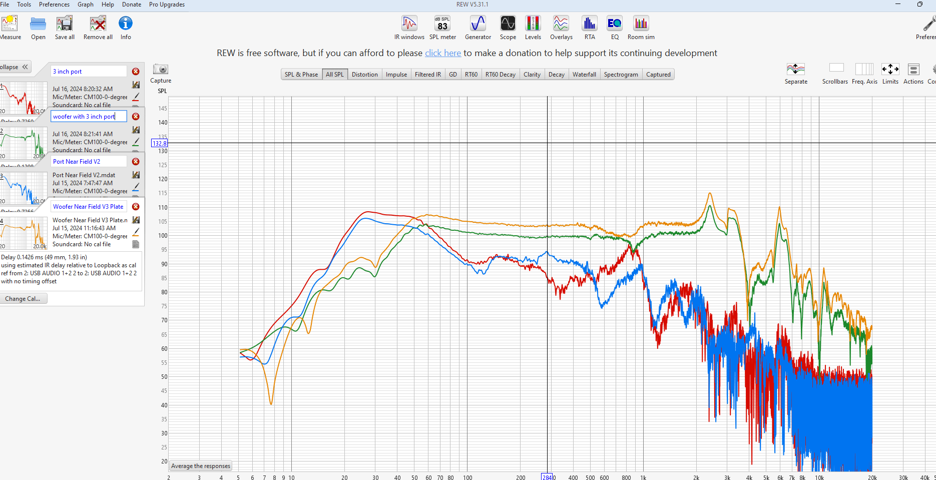

I thickened the port walls and went to a 5" long 3" diameter. It did lower that 800 hz peak but thats about all it did. Thats actually probably worth it. Depends on if it chuffs at 3". The flare on the port is pretty extreme though

OK. I keep trying to zoom in on it to see if there are ny changes in the low end. The difference might only be 1 or 2db. A couple of things here:
1) I wouldn't worry much about the 800Hz thing because those frequencies should be well suppressed with your crossover.
2) How long is your 4" port? You might be better with it but it has to be as long as possible.
3) I will be home tonight and I can simulate this all in Basta and get a better idea of which port will do better for you.

Sorry to hijack, this graph shows again what I'm still trying to understand. Why doesn't the dip in woofer response line up with the peak of the port output?

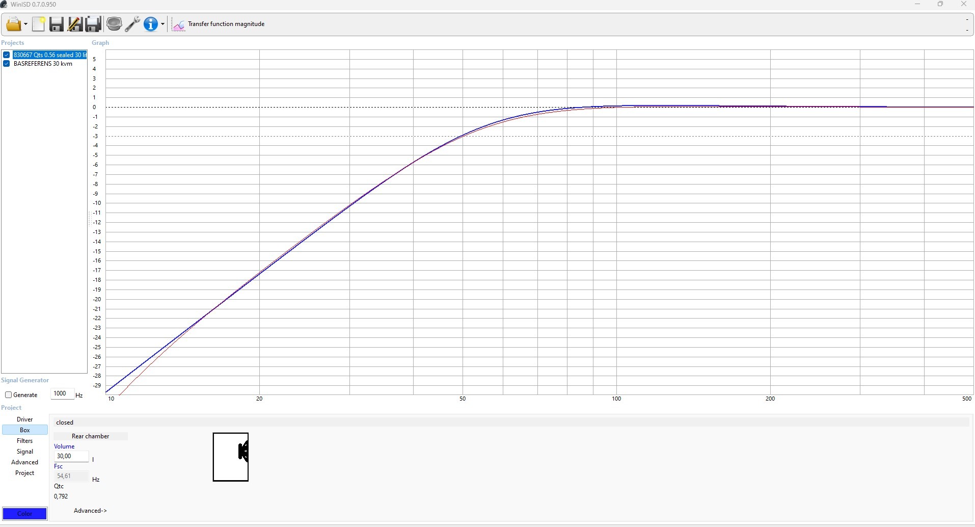

Best you can do then is to make the cabinet sealed, because that 830667 is a very suitable driver for a 30 m2 room size.
Matches my target curve very closely when using the Qts = 0.56 data.
Reduce the volume to 30 liters if possible.
Yeah, I already saw this. I decided on the boost in bass from the port rather than the loss from the seal. At least this way I can decide how much I want to annoy my nieghbors. Just seal it or port. Its swappable

OK. I apologize for generally leading you in the wrong direction when you have been on the correct path (mostly). All of my modeling with the wrong T/S parameters was problematic. According to Basta, which is a program I highly recommend, either port is going to give you the same result. Your measurements have confirmed this. It does say that this driver would do better with a smaller enclosure and as someone above recommended to stuff it, I think that's a good idea. If it were me, moving forward with this box and configuration, I would stuff it and design the crossover around what you have with the 4" port. Be careful with the stuffing blocking the port or being too close to the drivers. Otherwise, I think it's going to be fine. You will likely have an excess of low end so keeping these away from walls will be beneficial.

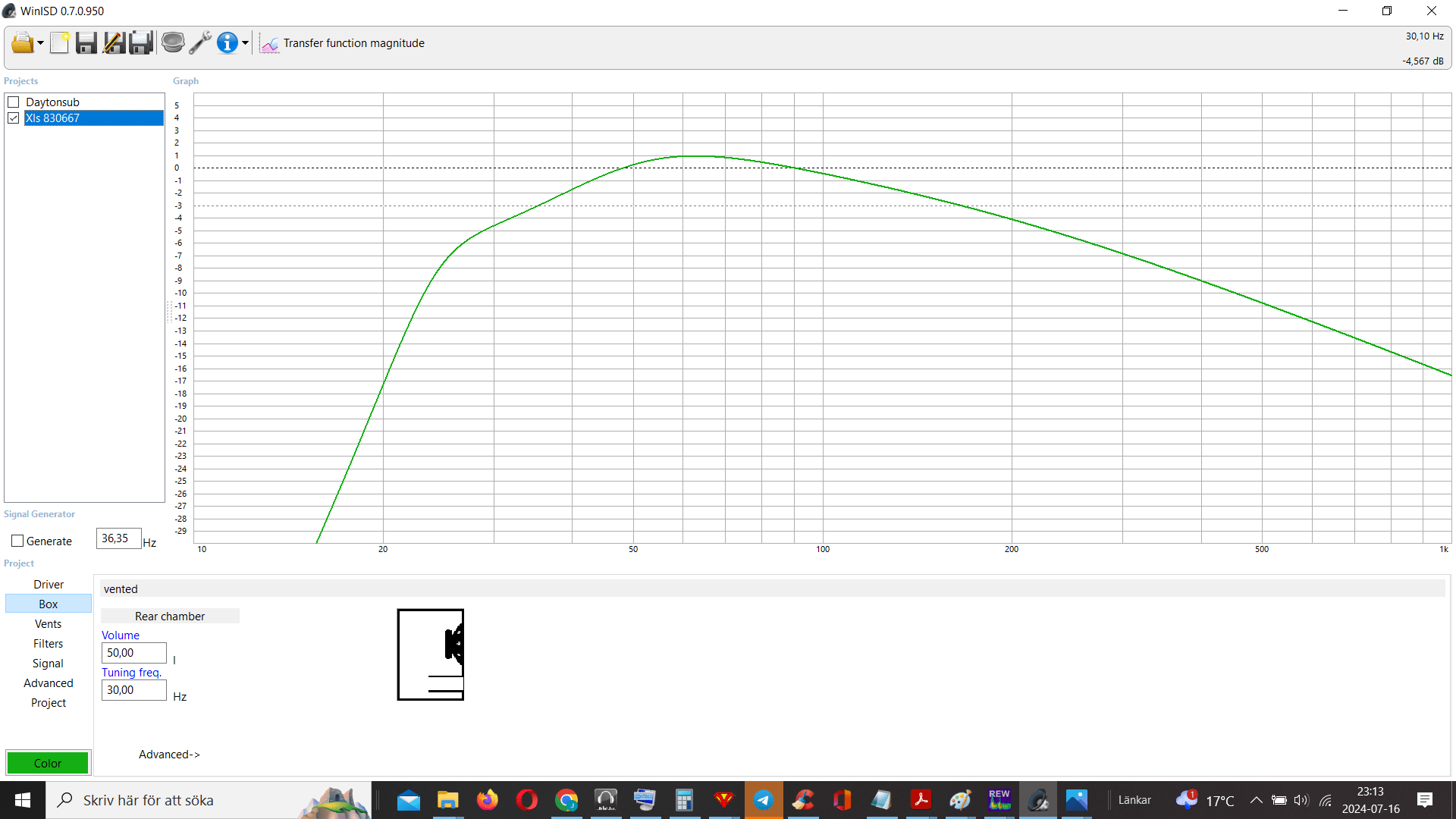

A bit late to the discussion, but still…
I examined the picture of the system. Tallish enclosure with port down below. Such designs do not follow classical reflex calculations but rather behave as a MLTL. In which the (vertical) position of the woofer becomes an issue. The sheets of MJ King come to mind.
In general, a port so near to a cabinet wall will not follow theory anyway. The air spring cannot function 100 percent. That often won’t be a big issue, but one should not neglect it.
I use it in 50 liter tuned at 30 hz.
This with HP 25 hz and LP at 150 hz, and have Faithal 5FE120 from 150 hz.
Real good quality bass in 50 liter reflex

WinISD do not add for room gain, so the result you get is response in complete free field with no boundaries at all.
When putting that speaker into a room you need to add room gain because of reflection of floor, ceiling and walls.
So basically the result you get from WinISD do not represent the final result by it self.

830667 is very well suited to be used in a quite small closed box. It is designed for that purpouse.

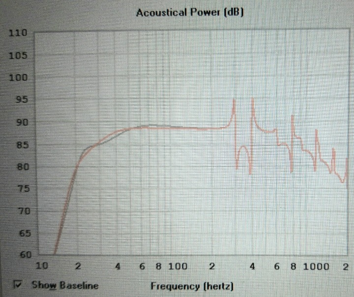

I just did a quick simulation - just in case you want to try a filtered bass reflex alignment:
1) Tune the helmholtz (bass reflex) resonance to about 25 Hz
2) include a series cap with ~2000 uF (eventually two polarized 4000 uF caps in series with negative leads connected).
grey: without cap, red: with cap
