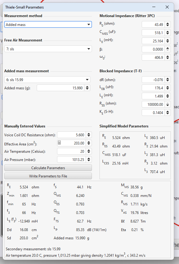

The only thing I used off the website is the SD. The rest is pulled from measured Thiele small parameters
OK. I didn't realize you had measured for Thiele small parameters. My apologies. My model is now saying a 4" port at 11" long would work. It gives a 3db rise below 100Hz down to about 35Hz, but it looks a lot better to me than what it looked like before. I don't have my PC so I can't model it in Basta to see what your max output is at these low frequencies, but we are within a workable place now in my opinion.

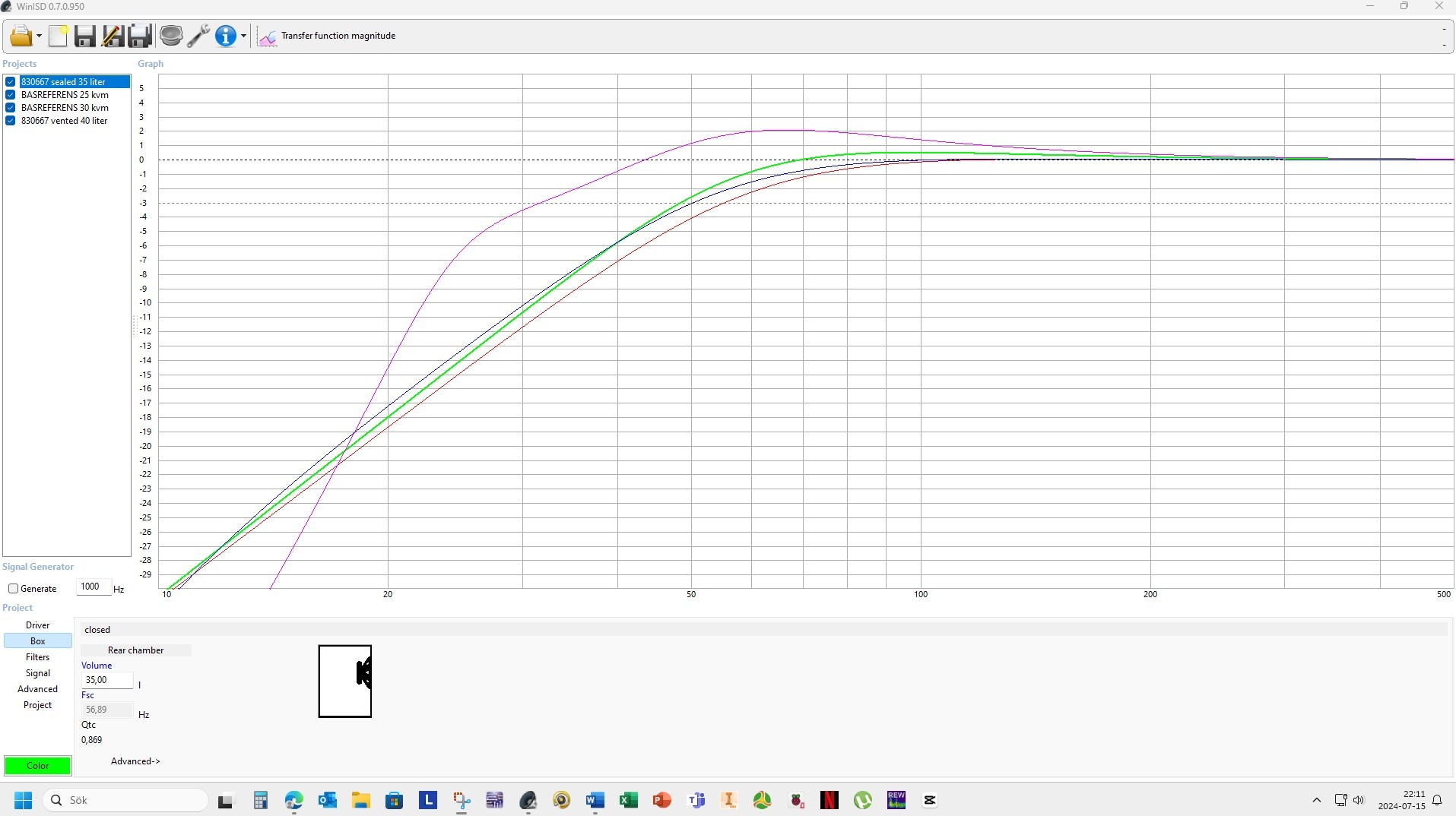

Bmsluite...
830667 is not well suited for a vented design with a EBP at 56.
Look at the attached picture which contains freefield simulations.
So when placed in a room you will gain bass from room boundaries.
The red line is target curve for combined output for driver and port in a 25 m2 (square meter) room~270 ft2.
The blue line is target curve for combined output for driver and port in a 30 m2 room ~ 325 ft2
With room gain those target curves will have a flat response to 20 Hz in your room.
Light green curve is simulated response from your driver 830667 in a 35 liter cabinet. That's approx 1,25 ft3.
The purple curve is simulated response with a 40 liter vented cabinet as per Parts express recommendation.
That will not work at all. It will give you a very prominent peak of +6 to 7 dB around 30 Hz and way to much bass below 100 Hz.
Simply close the port and elaborate with distance from rear and side walls to find the best tone and resolution in bass response.
If possible, start with 30 inch to side walls and 10 inch between rear of cabinet and rear wall.
Then increase distance between rear wall and cabinet until you find a bass quality you like the best.
Good luck.

WinISD do not add room gain which will increase the bass output.
Depending on the size of your room the boundaries of walls will start to amplify bass from approx. 35-55 Hz.
At 20 Hz room gain usually are 15-22 dB pending on size.
So if you have simulated for a flat response in WinISD you should add room gain.
The best way to handle that is to set up target curves like I have done.
When you simulate and hit these curves you will get a fairly straight response when your speaker are placed in a room.
If you tell me your room size I can simulate a optimization of cabinet volume for your room and 830667.
When designing for a vented cabinet EBP sould be close to 100 to have a chance to get a good bass response.
EBP = Fs / Qes
