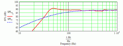

Lookin' good Mutuano. I see no reason not to go ahead with the cabinet. The port can be tuned after assembly and bracing can be added/changed later. Any changes inside the cabinet will not be visible after assembly. I'm curious to know how the port tuning goes. In my opinion either the 18mm or 20mm doubled up will do (in this case). Anyone see any reason not to go ahead speak now 🙂.
Kevin
Kevin
Hey Kevin,
I'm curious too!! 😀
Anyway here it goes revision #5.1 with suggested vent and mass load drive support.
After to get the OK from all. We can step forward and discuss tweeter positioning (center or off-center) and leave the front baffle square of rounded. What do you think?

Baffle Diffraction Simulator
I don't like that woofer support. It reminds me of the diving board at the pool. It supports the weight of the motor but it doesn't effectively couple the mass of the cabinet to the woofer. If I were you I'd go with the vertical brace or eliminate it entirely.
With such thick walls you can afford a healthy roundover on the front baffle. A baffle diffraction simulator will help you determine where to put the tweeter. Try this one:
http://www.pvconsultants.com/audio/diffraction/downloadbds.htm
Kevin
Kevin

Cone/dome tweeters XO'd down in their point source (non beaming) BW should always be off-set at some acoustic ratio if no acoustic pad or at least ridge is used around them.
Rounding over sharp edges look nice, but it's only really effective when the radius is >1 WL, ergo if a 3/4" (19 mm) router bit is used it will only be effective above ~18,080 Hz, well into its beaming BW, so strictly cosmetic.
Anyway, if the XO point is 2 kHz, then the round over needs to have a ~8.14" radius, so you could split a ~16" Sonotube in half to make add on baffle round overs for both speakers and fill them with kitty litter/oil dry to damp them. Personally, I'd rather either just damp the baffle as required or make a simple WG to increase its directivity to a lower frequency, though as always YMMV.

Kevin_Murray said:I don't like that woofer support. It reminds me of the diving board at the pool. It supports the weight of the motor but it doesn't effectively couple the mass of the cabinet to the woofer. If I were you I'd go with the vertical brace or eliminate it entirely.
ditto
dave
Re: Baffle Diffraction Simulator
Me too, but I gave him two very good choices to choose from or use as examples to make some variation of and he chose to come up with this mostly unrelated sprung collar, so not knowing how to make it any more understandable, I gave up. At least it's better than just screwing them to the baffle.

Hey guys (GM, Dave and Kevin)
Thank you all for your suggestions. I'll go with Kevin and Dave and make first the cabinet and run some trials with and without the vertical brace.
Sorry for my misunderstanding referring to the drive support, GM. I tried to draw what I've saw at the pic. As I said I'll put the brace stuff on my test-list.
I guess that I have to put my hands on it and make it real. And any detail as round edges, vertical braces or vent length must come along with trials.
