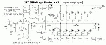

Hi buddies 🙂 Im from macedonia and im new on this forum 😛 If i do something wrong please tell me on time 😉 And of course i need scheme for 400w mosfet amplifier 🙂 ...
Does Somebody have it ?? With pcb ?Hi buddies 🙂 Im from macedonia and im new on this forum 😛 If i do something wrong please tell me on time 😉 And of course i need scheme for 400w mosfet amplifier 🙂 ...
Take a look here :::Borina Amaterska Svastara::: the Legend stage master is a good one.

Thanks to two colleagues but i realise that scheme from meanman1964 is better and much easier 🙂 ... But can somebody tell me 3 things ???
1. Does this scheme surely works ?
2. What transformer i need to get the full power from this amplifier ?
3. How much maximum real power can i get from this amplifier (RMS) ?
It will provide your 400W RMS into 8 ohms but you will need a lot of FETs and a LARGE heatsink - it will get HOT.
For 95V supplies you would need a transformer with 70V AC secondaries.. it would have to be large, 1000VA at least. You would need a lot of power supply capacitance also.

Agreed. Class AB is not really suitable for these power levels anyway. Class G/H is not simple to build either. If you really require this sort of power level, you are far better buying a commercially made amplifier. If you buy a second hand one in good working order, it will be cheaper than anything you can DIY.

800W in Class AB? It's ridiculously inefficient. If you really need 800W, you should be looking at Class D.

One simple way to build a high power amp is to use a lme49810 driver chip.
So you can focus on the output stage.
