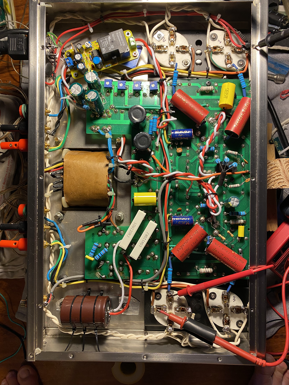

The PS is driving both channels so I think the choke need to be around 350mA to 400mA where it's really big to fit inside the chassis. I think my PT is 500mA.
So you separated to 2 - 12ax7 and wire them parallel in order to run as mono for each channel? Can you post the picture what it looks like.

No longer has hum, it'd dead quiet now. Hum was a nasty one to fix on this one. It caused by many other issues combine.
Broskie 2 diodes approach was a first try that didn't affect anything. Even tried later still no solve problem. Even tried Broskie's Ground House.
Tried many different GND point but not the problem either.
The previous owner:
-Converted 12ax7 and 6sn7 to DC filament at 6.3vAC so the 3 tubes got around 5.0vDC. I removed and put back to AC voltage.
-He used 290vAC line with Bridge for 300B and 310vAC with Half Wave for 6sn7 and 12ax7. This was one of the issue of the hum problem. I ended up convert everything to run at 340vAC with Bridge diodes for all tubes at 120vAC input. This also reduced a lot of AC ripple. The PT has 10v, 290v, 310v, and 410v at 110vAC, so when I push to 120vAC, I was able to use the line 340vAC
-6.3 C.T. didn't work out so I removed and add 2-100ohm to the filament to the GND
So the 2 steps to get rid of the hum were PS supply and 100r resistors on 6.3vAC. I walked backward to any GND loops that I have tried before and Broskie 2 diokie, it's really not affect to any hum problem.

It does help a lot to run at 120vAC. The 5.0vAC filament can run at 4.8vAC. If I run it at 110vAC, the filament is around 4.4vAC. Use resistors for 6.3vAC voltage drop from 7v to 6.4vAC. No longer need variac for 110v

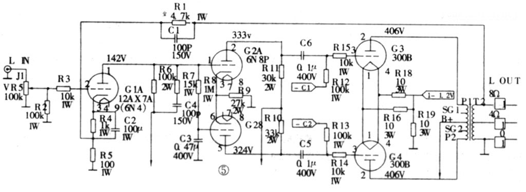

I wonder what R6 R7 are used for. R6 is the plate resistor but R7 with a cap makes little sense to me.Here’s the schematic:
I would remove all the existing mods and restore the amp to its original condition before thinking about “improving” it.
R6 is the plate load for the input tube.
The series network of R7 and C4 are the high frequency dominant pole.
They are there to set the high frequency gain and phase, so that the high frequency gain and phase of the rest of the circuitry will make the global negative feedback have good stability.
Without the dominant pole, the amplifier might turn into an oscillator.
It's a low-pass filter to prevent excessive high frequency response when the feedback is applied, thereby avoiding potential oscillation.
Much appreciate it gents. The NFB resistor of a mere 4.7k seems odd.
Is it because the gain of the 12ax7 is so darn high that they are applying a lot of global NFB to suppress it and to prevent the inevitable oscillation from too high NFB it uses a double dose of high frequency stabilization w the paralled cap as well as that low pass filter on gain stage plate?
