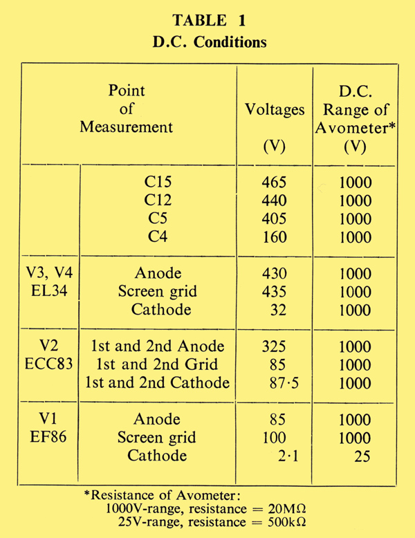

I suggest you study the Mullard 5-20 carefully.
Twenty-Watt Amplifier
At this page you also have a picture with measured voltages that I attach below.

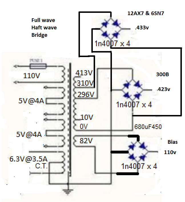

Thank you for your help 45, that explained everything. Before buy additional PS, do you think mine would work this way as in the image?
Can I take 310v to use for 12ax7 and 6sn7? Would it drive too much load on the transformer? This way, I can get 333v for 6sn7 and 142v for 12ax7. Then keep 300B at 344v plate and -70 cathode.

Alashikata,
1. Your 110V bias supply is a Positive (+) bias supply.
Don't you need a Negative (-) bias supply?
For Negative bias, you need to rotate the bridge rectifier 180 Degrees.
2. 296VAC x (Root of 2) = 418.6V. (ignoring 2 diode drops of about 1.2V)
You need more than 296VAC to get 423VDC.
3. 310VAC - 296VAC = 14VAC (ignoring two diode drops of about 1.2V)
14VAC x (root of 2) = 19.8VDC
4. Stacked B+
418.6VDC +19.8VDC = 438.4VDC
And that is if it all works.

😀 Sorry, I forgot to rotate the image when I tried to put together, it's actually negative bias.
The only thing I tried to rework the PS, not really touch the bias. I can use 413v wire to get 400v B+ but I think 350v B+ is fine. I got this amp for cheap but it has been mod pretty bad that caused the sound not right and hum too so I try to fix the PS again. So far got the hum fix.
i did check
296v => 426v....I will keep this for 300B. It would be around 344v and -70v
310v => 440v....and this for 12ax7 and 6sn7
i did check

This is the original schematic without any voltages info, the one floating on internet with voltage maybe for EL34 and KT88 tubes where I have seen they used the same driver stage.
It's used 300v for 300B and 400v Half Wave for 6sn7 and 12ax7
I revised the PS and got its up to 320v for all. I couldn't understand why the original schematic did the Half Wave which it didn't do any different in voltage for 6sn7 and 12ax7 because it used the same secondary. This PT has option for 0v, 10v, 296v, 310v, 413v @ 110v primary. So I took advantage of 115v to push 310v to 320v to get B+ at 355v. The 404v or 413v would give B+ over 455v so I can't use it. So far I am happy B+ at 355v
I tested between 58mA and 62mA, the sound is pretty much the same so I decided to stay at 58mA to keep the 300b tube cool.
Here is the info if someone wants to do points or using the PCB
The schematic floating around internet. If you want to use this voltage, you need to have PT with 370v
PCB: This is 12ax7 that's the same as my amp

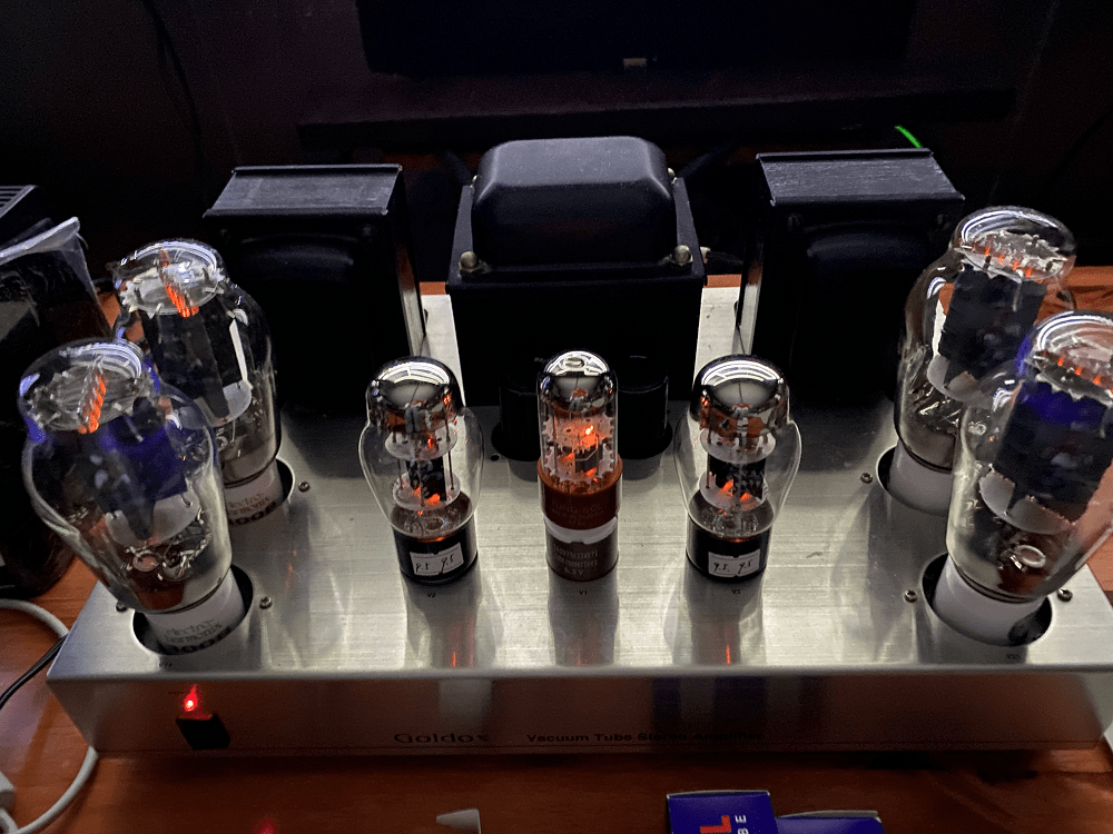

There is a hum problem. However, I am not sure if the pcb design or the PT. I had to remove the 6.3v CT and use 2-100 ohm resistors to remove the hum. Otherwise, 300B, 6sn7, and 12ax7 all use AC filament heater. No hum after using resistors. Earth ground gives hum as well if connect to Ground but good if screw it to chassis near by.
Good luck anyone decides to to build this amp.

2 identical Goldox amps landed on my bench. They are the KT88/EL34 variants but the PCBs look the same.
I think you might get better performance replacing the first drop resistor with a choke and replacig the stacked filter caps for the 6sn7 driver with panasonic 500v square film caps, ditto the 12ax7 filter caps, that way it saves a lot of B+ bypassing with small valueand you get a more coherent tone.
Thanks jlw, I have seen exactly same schematic that has been used with KT88/EL34. I believe there is a company sell that amp in U.S. Did you modify anything else?
The chassis is too tight to put the choke in so I added another small RC (60r) in front to reduce AC ripple and rewired the PS where B+ is 389v now (was 340v from previous owner), I think he tried to fix the hum problem and convert to DC filament too but couldn't get rid of the hum). I changed everything back to AC filament, there is no more hum. l I replaced 22uF for 12ax7 where it was 100uF. The original PS was using Bridge for B+ and Half Wave for Driver so I rewired similar as the PS for KT88
The reason I reworked the PS is because the PT is 110vAC so I don't want to run with Variac, it 's little bit warm to run at 120vAC so I could get B+ at 389v and Grid Bias at -82v. So far it looks great on the scope where I estimate around 16w/channel. The mid is so good except the bass is not strong enough but it's alright. So far it has been working great. I did use adapter with 6SL7, it sounds better than 12ax7.
