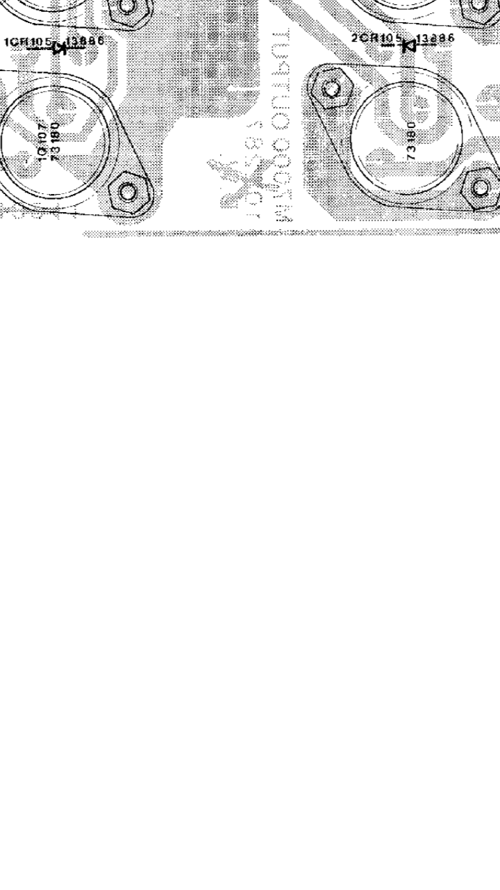

the dual diodes i may have put in the wrong place.Are both of these 13886 diodes actually on the heatsink in a loop like the 4003 ones are?I saw in another forum that the heatsink only has 1 dual diode there in a loop and the other is somewhere else .Before i mess with it again i wanted to know specific location or where they are .i,ll post a pic of where i put them.Maybe i got it wrong.I had them in the heatsink at the end across eachother but in series.Again thanks for yalls help.Im still not a veteran like yall.
Can i start by putting my four to3 drivers in and put just a pair of outputs for each channel to test?Will it work that way if i get the driver cards fixed,or does the cards need them all there to derive voltage from?
I installed the two double diodes as shown on the schematic phot😵rientation wise also .Was i wrong?

I had a diode in the bias string shorted to the 80v heatsink.I used wire casing to insulate but what happened was a strand in the casing made a short.
my fault.Thats why i had an 80v dc there .
Im still going to try and get it going.I have a 6534 and a couple items blown on the boards but im determined to fix it..
Enzo seems to be out traveling or whatever. He would know about the washers. My Peavey amps have drivers on different heat sinks from the outputs, so if the driver shorts to the heatsink it doesn't matter. The glass fiber pcb insulates the drivers from everything else. Look and see if that is the case with yours. The BOM has none but it is only for the driver board, and I think the drivers are on the output board for the X. Peavey tends to connect the collectors on TO3's to the pcb lands with the screws, and serrated washers on the nuts.
