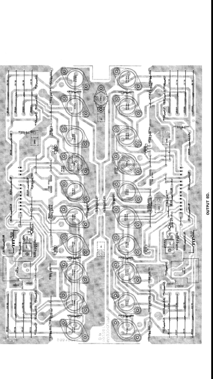

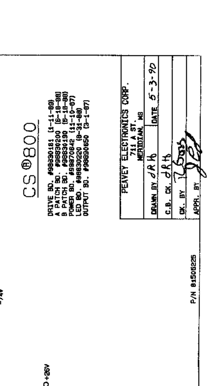

heres the wrong photo schematic ,photo of mine.I called Peavey,they confirmed its wrong.The photo doc is wrong ,nothing else.
Your photo you sent me is right. 70473180 pnp all together 70483180 npn all together.And the four drivers in the middle on the separated heatsink.Peavey tech said yours is right.

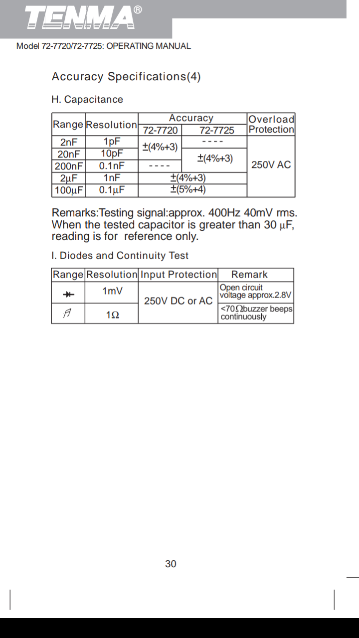

Yes, as I suspected. I asked you to check the LED which would show up as open too since they drop 1.6 v. But they burn green when you turn the power on.By the way im using a UniT UT33A i guess a fluke would push more volts in diode mode.Im using diode mode without beep .But tried both.It wont push more than 0.999 then goes OL.
My Craftsman 82144 DVM tries diodes at 2 v. Much more useful.

Okay today at the worksite I checked my $30 on closeout Tenma 72-7725 DVM. It measured 1.71 v on a yellow LED on diode scale. So it is correct. Also discontinued. https://www.newark.com/tenma/72-772...ErgAg==&ddkey=https:en-US/Element14_US/search

still working on the cs800x amp.Now the j174 is shorted on one channel and the other has a shorted diode ,it blew two resistors and a ceramic cap.Right under the header pin connector.The flex cable header pin.Its one of the two big diodes on driver board.
The issues stated are on the driver boards .My outputs are good.Outputs arent shorted or getting hot.The 15v regs on the driver boards are good.

- Need schematic for cs800 but not s or x. Looks like the x one.
