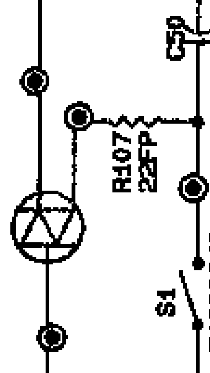

one question also.Anyone know fore sure of this gate resistor?Mine blew when the turn on triac went bad.Is it 22 ohm or 220 ohm?22 ohm seems low .But hey im not sure.Since it doesnt show a multiplier after 22 does that always mean its just 22 ohm?I know its a flame proof resistor.Thanks for all the help.I may need more.

There is no parts breakout for the patch board with the triac on it. However, in 1995 peavey wasn't using 3 digit resistor codes. For example on driver board R119 is shown as 68-1/4W. I would say that means 68 ohms. So 22 probably means twenty-two ohms. I can't look at mine, I have a CS800s and the power supply is totally different. It is a switcher instead of having a transformer.

Of course it is 22 ohms. FP for flame proof. WHy is 22 "too small"? It merely limits the gate a little. Look at the other resistors, in the fan circuit for example. 400 ohm, 100 ohm, 2.2k. I think they make it pretty clear.

And i wasnt sure about the 22 being 22 ohm.Im still learning alot of this..I usually see an R afterwards.or a symbol.

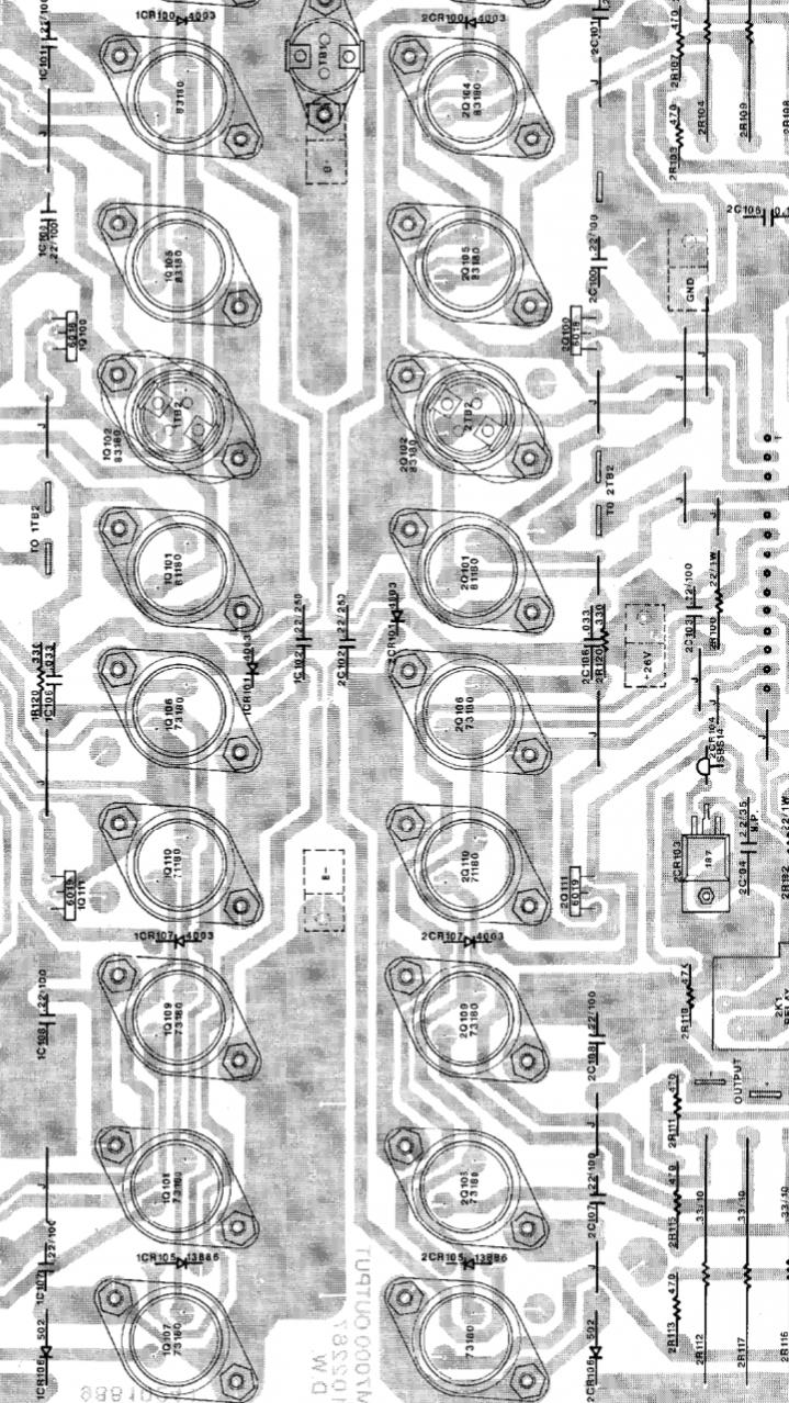

The pic of the layout is this correct layout of the driver transistors on the board?Seems odd that the 70473180 transistors are laid out then the two drivers then two more 73180's .Its different on the 70483180 transistor side ,theyre all together.
I just want to make sure .
I thought only the drivers were the four middle ones on the seperate heatsink.
That layout places two of my outputs on that middle heatsink that is seperate.Just want to know if that print layout is correct.Thanks .
I have drawing title CS800X #81505355 2/22/94
Yes, you found a typo on the layout. What version drawing do you have? Follow the schematic. The two sides are symmetrical and mirror image.
Enzo,oh ok.Dam i have them in there like that lol.Well ill put the drivers back like you said,the four in the middle and the 83180 on one side and the 73180 otherside all together ,symmetrical.And the drivers also have a mica insulator under them,correct?Outputs dont.
So it should be 83180 all 4 then 81180 then 71180 next to it then 73180 all four,then other side the same.Dam i sure wouldve smoked it.That seemed odd,im glad i asked.Does anyone have a correct pic of their transistor board or a correct drawing of the one i posted?
