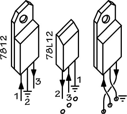

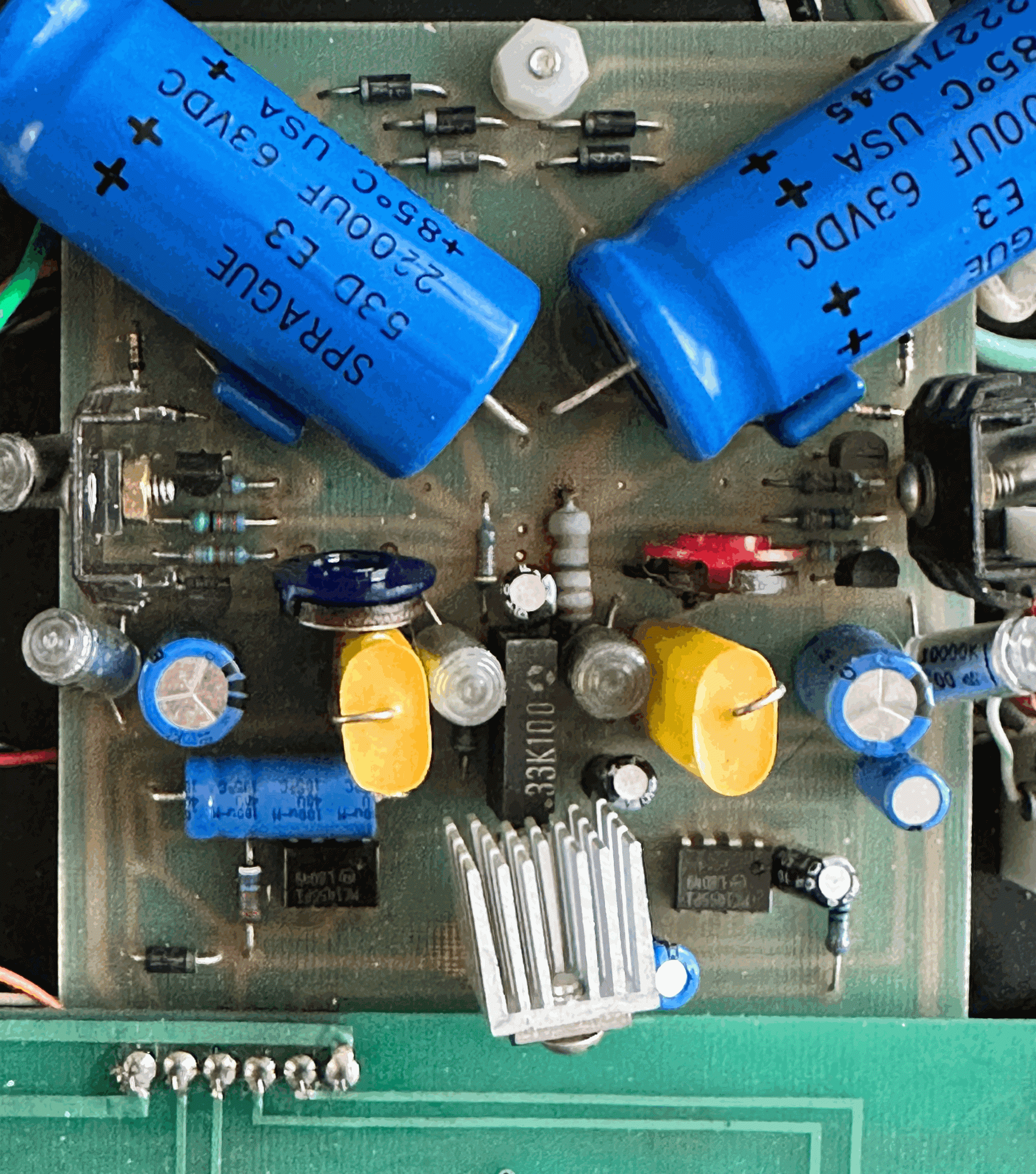

OK, a little more information, but still no success.
I replaced the wrongly installed 7812 regulator, matching in, out and ground to their original positions as shown on the circuit by moving the reg over by one hole and pulling the third leg of the reg around the others over to position one. Having replaced this twice now, that part of the board is getting pretty beat, and I had to use a fine wire to replace the needle-thin trace from the output end of the reg. I did verifiy with a VOM that the legs are correctly tied into the circuit per the diagram.
This did not fix the problem. Now, the LED doesn't blink or come on at all and I don't hear the relay chirping, so the timer circuit is not working.
Checking voltages, transformer is still delivering the nominal 27.5 vac on both halves. On the leg nearest the rectifiers, R11 reads 37.5vdc (and it's still getting pretty hot); the same point on R13 reads about 25vdc. Post-regulation rail voltages are as before: positive rail can be adjusted to 33.5v, negative one won't go above 25v. Voltages off the rectifier bridge are 37.5 vdc to ground for the positive rail, and just 25v for the negative rail which explains why I can't adjust that rail upward.
In diode testing mode, D1–5 all read close to 5.2v in the correct polarity.
I'm guessing the next thing to try is to replace the two errant 1N4004 diodes, since they're where the trouble seems to start. I have a bunch of 1N4007s here--assuming those will be OK in this application. However, this really doesn't explain why R11 is overheating (145 °F), or why the timing circuit isn't working--or does it, since it appears to be connected to both rails.
Happy to have any suggestions.

Randy,
More thoughts... what we are trying to do is narrow down what are causing the problems:
- First, the unit developing a significant hum, which started your quest
Then after replacing some parts
- the negative regulator output limited to 27V max instead of the specified 32V-33V
- relay timing circuit stuck and not unmuting the outputs
Correct?

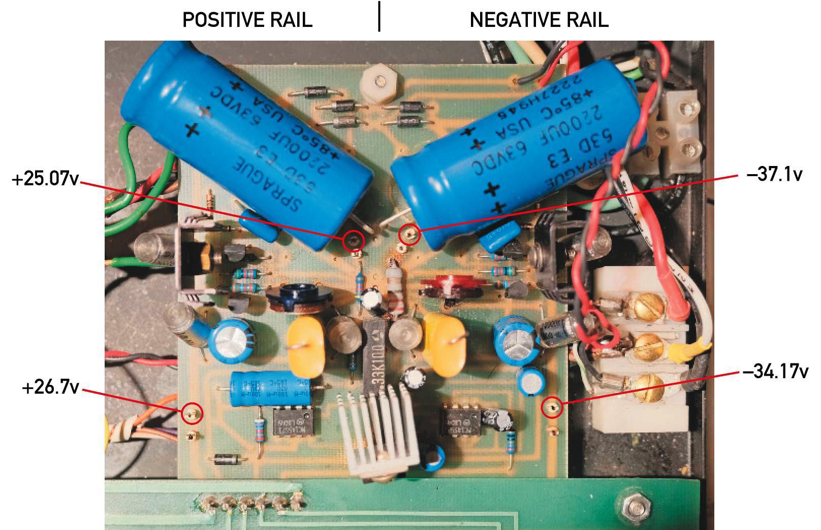

Before you started replacing parts, did you happen to measure the positive and negative regulator outputs to confirm they were both at 32V-33V? Nottaprob if you didn't, the circuit should get there as designed and implemented.
The circuit shown in post #59 is of the PS Audio Model Two-C Plus Power Amp. While the regulator circuit is similar, it runs at different voltages. The circuits in posts #60 and #63 are the ones that most closely match what you have. I know it confused things at first, but I think all have gotten past that now.
Back in post #56 you referred to the MJE172 and MJE182 as regulators, but they are just transistors. In this unit the regulators are the full circuit, the MPS8099 & MPS8599 are transistors that with their surrounding components drive the MJE172 & MJE182 as pass transistors in the respective positive and negative regulator circuits. This is called a discrete regulator, distinct from the 78L12 which is a monolithic regulator that has a small circuit built into it.
I just took a few minutes and fired up the unit I have here with the regulator circuit board I posted a picture of in post #76. With +-37.5VDC input it outputs +-33VDC with no issues and both rails get up to roughly 36V easily. So it will be a good reference unit to use to troubleshoot yours.

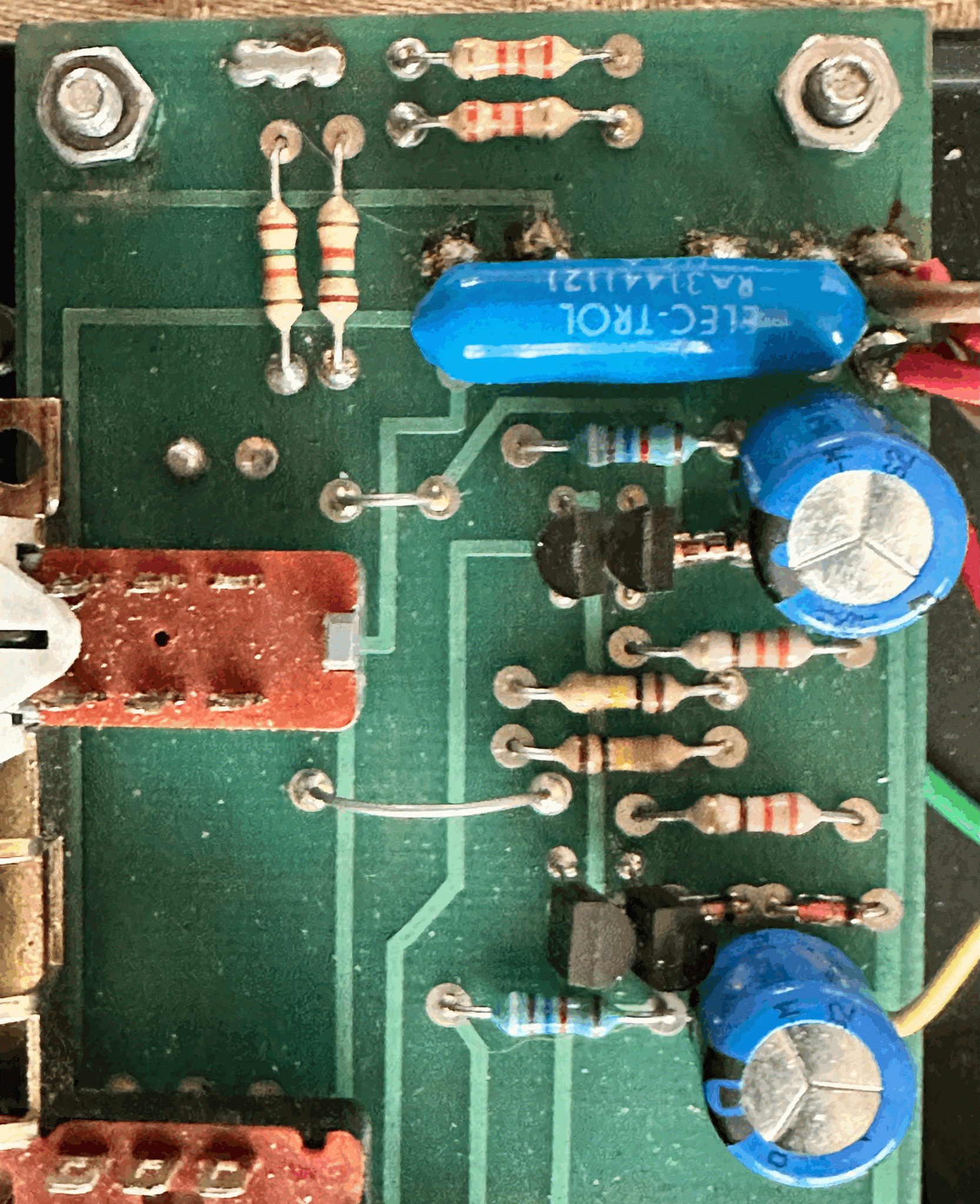

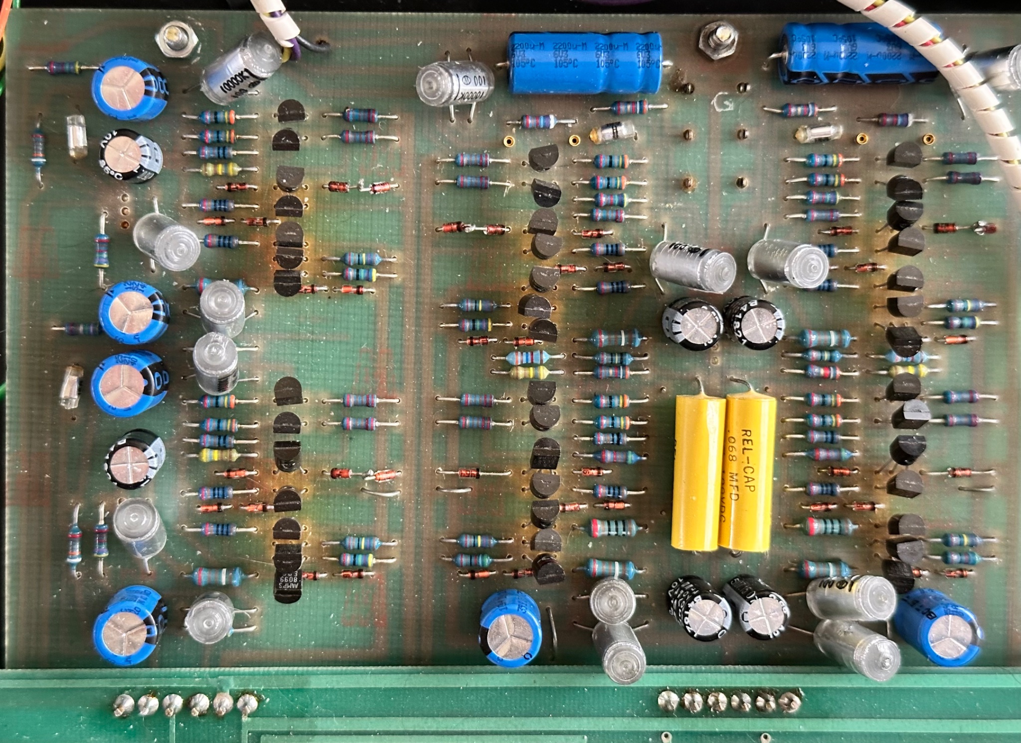

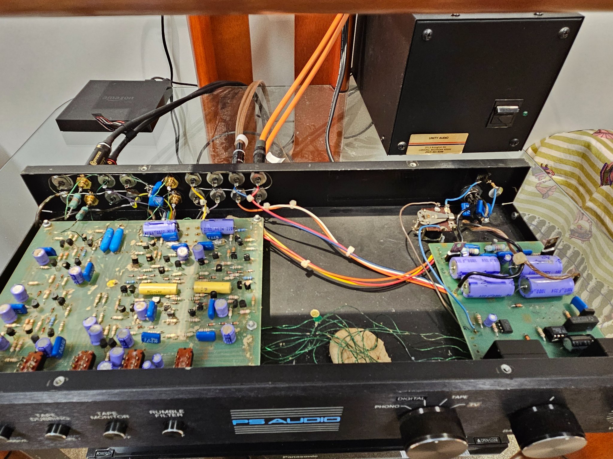

Thanks, Greg and Doug, here's some info and photos. Really appreciate your help.
On Apr 28, 2025, at 7:54 AM, Randall Mosher wrote:
Power switch when in the "on" position connects the inboard side of R11 to pin 1 of the timer ICs. This means the schematic shows the switch in the "on" position.
Relay has four pins on either side (L+R), which appear to be, from front of unit to back:
1: chassis ground
2: fifth pin from right on connections from PS board to long board across front of unit, same as + connection to LED (output of timer circuit?)
3: preamp output, presumably connected to signal from preamp board
4: connected to output jack
As for the solder wick, I'm using MG Superwick #425 fine braid and a flux pen.
- 1st, confirm whether the power switch connects the negative rail to R11 (220R) resistor when turned on... or when turned off. Again, I am assuming when on, but can't tell for sure based on the schematic. Knowing this will help us understand how the relay timing circuit works.
Connects to ground for sure, so yes, since C7 & C8 are right there.Confirm that the 78L12 pad at #1 connects to the junction of C7 & C8.
Confirm that the 78L12 pad at #2 connects to R14 and both NE555P pins 8.
Yes to both. My assumption is that pin 3 is the input since it's closest to the + power. Correct, or do I have 2 and 3 backwards?AND confirm that the 78L12 pad at #3 connects to C9 R12 and C11_
Mute does not appear to short outputs to ground. No continuity from signal output jacks to either star ground or ground of RCA jack when power off. Appears to just disconnect signals from output jacks.- 3rd, confirm that the outputs are muted (shorted to ground) when the power is off. Again I assume that is true, that is how every mute circuit I am aware of works, but best to confirm.
1: chassis ground
Randy,
Thanks for the information. This helps understand what's going on in the circuit.
The next thing is to resolve the negative regulator issue. Why? We don't know if it is caused by:
- replacing caps or transistors in the regulator circuit
- replacing caps in the main circuit
- replacing caps or the 78L12 in the relay timing circuit
- or something else.
The only way to effectively troubleshoot it is to isolate the regulator circuit from the main and relay timing circuits. AND if both the positive and negative regulators work ok in that configuration, you can selectively reconnect the main and relay timing circuits separately to ID or eliminate each as the cause of the negative regulator issue.
One way to do this with less damage to the delicate component pads is to find an area in connecting traces at least 1/2" away from any pads where you can cut the trace with an X-Acto, other hobby, or sharp utility knife. It only takes a single cut in most cases to sever the connection, though it usually takes some cutting into the substrate to ensure the trace is fully cut. Of course check for continuity across the cut to confirm. Then you can reconnect it with a solder bridge... or solder cut-off component leads across the cut. Though not usually done when professionally repairing a unit, I have found this very helpful in working on my own gear.
Use this method or any other to isolate the regulators from the main and relay timing circuits. Then report back on whether both the negative and positive can be adjusted to spec.
On identifying the proper way to install the replacement 78L12 regulator, we really need the voltages at the regulator pads AFTER the regulators are both working to spec AND without the regulator chip in circuit. Since they are almost a dime a dozen, I suggest cutting the leads of the 78L12 you have installed as close as you can to the body of the regulator (and discarding it). Then you can measure there without disturbing the board pads and traces. If it helps, you can solder short pieces (3"-6") of insulated wire to the remaining lead ends and measure from the other ends of those. AND in trying a replacement regulator once the main regulator circuits are workin to spec AND we understand more about the relay timing circuit, you can solder a replacement 78L12 to the end of those leads (as long as they are no longer than roughly 6") and we can try different orientations (if needed) without further endangering the traces and pads.
BUT 1st let us know how the regulator circuits behave when isolated from the main and relay timing circuits.

Having (again) compared the photos I took before the re-cap against the actual unit, I can confirm that all the electrolytic capacitors are in their correct orientations. The transistors in the main regulation circuit are number-for-number replacements installed in their correct orientations.
I will first detach the timer circuit and see what difference that makes, using the trace-cut method you described (and I was thinking of as well). If the main reg then outputs the correct voltage on the negative rail, then the problem is likely to be the timer circuit. It does seem odd to me that it's the negative side of main the power supply that I can't get up to proper voltage, yet this the one connected to the timer circuit via a high resistance value (6.8k) from the diode bridge on the PS board, so is unlikely to be drawing excess current. It's the positive 220r resistor on the + side that's excessively warm.
If I need to remove/replace the 7812, I have some tiny silver-plated forked terminal posts I can solder in from below, so I can replace the reg chip from above with no further damage to the board.
I would love to know if I have that regular chip installed in the correct manner. Based on the schematic, can you or anyone identify the in and out leads and if I have them labeled correctly in both the 78L12 and 7812 drawings (as installed) attached to my last post. This would have been easier If I could have found a datashgeet for the old version in that oddball chip package and pinout. I can't even figure out the case type number.
Will report back when I have a chance to cut some traces and measure.
