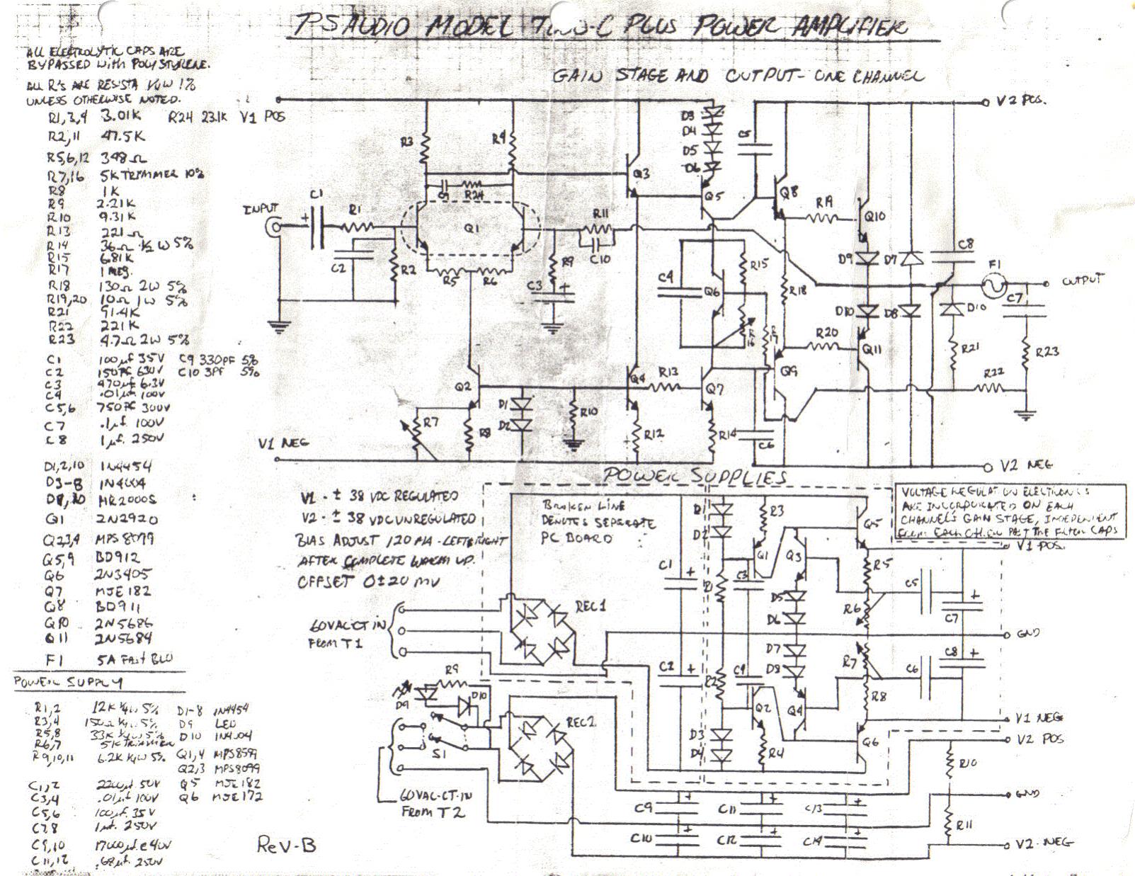

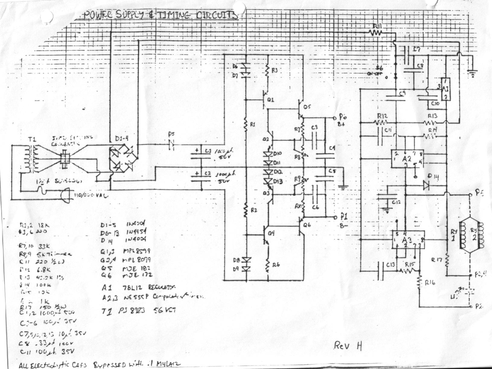

I still have the preamp, actually I have 2 of them. The hand drawn schematic not the service manual I had (that I got from Greg) almost a decade ago, was on my pc that developed a major case of bohemian hemorrhoids died few years ago. I lost everything on the pc.
Have not used the pre amps in many years!.

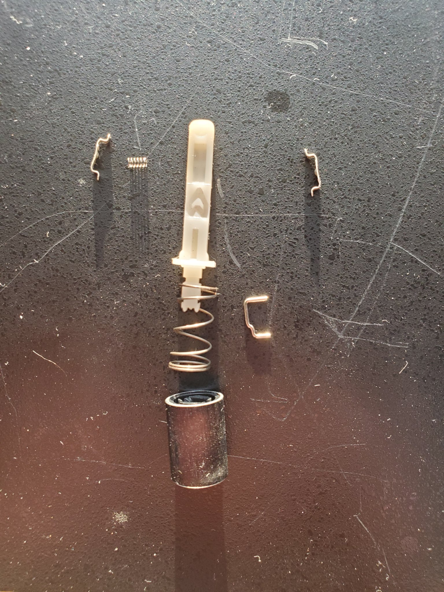

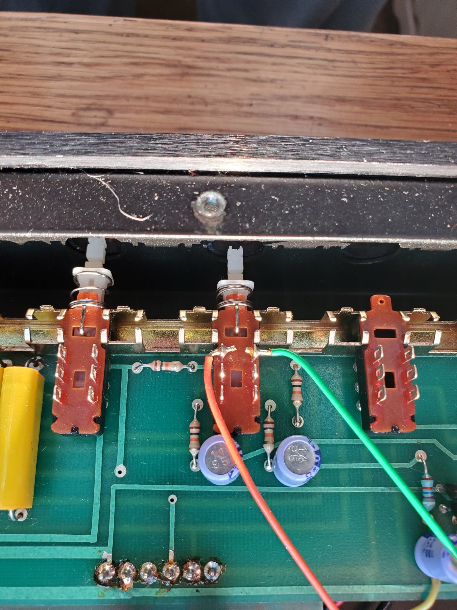

Crappy picture I will take some tomorrow,
Inside they have a u shape bend plates with springs behind them, by the design I wonder if my various contact issue is even Oxy related.
That be awesome, are there any good upgrades beside maybe adding 2-Wima for the filter caps?

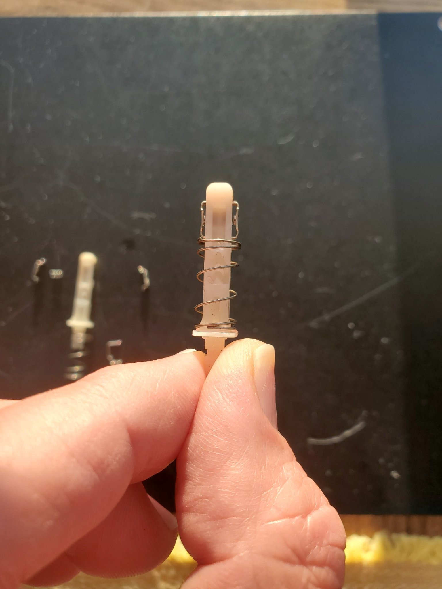

Greg,
Here you go, the more I review this design the more I wonder if the issue with these switches is rather bad springs than Ox.
See if this helps to identify
These are a pain to put together, you can see on the one picture where the spring on the right is missing.
One picture assembl.

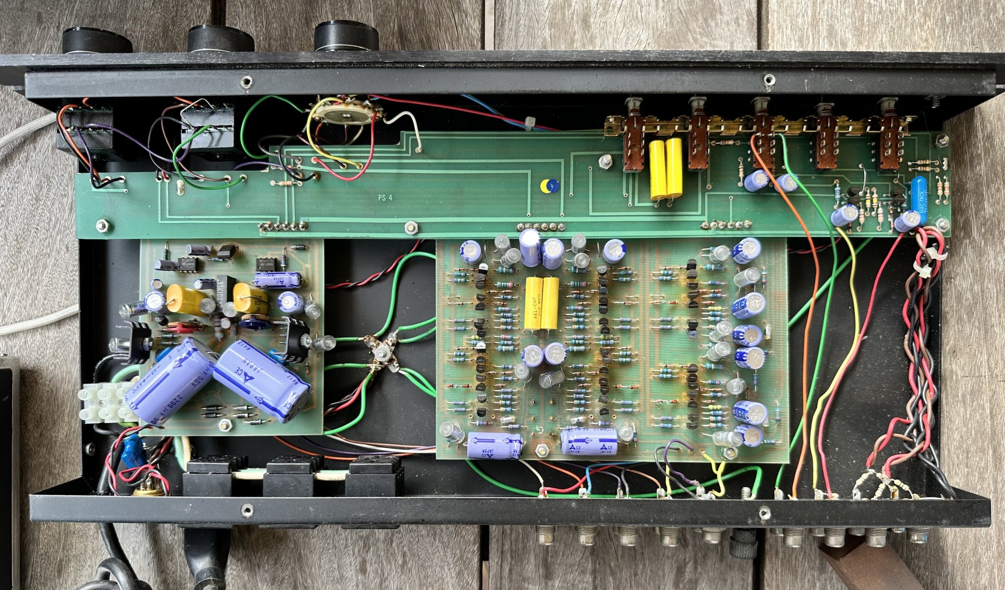

Hi all, I've been using one of these for years. When I bought it on eBay, the phono section had some hum, so I've been using another phono preamp. The pre otherwise has been working fine apart from a scratchy volume pot, but this week suddenly developed a significant hum.
I was thinking I would just gut the thing and install a different preamp board, perhaps Wayne's BA line amp. But then I opened it up and realized that it would be quite a lot of work if I wanted to maintain the same function for all the knobs and switches. I don't have any sentimental attachment to it, but it is a very well constructed piece of kit, and honestly it might be just as easy to fix it as gut it, and that would also preserve its value.
So, the question is, what parts should I replace that are most likely to fix the hum problem on both phono and line pre? I assume all the electrolytics would be prime targets. Anyone think this alone will fix the issues? Anything else likely contributing to the problem? As you can tell from the photo, it's in pristine condition, and the ground connections are tight. Once I get the board out, I'll check for cold solder joints. Also, I haven't found a rebuild kit anywhere--is there one or even a BOM?
Looks like the best way to get to the bottom of the board is to unbolt all connections and controls and just lift everything out. Not too bad, just a bunch of nut driver work.
Thoughts on how to proceed?

OK, I've replaced all the electrolytics. Circuit boards get pretty scary after 40 years, but I only had a couple of lifted/torn pads, which I was able to fix.
Someone mentioned the switches a few posts back. I noticed the power switch wasn't working, and when I looked at it, the nylon thing in the center had cracked in half right at the zigzag channel where the wire travels. Uh-oh. Miracle of miracles, I had an almost exactly compatible Alps switch in my parts bin that fit perfectly after I widened and deepened the metal channel that holds the switches in place.
It's all back together and there seems to be a voltage issue, so I'm looking for suggestions. This unit seems to have a separate power supply that monitors the B voltage and flashes the LED if insufficient. The unit turns on as normal, LED flashes for a few seconds and stabilizes, then it starts flashing again, indicating low/no voltage.
I should say that I replaced the original 78L12 regulator in the power supply for the LED flasher circuit, as it clearly had been overheating, with a little heat damage to the board. I used a 7812C chip in a TO-220 case and stuck a small heat sink on it, thinking that would be a drop-in replacement. There seems to be a whole power supply circuit for this LED flasher thing, fed from the transformer according to the circuit diagram.
There are six pins on the PS board that connect it to the wide distribution board that connects to everything else in the unit. Let's just call them pins 1–6, from left to right, reading from the front of the unit. I get different voltages when the LED is stable than when it is flashing. Between pins 1 and 2, I get 45.3 and 37.7 respectively, with pin 1 being positive. Between pins 5 and 6, it's lower: 28.7 and 24.9, with pin 6 being negative. The MJE172 regulator on the right side is running a few degrees warmer than the MJE182, just a few degrees above ambient. Transformer is showing ~26.7VAC on both halves, so I don't think there's a problem with that.
I've tried turning the trimmer resistor on the right side in the main power supply circuit counterclockwise, but I cannot get the voltage up over 29v.
Anybody care to diagnose? The only thing I can think of is replace the MJ172 regulator. Appreciate any help!

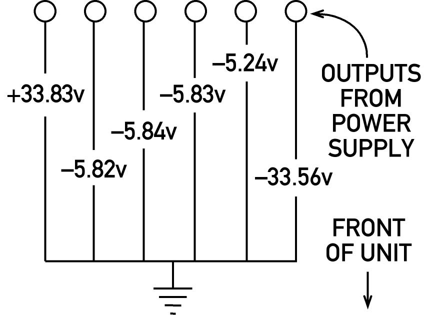

After tightening up a loose ground connection, the current status is this: the LED alternates between solid status and flashing every few seconds. I'm including a little diagram of the voltages to ground from the six pins adjacent to the PS board on the narrow strip that runs along the front of the case. As you can see + and – are both at a little over 33v—a bit short of the 38vdc the circuit diagram says they should be. I can adjust the trimmers lower, but I can't get the voltage much above 34v.
The four pins between the right- and left-hand ones all measure around 5v, which is a little confusing to me.
Any advice or thoughts would be most welcome.
