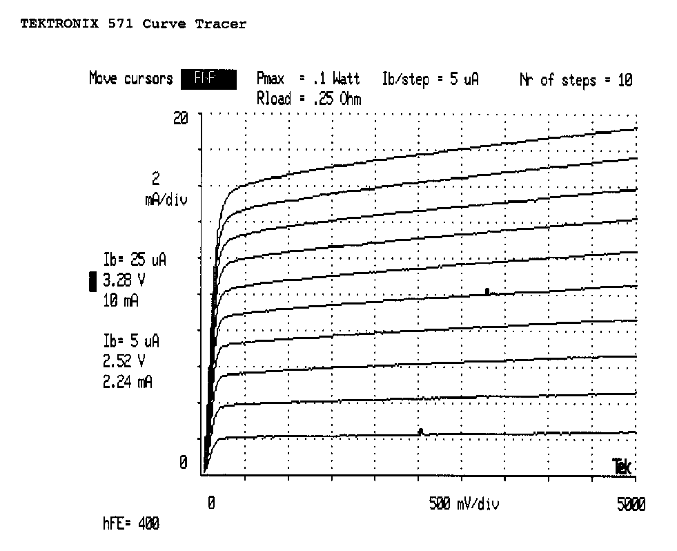

They aren't all that wonderful either. Locky-Z curve tracer plots attached. | Ice | on Y-axis, units = milliamps. | Vce | on X-axis, units = volts
