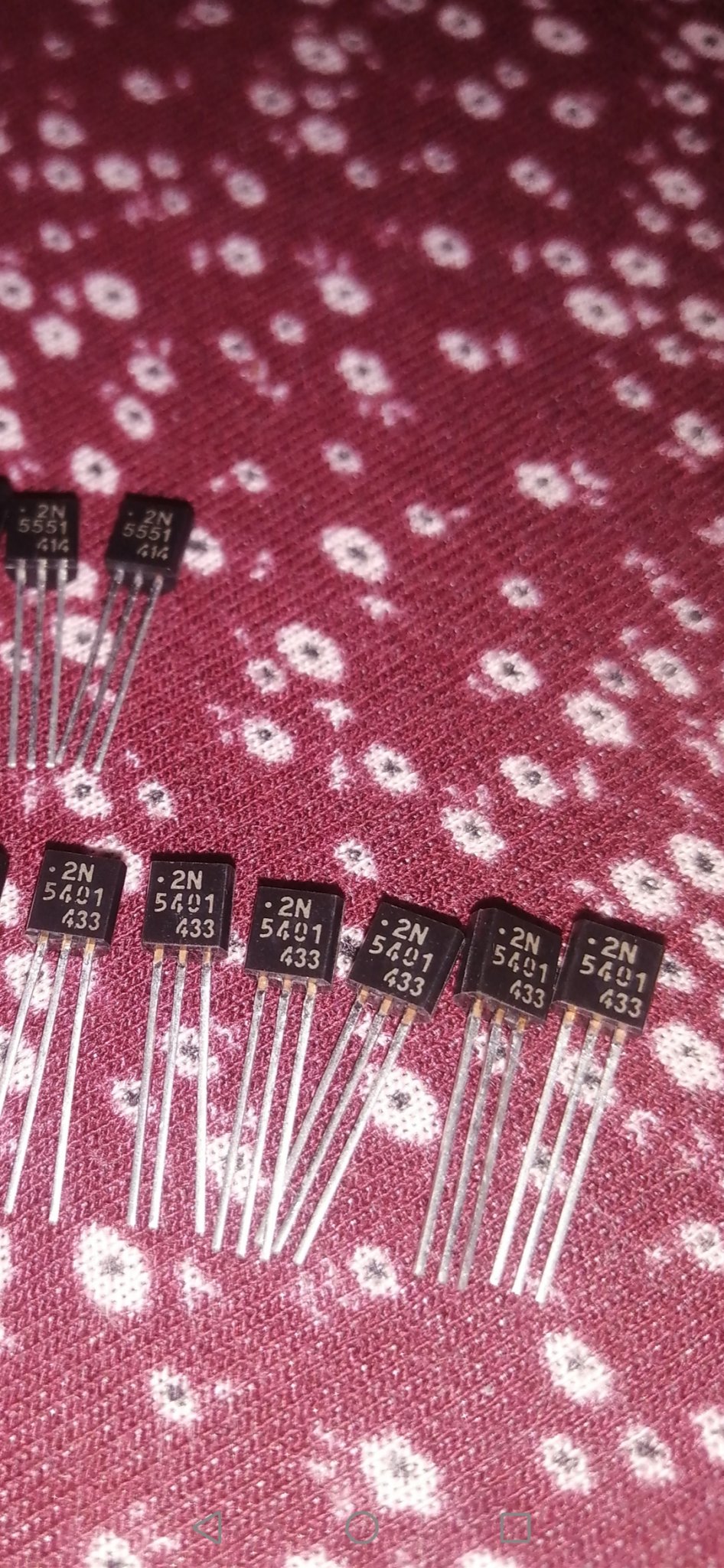

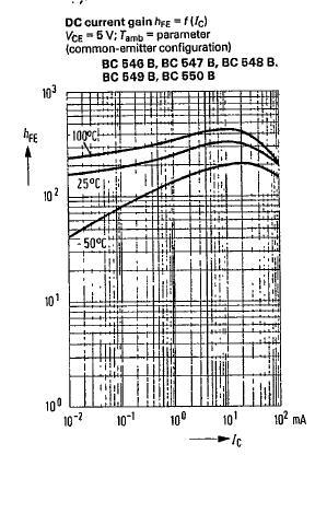

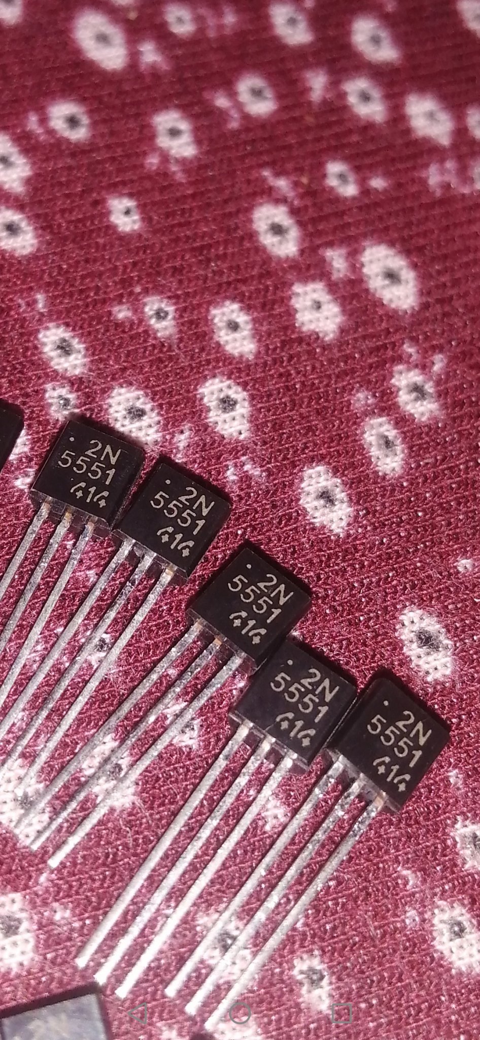

Bc546/550c
thanks AndrewT and peufeu
HFE for BC546/550 with "c" suffix seems high and capacitance seems low. However, for HFE linearity I am not sure. See attached extract of datasheet or Am I missing something here?
2N5551 has a more stable HFE curve function of IC for the range from let say 0.3 to 10 ma I think...
Hi Fab,
which manufacturer's data did you post?
Most of the curves I have are nearly ruler flat. Only Fairchild 556 showed a significant slope (100 to 190) but not as bad as that one.
It would be worth checking on individual Qs, if absolute linearity is critical to circuit performance.

thanks lineup!
This makes a lot of sense. Finally, 2N5401/5551 is not so bad after all... .Baed on Philips and On semi, the linearity is better than about 7% from 0.3 to 15 ma. The curve are different between the 2 manufacturers.
Hi AndrewT
The datasheet manufacturer is Siemens. Ihave checked another one from Motorola and it is the same curve.
Hi AndrewT
thanks lineup!
Hi AndrewT
