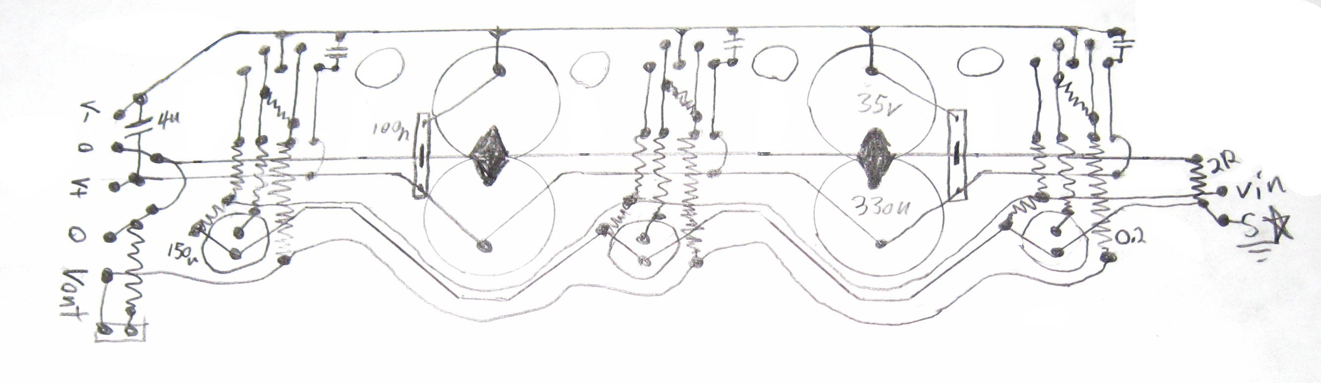

Well, I sketched a compact horizontal layout, but I don't like it since small signal has to jump over v+. After finishing the sketch, it was apparent that the 470uF 50v were just too big so I labeled them 330uF 35v, which is a more sensible size for the board, and the textbook value as well, but I didn't redraw, since there must be a significant amount of room between caps and heatsinks.
*The mysterious circles with no connection are holes for air--to help the caps last.
*For this power circuit, it appears that the sketch is too wide.
*The tiny little caps between V+ to V- directly at each chip are very tiny value ceramic or polyester, about 3.3nF. And at the far left edge, the solo 4uF 250v shown blocks a lot of noise.
The sketch doesn't quite show correct things to do with traces, since some of them are too close and some are wrong thickness. For the appropriate length jump over appropriate size traces, most resistors at the jumper area would have tiny pads and possibly enough room for a 1w resistor, with the speaker output having room for a 5w resistor.
It isn't without benefits. It shows the speaker as a power component, separated far away from small signal input and it gives signal star ground. There is a heck of a lot of room to put in whatever filters you want. It allows flyback diodes added at farthest left to support "alternative" chips not exploding while driving huge woofers. And the compact PCB size is inexpensive.
I will attempt to do better next time:
Please check validity before using.

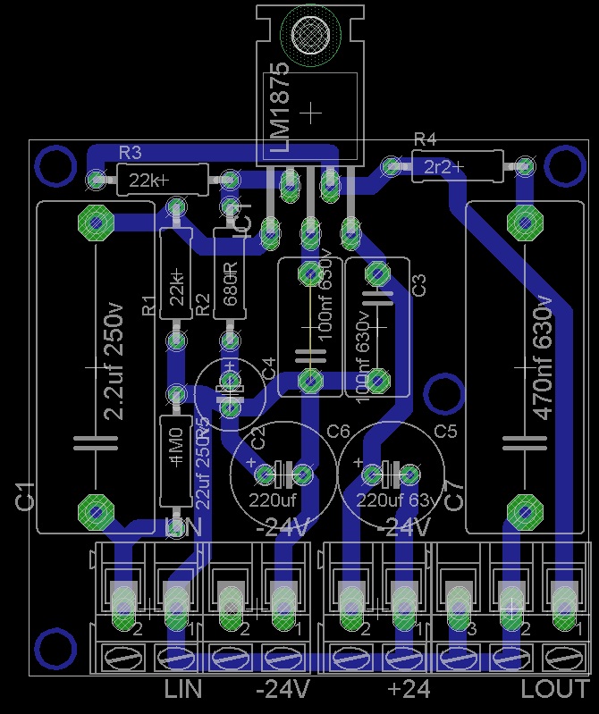

I've amended the layout again based on the components available to me. I managed to get far smaller capacitors (100nf and 470nf) which are rated for 100v which will be sufficient.
I'd appreciate feedback please

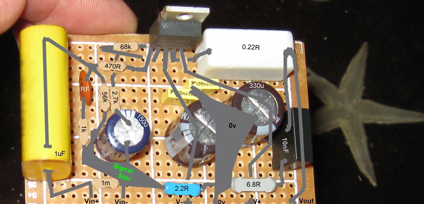

Well, I took your layout and just did this to it:
Star grounding avoids hard forward sound of slamming speaker return current into NFB cap. Notice the absence of suggesting speaker return to amplifier board, although the 0v tap may be used for speaker return.
A pair of 330uF 35 power caps are textbook spec for LM1875--its only the china counterfeit chips that need 220uF 25v and lower voltage (as if TDA2030).
The input cap now has alternative size pads for signal grade electrolytic, most of which are excellent in smaller sizes. But just in case somebody spends a lot more for a lot less quality, RF filtering helps prevent mistakenly large input caps from acting as noise collecting antennas.
The 2.7k can be changed to 3.3k for a normal gain setting, but otherwise the resistor values shown add some support for generic chips.
This board is much too heavy to be supported entirely by the little chip, and so we should probably consider a compact board that's not as full as this. For an LM1875, this board is huge!!
I've included a starfish in the photo to make a point--star grounding.
here is the next incarnation based on the original components.
once i understand the additional resistors and cap i'll map out a PCB for you.
i interpret this by sharing the same ground with other components to stop the slamming :)
i did - and i find this interesting. the speaker has to have (with the exception in the case of the triple setup) a return. what i find truly interesting is the seperation of the 0v ground and the line input ground - why?
yep cool with that - although i'd love to actually understand how these are sized for the application (i lack the theoretical context of electronics, apologies)
added the additional pad - cool idea. a signal grade electrolytic - this i find EXTREMELY interesting - i have a similar input cap to yours on your little perfboard :) - but are you suggest a nomal radial polar cap could go here??
what is considered 'normal' gain? i pulled the gain back to 21 not to overly stress the device, it was by the default values at 31. yes the resistor values can support the TDA2050 and other series
the board as shown above is just shy of 2 inch squared.
i didn't quite understand star grounding. i do now. i'll carry this over to my valve designs as well as they stipulate it in their point to point wiring configs.
many thanks and appreciation for your help :)
R1 is in the wrong position.
Remove it. C8 connects from Signal Hot to Signal Return.
Add R1 in series with C1, but before the tapping for C8.
I note you have labeled the Signal Return Differently from the Main Audio Ground. Well done.
Add a pair of inverse parallel diodes across R8. The diode passes Fault Current to blow a Fuse if faulty equipment is connected to your input RCA.
I think R10 (0r22) is going to be too high. BTW, never omit the leading zero in values less than unity.
The combination R2 & C2 is unusually high with RC ~400ms. This will not do any harm. But some adjustment may give lower noise and/or smaller/cheaper components
