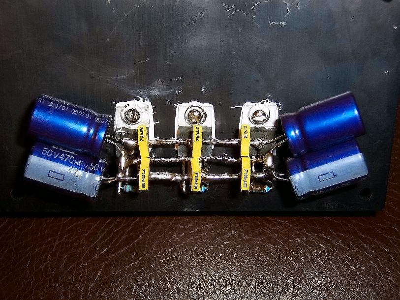

But I'm onto working on the amp, and point-to-point has proved challenging. I can't figure out how to make the power rails even/same length and don't know if that is even necessary. If a straight bus is run across three chips, the center chip will have the highest exposure to the power supply cable. Is that a concern?
Amplifier photo, regular parallel stretched out to make triple parallel
Here's what I came up with for power circuit. I just stretched the Parallel LM1875 out to make room for triple parallel. It is still tiny.
Does it really need 6 of radio grade 100nF?
Will this arrangement do for power circuit? Suggestions?

From the photo of post #28, the 100nF//100nF//100nf section looks like a clumsy generic guess gracelessly scaled up three times. Isn't the center extraneous? From here, what it looks like I should do is 100nF between each chip (100nF//100nF per rail). What do you think is best? Isn't there anything more graceful than painting it over with a crowd of 100nF caps? That doesn't look either optimal or specific. Is 100nF always the correct value, no matter how many there are? Help?
Thank you!
Are you asking about the power supply bypass caps, at the chips?
See the section on "Power Supply Bypassing", here:
Analog Devices : Analog Dialogue : PCB Layout
From that, it looks like the bypassing should go from power pins to LOAD GROUNDS; i.e. load ground should be connected right at the bypass caps' connection to the ground plane.
But notice that the classic "alternate connection" topology, from rail to rail, sounds like it might improve distortion performance, at the cost of higher-voltage caps.
As you can see from the link, you might want to use multiple values of caps, in parallel, maybe especially if high-speed (fast-changing) energy will be present. Maybe you could think fast audio edge (rise/fall) times for that (and scale up the cap values), but RF and other high-frequency junk will also be present, basically always. On another note, I don't know offhand if it might also be beneficial to use multiple larger-value caps in parallel, to better-cover bass/mid/treble audio frequencies. If in doubt, or since I know that you like to experiment, you could try .01, 0.1, 1, 10, 100, 1000, just for example, or maybe the classic 1-2-5 sequence "translated" for this purpose: 0.1, 0.22, 0.47, 1, 2.2, 4.7, 10, 22, 47, 100, 220, 470, 1000. Yeah, that looks like overkill, heheh. But then again I've never TRIED it. I guess I'd at least consider adding one or two more cap values, between your 0.1 and 470, just to see if your golden ears can detect a difference.
After all, the main "signal path" is the CURRENT that goes from power supply through chipamp then speakers. And I sometimes think of the bypass caps as a point-of-load power supply that has to supply at least the transients for that current, assuming we don't want the supply rails' and grounds' conductors' inductances to cause voltage disturbances when we try to instantaneously allow current to flow through them (and/or just not have the current be available precisely when demanded, as the chipamp opens and closes the "valves" between rails and ground). And if the transients are not available precisely when needed, then phasing and time-alignment might vary with frequency, which might mean the difference between good and exquisite. But that's all just guesswork, at this point.
At any rate, the point I was going to make was that the problem that you usually should watch out for, when choosing multiple bypass cap values (especially the small values), is that certain cap values might form a resonant LC circuit with the inductance of the supply rail (or ground) conductors (and whatever else contributes to the lumped inductance they see), at a frequency that can get excited by something that might happen to come along (fast edges, RF, switching spikes, etc), and tend to cause ringing or maybe even oscillation. It's a minor point, but sometimes it can bite you. I guess maybe you could apply fast-edged square waves and look for tendencies toward trouble, with a scope.

I consider this an important fact that many have either forgotten or never researched to become aware of.I sometimes think of the bypass caps as a point-of-load power supply that has to supply at least the transients for that current,
The FAST output is supplied by the tiny bypass caps if they are fitted in the correct location to provide almost instantaneous current.
The Medium spead output is supplied by the decoupling, again located so that they can meet medium speed demand.
The Slow output is supplied by the smoothing capacitors. Because these signal are slow changing, then the smoothing can be remotely located from the output devices.
Yes, that pile of yellow radio grade caps is certainly capable of making a powerful disturbance in their passband. If that wasn't the purpose, then the amp and its schematic needs repaired to a more user-friendly arrangement.Are you asking about the power supply bypass caps, at the chips?. . . At any rate, the point I was going to make was that the problem that you usually should watch out for, when choosing multiple bypass cap values (especially the small values), is that certain cap values might form a resonant LC circuit with the inductance of the supply rail (or ground) conductors (and whatever else contributes to the lumped inductance they see), at a frequency that can get excited by something that might happen to come along (fast edges, RF, switching spikes, etc), and tend to cause ringing or maybe even oscillation. It's a minor point, but sometimes it can bite you. I guess maybe you could apply fast-edged square waves and look for tendencies toward trouble, with a scope.
And that's what I'm asking about.
An interesting difference for rail to rail is that its not hard wired to the speaker return's powerful broadcast. So, rail to rail maybe really good for pre drive?. . . But notice that the classic "alternate connection" topology, from rail to rail, sounds like it might improve distortion performance, at the cost of higher-voltage caps.. . . I guess I'd at least consider adding one or two more cap values, between your 0.1 and 470, just to see if your golden ears can detect a difference.. . .
I will add a single Cornell Dublier, "Mallory" SEK 105c 4.7uF 250v electrolytic, rail to rail at exactly the point where the power supply dc cable attaches to the amplifier. Thanks for the reminder!

Well, if you really want solid level signal grade, low impedance performance across the entire audio band for the power circuit directly at the chip, well that is extremely easy to do.
However, I'm completely confounded for power supply bypassing at pitches higher than the audio band. Shouldn't pitches higher than the audio band be met with a tiny RC filter on the power supply rails rather than flawless radio signal support????????? Or did you really want to support radio transmission with an audio amplifier? Most supply bypassing does seem to pretend that the audio amp is a radio transmitter. Is that the best way to go?
Well, just tell me what you want the caps to do and I'll find them without sending you to the botique or ham radio store. 🙂
That article and graph weren't specifically for an audio-frequency circuit. But in the case of high-frequency stuff, the bypass caps should pass it right on through to ground, BYPASSING the amplifier.
Cool. I have a missing value. It is approximately 22nF. It seems that I need to remove that center section of 100nF and trade for 22nF.
There is still an abrupt corner in the frequency as the 470uF HF failure mode rolls off gently and then slams into the brick wall of the 100nF high efficiency caps. If one did that with output caps the result sounds almost as good as a church bell in a tumble dryer. Hopefully the 4.7uF rail to rail cap can fill up that pothole and prevent the abrupt frequency corner (ringing).
More specifically: If it doesn't perform sufficiently, then a 0.5uF electrolytic can be placed on each rail. The HF failure mode of 220uF, 330uF and 470uF electrolytic will generally sum with the LF failure mode of a 0.5uF electrolytic, creating a flat response. Try 0.5uF electrolytic parallel with the big output caps of a bargain grade Via Tremor sound card and get a nice surprise.
