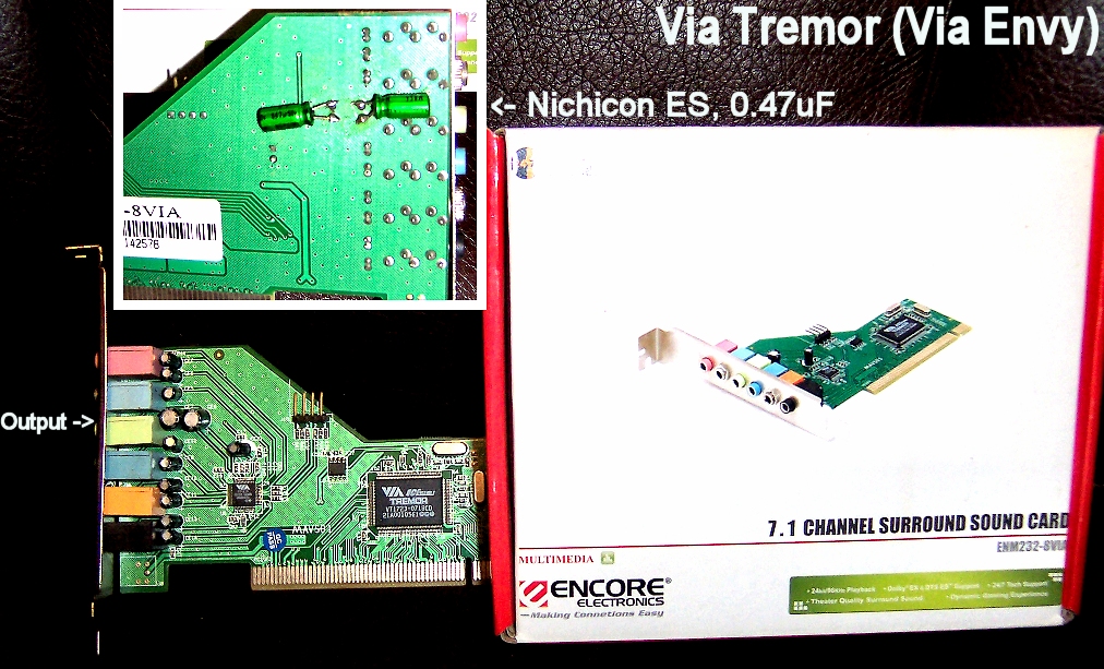

Step 2 for a useful source. . . a cost effective wonder
There are several options for Audiophile capacity from a computer, and this one is about $16. Skip to the photo (Via Tremor chip) if you're in a hurry.
You may not need to change your computer. Please check the computer with RightMark Audio Analyzer, RMAA, which is free.
The main problem:
Your onboard sound chip works as well as the motherboard power circuit allows and X-Fi fares no better, if when the main problem is noisy motherboard.
Here, when faced with power problems, the Via Envy/Tremor cards take the lead for clean playback, and this one is certainly cheaper than replacing both motherboard and power supply.
Pictured is the cheap version of an expensive success, M-Audio, and it plays almost as well as an M-Audio since Via Envy/Tremor are same design. The upgrade parts pictured are low impedance electrolytic of 0.47uF, put in parallel with the card's output caps to level the high frequency response almost perfectly, so don't even think about using polypro there. In the simple driver software, you can lock it onto 41.1k, which is native for music files and without the destruction of conversions. It can play 16, 24, and 36 bit, so there's no need to hinder MP3's by truncation, uprate, downrate or dithering. It can outperform some specialty DAC products, beating every last one that relies on conversions. Via Tremor/Envy plays at native rates, without added distortion.
After the quick and easy upgrade pictured, the card is successful with RMAA, Classical and cheesecore too. The demands are all different, but they all work clearly. The dynamic impact is prodigious and the chip lives up to its name.
I think that you deserve a well running computer with a spendy audiophile card in it; but, if that's not going to happen any time soon, here's the next best thing. . .

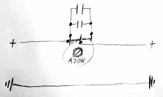

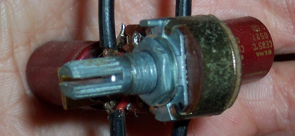

Step 3, a fore-aft balance control regardless of the number of speakers
For right-left, go see Rod Elliot's better balance control. For fore-aft, even if just one speaker (or more), try my "Impedance Thing" circuit in this post.
Pictured here is a way to alter the audible effects of impedance between source and amplifier.
This isn't active powered, doesn't block DC, doesn't shunt, isn't a volume control, doesn't cost very much and doesn't do very much. . . other than exactly what its supposed to do. Basically, it will fake the sound of an input transformer that you didn't have to buy, but still sound like you did. 🙂
Other members of "passive buffer" family include Lightspeed Attenuator, input transformer, and some specialty circuits. The audio effect is the same and adjusts the sound field aft, avoiding the "forwards" effect of solid state. Rather than a fixed effect, this one has a dial so that the choice is yours, as for how much. One position of the dial is conveniently Zero Effect (off). All effects should have an off/cancel position.
I'm sure that you will use it at a position close to zero (off), but not all the way to zero. How forwards do you like? That is certainly your choice, just dial it up (fore position is closest to zero-off). Got listening fatigue? No problem! Just dial it down (relaxed position is dialed slightly away from zero-off).
Operation:
You turn the dial until the soundfield recedes aft, and then you turn the dial back to reverse that until zero audible distortion. After several reiterations of this, you have successfully balanced the soundfield fore-aft. Try NOT to adjust it for easily audible effect. Barely audible is okay, but missing the point. The point is perfect fore-aft balance without audible distortion.
Since 3/4ths of the dial travel is useless, you'll want a large knob so that you can be selective for the 1/4 travel that does the intended job.
Parts:
An "A20k" dual gang potentiometer.
A large "Low Impedance Capacitor" in the range of 47uF~3300uF
A small "Low Loss Capacitor" in the range of 100nF~10uF
Other way to say it is "Low ESR"
Possible: 47uF//100nF
Possible: 3300uF//10uF
Anything that's big enough is fine as long as its clear--clarity is the main point, so interview a few likely candidates anywhere in that range. A small amount of experimentation is encouraged for this device. The ground cable follows closely but makes no electrical connection to the potentiometer. This isn't your volume control.
Hookup is in series between source and amp.
See construction examples pictured:
