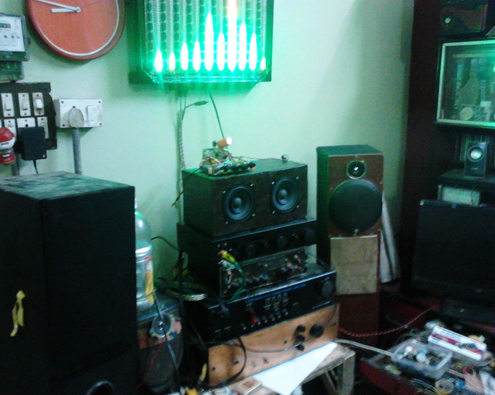

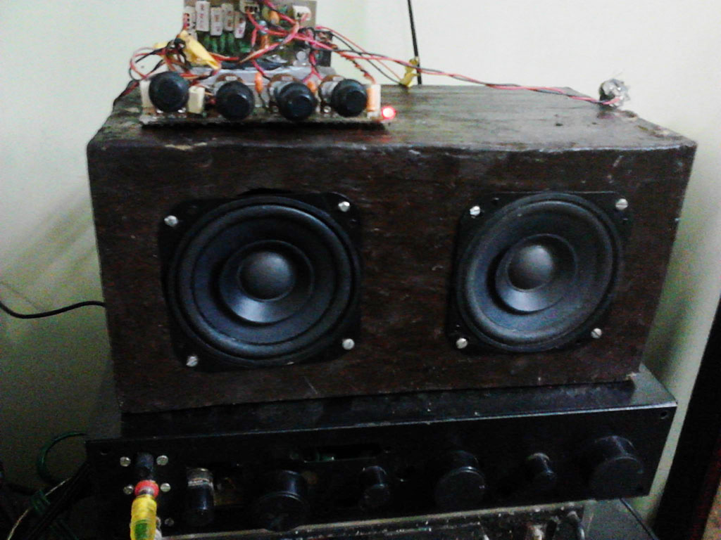

I made a sealed enclosure two "specs-not-available drivers" for the centre channel after obtaining the parameters with LIMP and it's working nicely.
I checked with the old trusted method mentioned/taught by cT equals piD and then compared the result with what I got with the help of software and web based tools. And both were identical and so I went forward with confidence and the result is satisfactory, I can say.
I also tuned my sub enclosures and now they are going deeper. 🙂
Thanks a ton really, to all of you!

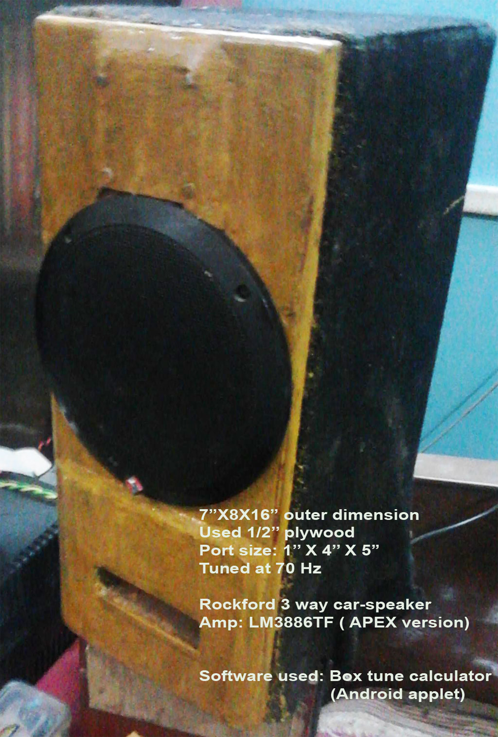

Just finished a ported box tuned at 70 Hz.
Polishing, retouching are yet to be done.
It sounds very good.
Tested with TrueRTA and other freebies.
With the help of PC, it's just a child's play now. 😀
I used Box tune calculator, an android applet, to build the enclosure.
Next plan is to build a T-line with cheap local full range speakers. 🙂
Thank you so much all again. 🙂
