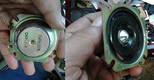

Putting a Q=0.853 driver into a sealed box will give a big "hump" in the LF frequency response. The high Q figure of 1 confirms this.
In a small room, or by placing the box near a boundary, you will get a very unnatural sound to male voice. Known as Bass Boom or "one note bass".
A Linkwitz transform could be used to sort this by reducing the effective Q to somewhere in the range 0.5 to 0.7
This high Q driver could be used in an open baffle, or in an infinite baffle. This would save all the effort in trying to design and build a sealed box.

Oh thank you so much Sir for your prompt and very informative reply.
I've been longing for long to build one using an open-baffle design.
Here I have some questions.
1. Is the size of the driver Okay even for a mini-open Baffle design?
2. What will be approximate baffle size and thickness for this specific driver?

Kindly have a look at my earlier posted parameters and I would be grateful if you could kindly suggest a specific and optimized design for me.
I have no other software except LIMP.
I assume the woofer to have a Sd of 110 cm^2 and a Qts around 0.9. Open baffle would work very well, but the maximum SPL of the speaker will be quite limited. Second option is a closed box of any convenient size and some equalization, exactly what AndrewT has been saying.

Update:

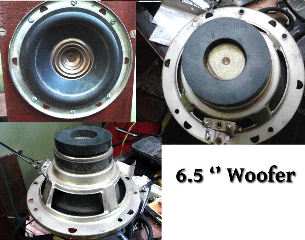

I also tried my best to measure effective cone size which is 12.2 cm.
With new procedure of calibration vas is reduced now!
Thiele-Small parameters:
Tested with pink noise:
Fs = 74.55 Hz
Re = 8.00 ohms[dc]
Le = 1238.74 uH
L2 = 2017.01 uH
R2 = 3.83 ohms
Qt = 0.83
Qes = 0.96
Qms = 6.04
Mms = 11.08 grams
Rms = 0.858869 kg/s
Cms = 0.000411 m/N
Vas = 7.89 liters
Sd= 116.90 cm^2
Bl = 6.579041 Tm
ETA = 0.33 %
Lp(2.83V/1m) = 87.26 dB
Added Mass Method:
Added mass = 10.00 grams
Diameter= 12.20 cm
Tested with Stepped Sine wave:
Fs = 72.51 Hz
Re = 8.00 ohms[dc]
Le = 1272.69 uH
L2 = 2303.91 uH
R2 = 3.55 ohms
Qt = 0.90
Qes = 1.06
Qms = 6.01
Mms = 10.81 grams
Rms = 0.819442 kg/s
Cms = 0.000446 m/N
Vas = 8.56 liters
Sd= 116.90 cm^2
Bl = 6.101374 Tm
ETA = 0.30 %
Lp(2.83V/1m) = 86.82 dB
Added Mass Method:
Diameter= 12.20 cm
