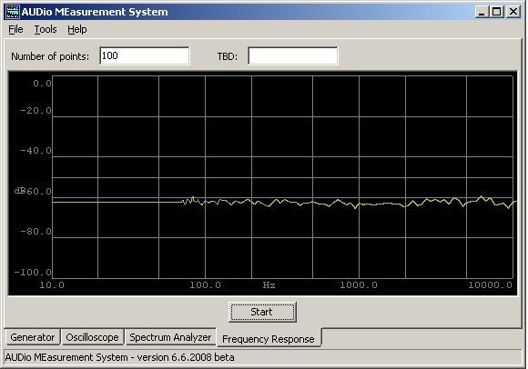

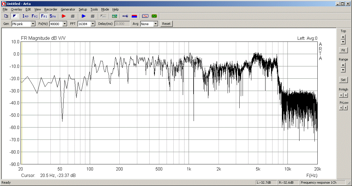

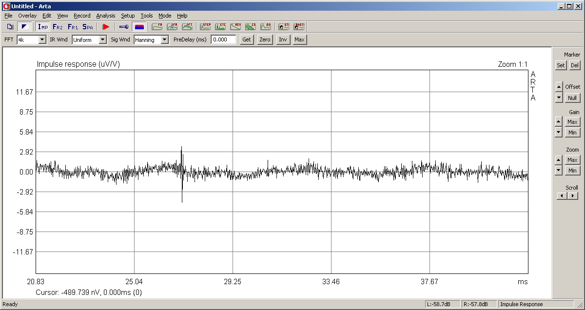

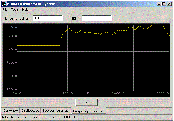

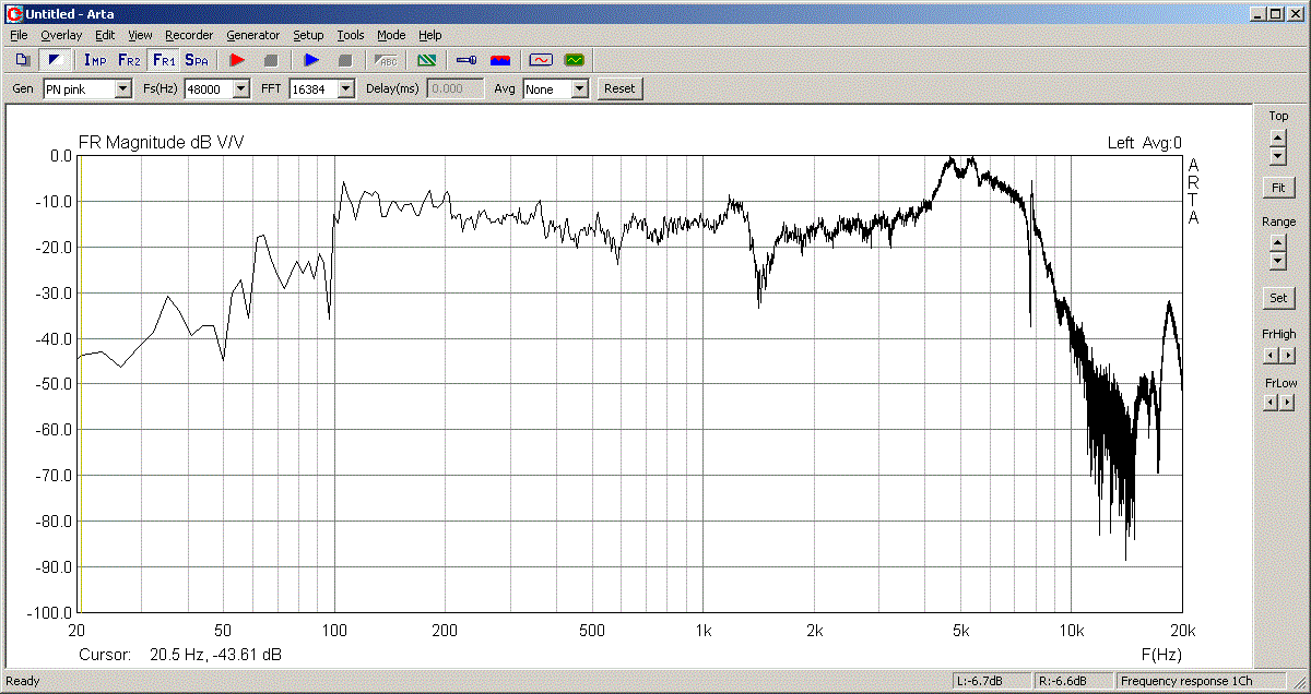

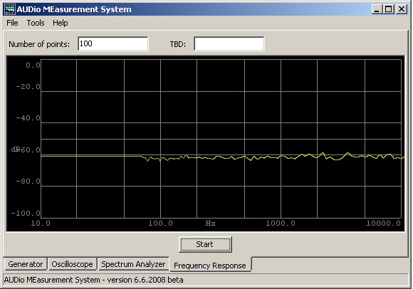

Here is some test results with a PC condenser mic.
The mic was placed some 2 inches away from the 6.5 inches midbass woofer.
The first test ( the first photo) was done with a 3 way car speaker.
The second and third test were done with the woofer.
Not sure about the result. I cannot interpret these yet. 🙂

Som, not familar with that software, but appears to me that your not seeing the woofer at all. Looks like you are measuring the noise floor.
One of the tests I use for testing mics (and setting the deviation on a single side band transciever to 5kHz) by saying 5, yes five!. Said strong and held long will yield a constant amplitude signal that's easy to see when doing tests.
Place the mic closer, as close as possible without touching, lets say 1cm
I'll be crashing here shortly, so have some fun with the software, read some tutorials and what not. Your doing great so far 🙂

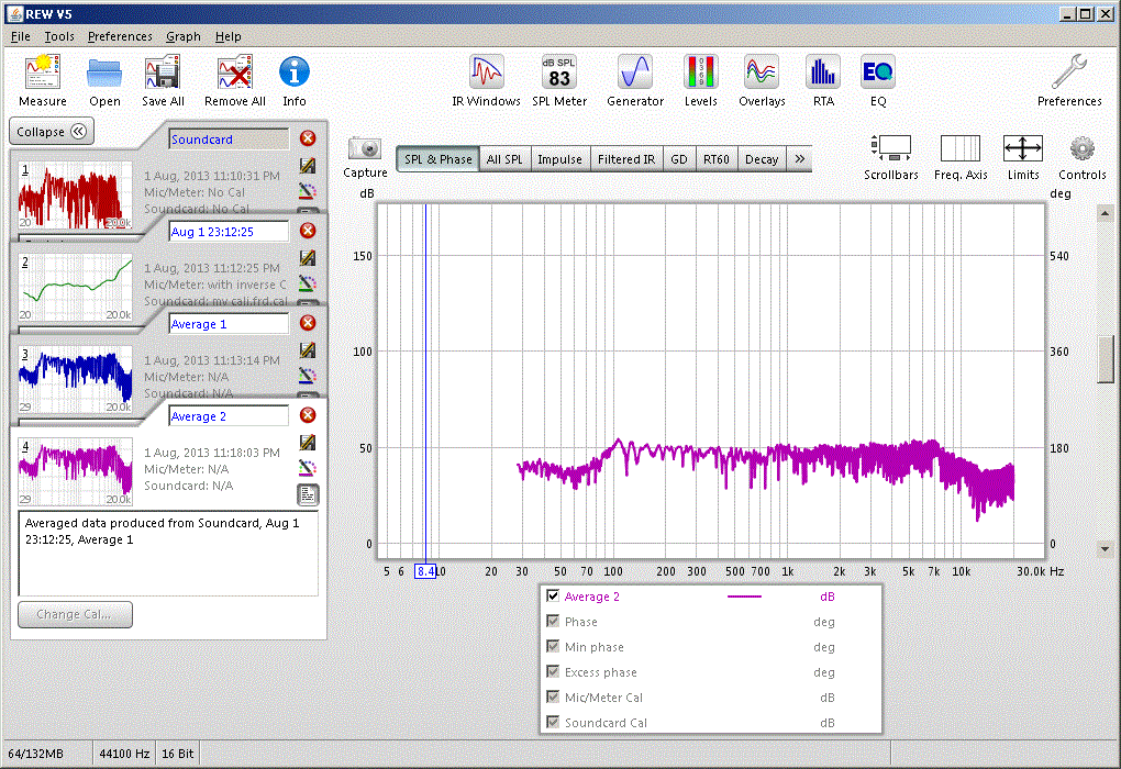

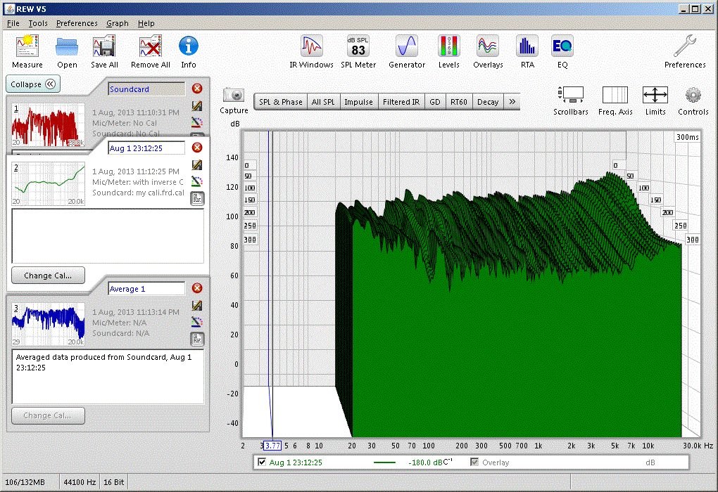

Respected all,
I separated the woofer chamber from the midrange section and the bass response is less boomy and there is a slight improvement in the dynamic range.... the defects of compressed mp3 sounds are more prominent now, LOL
I was checking with a ballad. It sounded great.
I think I will stick to the MLTL. I compared the sound with a normal two way speaker, but TL sounded way better to me.

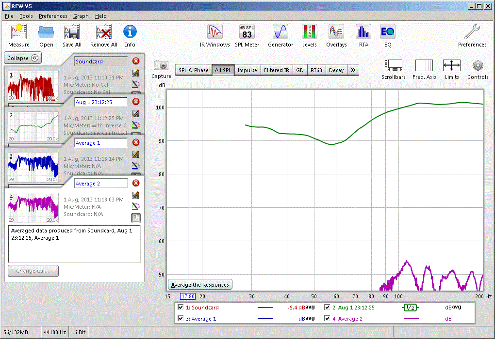

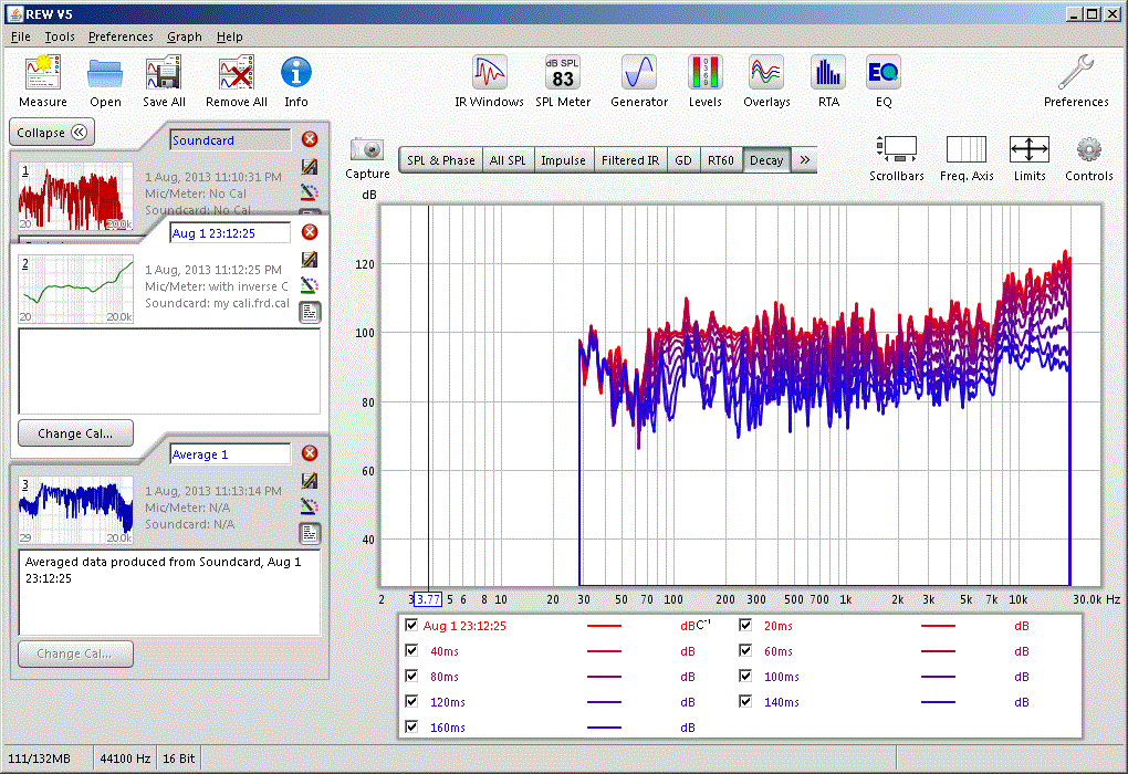

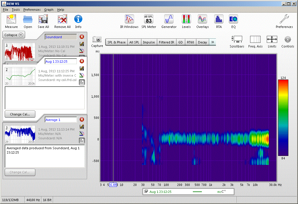

Anyway, here are some snaps again, tested with my DIY MLTL 🙂 ( thank you for teaching me the term 🙂 )
Kindly check these and advise me please at your convenience.

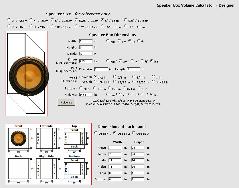

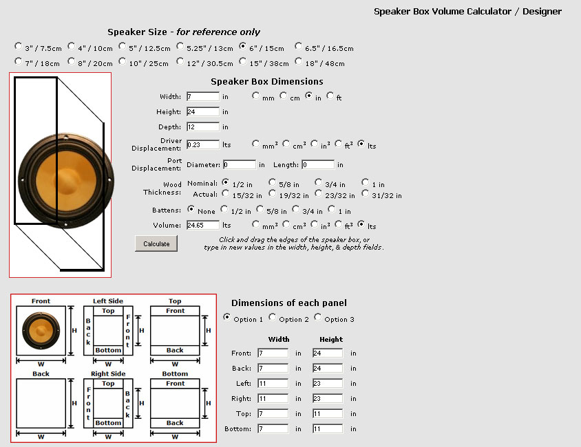

Do you have the Vas, Qts, Qes, Qms, Fs values requested last week?
Measure drivers independently from a 1cm distance on center.
Cannot make heads or tails out of the above graphs. 😕

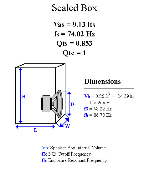

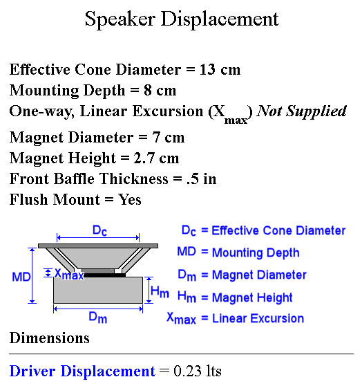

If you have built the enclosure described in your 3D models, it is incorrect. Length, depth, woofer placement and port placement are wrong. The mid and tweeter placement are dependent on driver diameter/crossover frequency/baffle width and are most likely incorrect also.

I thought these might be useful in determining the present audio performance, decay, audio spectrum reproduction in my listening environment. But now I see I am utterly wrongCannot make heads or tails out of the above graphs. 😕

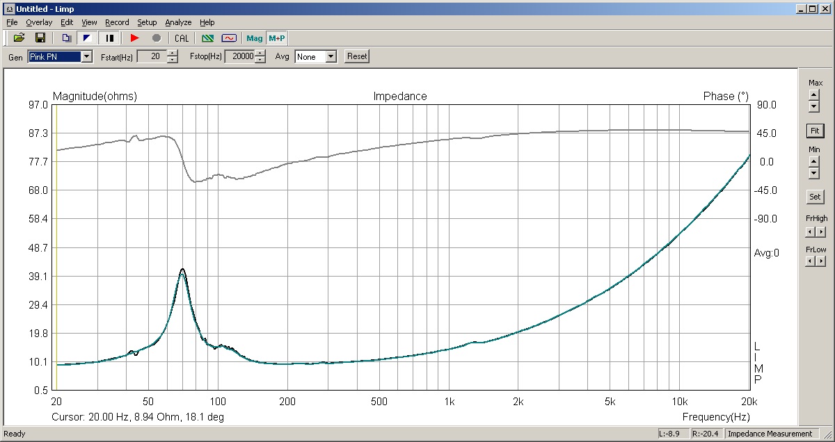

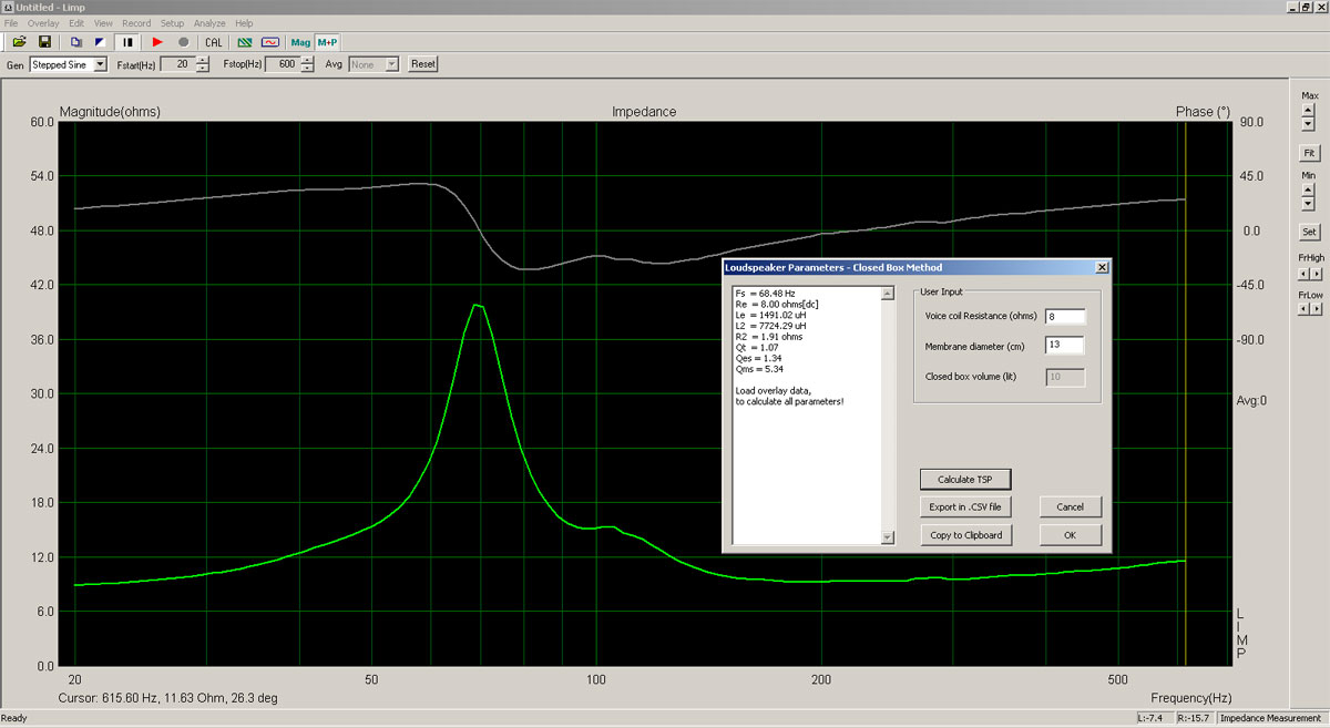

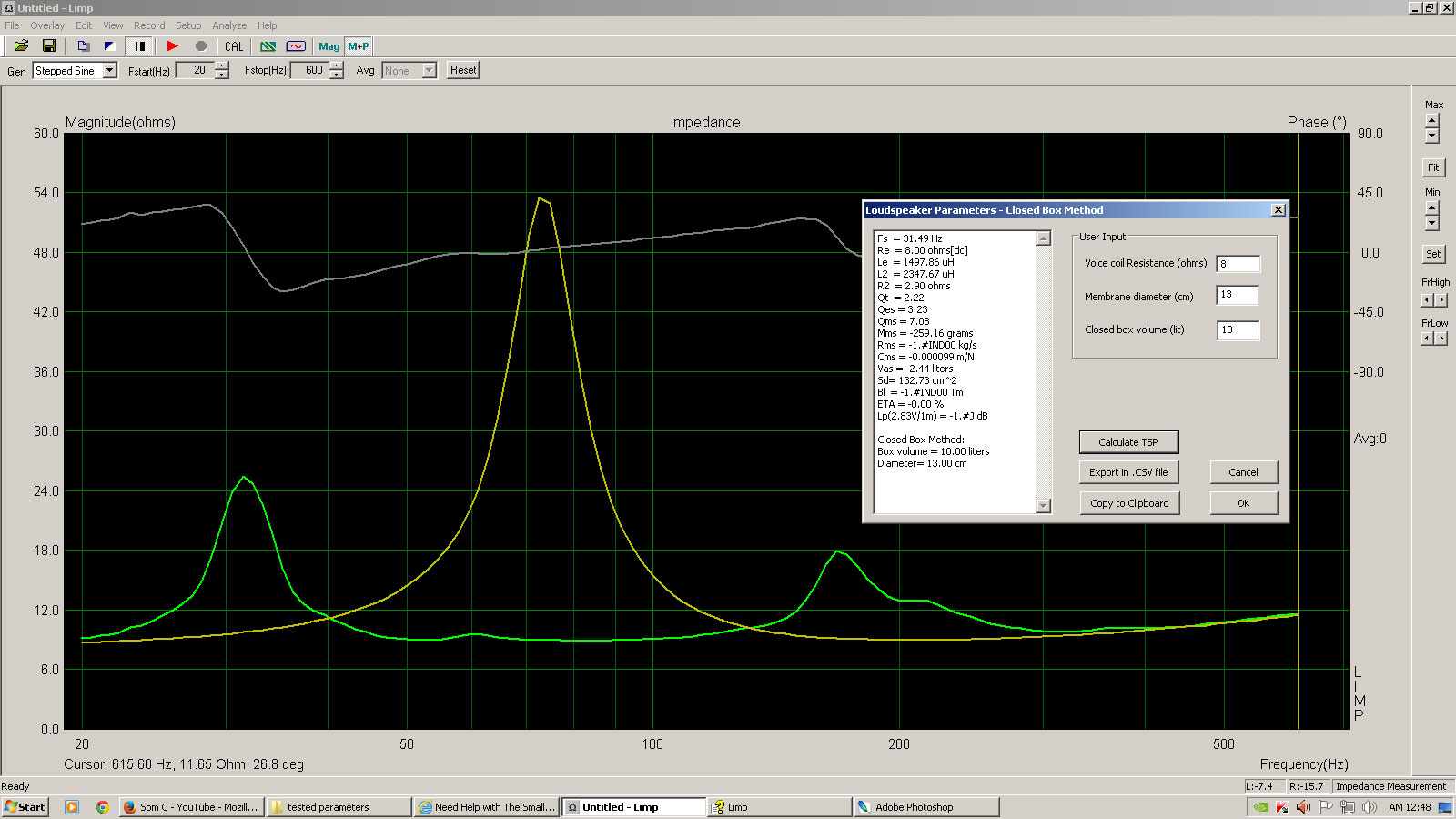

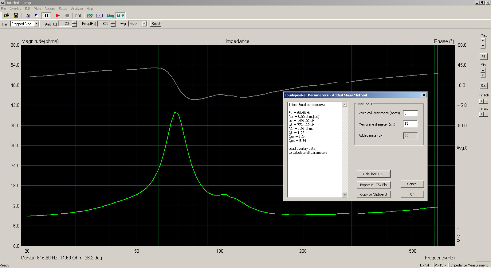

A little progress but faced a new problem
Respected dear friends,
I read and studied innumerable sites including your posted ones.
And finally I made a jig for LIMP and now I'm able to pick up the parameters of the drivers very easily. It's really a great way to effortlessly obtain the specs.
Please accept my sincere thanks for all the encouragement and your teaching me this much-needed technical aspect.
I tested some 5 drivers. Branded and some non-branded speakers are giving desired tsp output. And I'm happy.
Now I have a problem.
I tested the non-standard mid-bass woofer that I have in my system and intend to use due to its more or less satisfactory performance so far. But here I faced a problem.
LIMP reported "bad parameters" and I was unable to obtain tsp.
Now I don't know what to do.
I tested with both the stepped sine-wave as well as Pink Noise methods. I did an overlay of both in the attached snapshot.
Kindly help me.

Update
I set the highest cut-off frequency to 600Hz considering the nature of the driver and it worked!
And now I got the tsp.
Parameter --------Value-------- Dim
Fs --------------68.48 ------------Hz
Re ---------------8 ---------------ohms[dc]
Le ------------1491.02 -----------uH
L2 ------------7724.29 -----------uH
R2 ----------------1.91 -----------ohms
Qt ----------------1.07 ----------------
Qes --------------1.34 -----------------
Qms -------------5.34 -----------------
Kindly check out the attachments and give your valuable advice on the next step.
Thank you all.

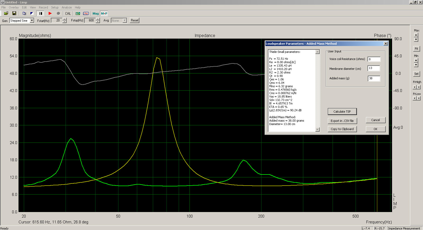

Update again
Here is the full spec of the midbass as I obtained from the test.
Kindly check it.
ADDED MASS METHOD:
Thiele-Small parameters:
Fs = 72.51 Hz
Re = 8.00 ohms[dc]
Le = 1335.43 uH
L2 = 1410.20 uH
R2 = 2.30 ohms
Qt = 0.90
Qes = 1.06
Qms = 6.04
Mms = 6.32 grams
Rms = 0.476560 kg/s
Cms = 0.000762 m/N
Vas = 18.85 liters
Sd= 132.73 cm^2
Bl = 4.657913 Tm
ETA = 0.65 %
Lp(2.83V/1m) = 90.24 dB
Added Mass Method:
Added mass = 38.00 grams
Diameter= 13.00 cm
Closed Box method:
Fs = 31.49 Hz
Re = 8.00 ohms[dc]
Le = 1497.86 uH
L2 = 2347.67 uH
R2 = 2.90 ohms
Qt = 2.22
Qes = 3.23
Qms = 7.08
Mms = -68.20 grams
Rms = -1.#IND00 kg/s
Cms = -0.000374 m/N
Vas = -9.27 liters
Sd= 132.73 cm^2
Bl = -1.#IND00 Tm
ETA = -0.01 %
Lp(2.83V/1m) = -1.#J dB
Closed Box Method:
Box volume = 38.00 liters
Diameter= 13.00 cm

L2 = 2347.67 uH
R2 = 2.90 ohms
Qt = 2.22
Qes = 3.23
Qms = 7.08
Mms = -68.20 grams
Cms = -0.000374 m/N
Vas = -9.27 liters
Sd= 132.73 cm^2
Bl = -1.#IND00 Tm
ETA = -0.01 %
Closed Box Method:
Diameter= 13.00 cm
Is this correct?
I measured again with LIMP using pink Noise after calibration.
Here is the Thiele-Small parameters:
Fs = 74.02 Hz
Re = 8.00 ohms[dc]
Le = 1239.56 uH
L2 = 1599.30 uH
R2 = 3.60 ohms
Qt = 0.86
Qes = 0.98
Qms = 6.60
Mms = 12.53 grams
Rms = 0.883244 kg/s
Cms = 0.000369 m/N
Vas = 9.13 liters
Sd= 132.73 cm^2
Bl = 6.882899 Tm
ETA = 0.36 %
Lp(2.83V/1m) = 87.69 dB
Added Mass Method:
Added mass = 10.00 grams
Diameter= 13.00 cm
I used the parameters in an online calculator found at Diyaudioandvideo.com.
Speaker Box Design Example
This sets the volume of the enclosure as some 24.39 lts.
Could any of you kindly check the attachments and tell me if is correct or not?
Eagerly awaiting your response.
I will proceed to build the enclosure after getting reply from you.
Thank you.
Fs = 74.02 Hz
Re = 8.00 ohms[dc]
Le = 1239.56 uH
L2 = 1599.30 uH
R2 = 3.60 ohms
Qt = 0.86
Qes = 0.98
Qms = 6.60
Mms = 12.53 grams
Rms = 0.883244 kg/s
Cms = 0.000369 m/N
Vas = 9.13 liters
Sd= 132.73 cm^2
Bl = 6.882899 Tm
ETA = 0.36 %
Added Mass Method:
Diameter= 13.00 cm
Thank you.
