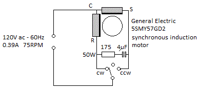

The green resistor appears to be an original fixture. If it was definitely wired in parallel with the start winding then I am unsure of its function.
On the occasions when a resistor is shown in relation to an induction motor, it is shown in series with the run capacitor as per the diagram in post #6 and in the attachment below. However, the value of the resistors shown is in the order of 200Ω rather than 2kΩ.

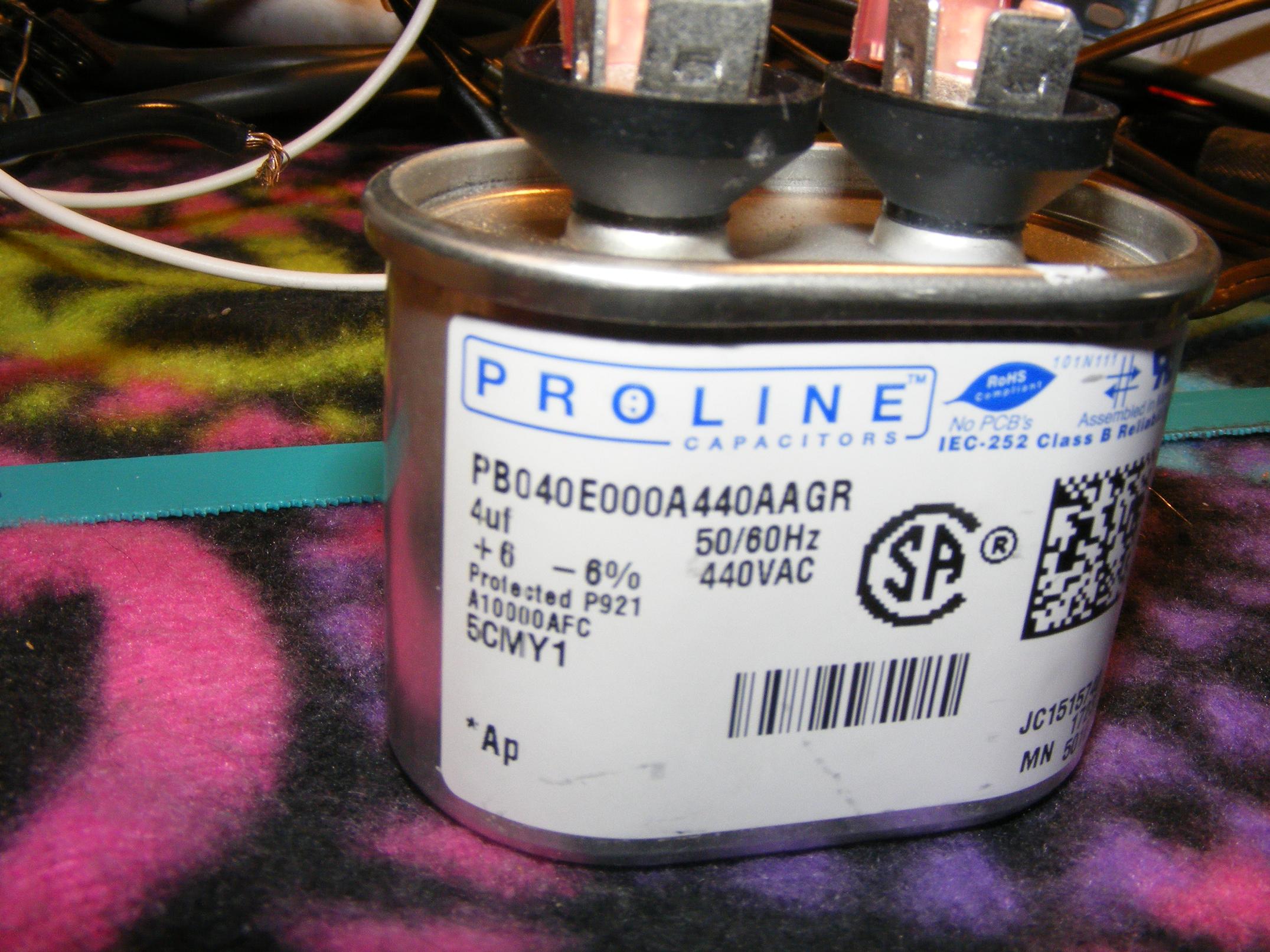

Would still like to know the type of capacitor you have obtained in order to eliminate possible causes.

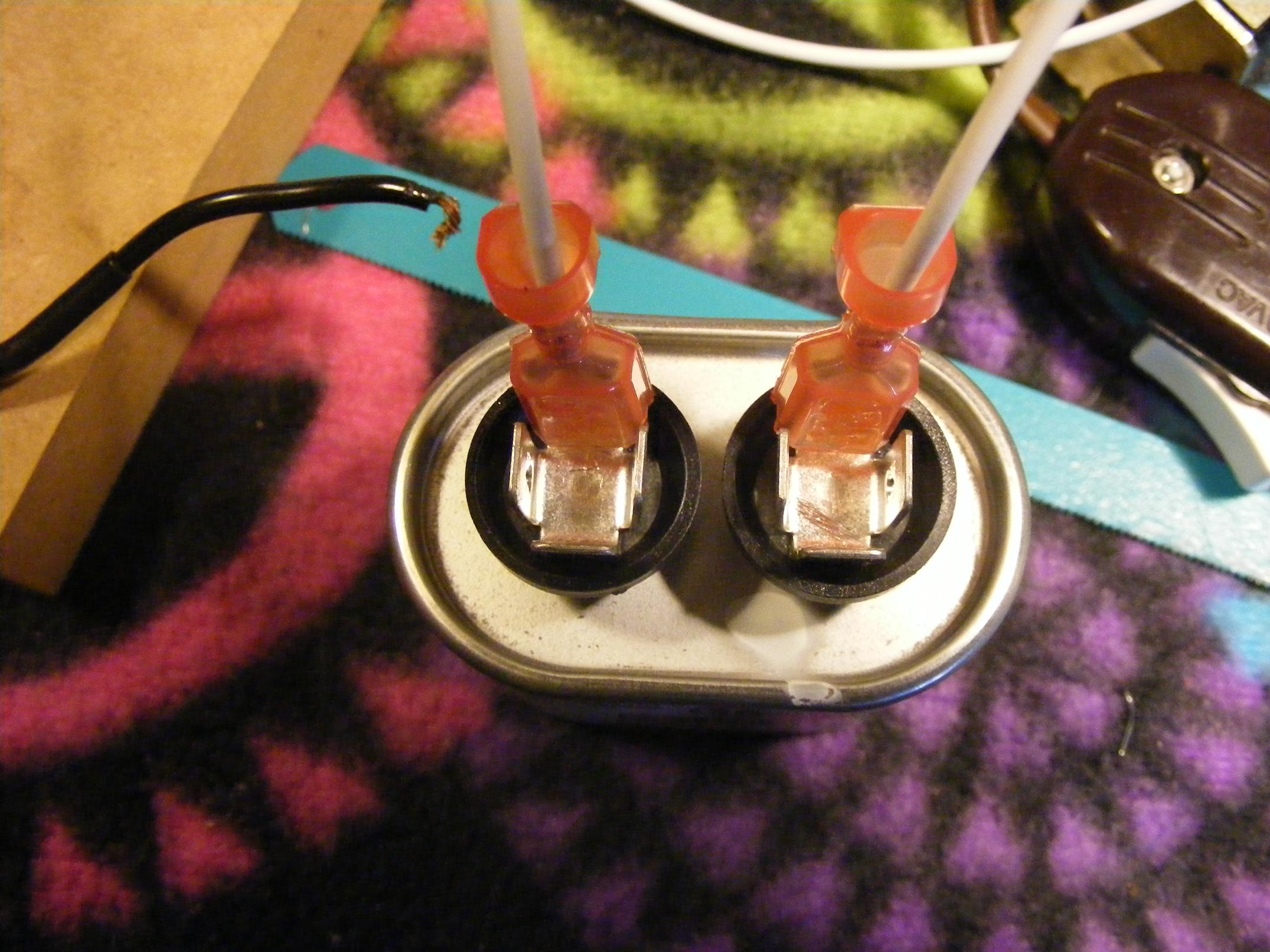

OK. With resistor installed as you specified the motor would hardly turn at all so immediately shut down. I have included two pics of the cap. Is what appears to be a white paint mark near the right hand terminal of any significance? Thank you.
I'm flummoxed! Can't explain why the 2kΩ resistor only overheated when the new cap was introduced.

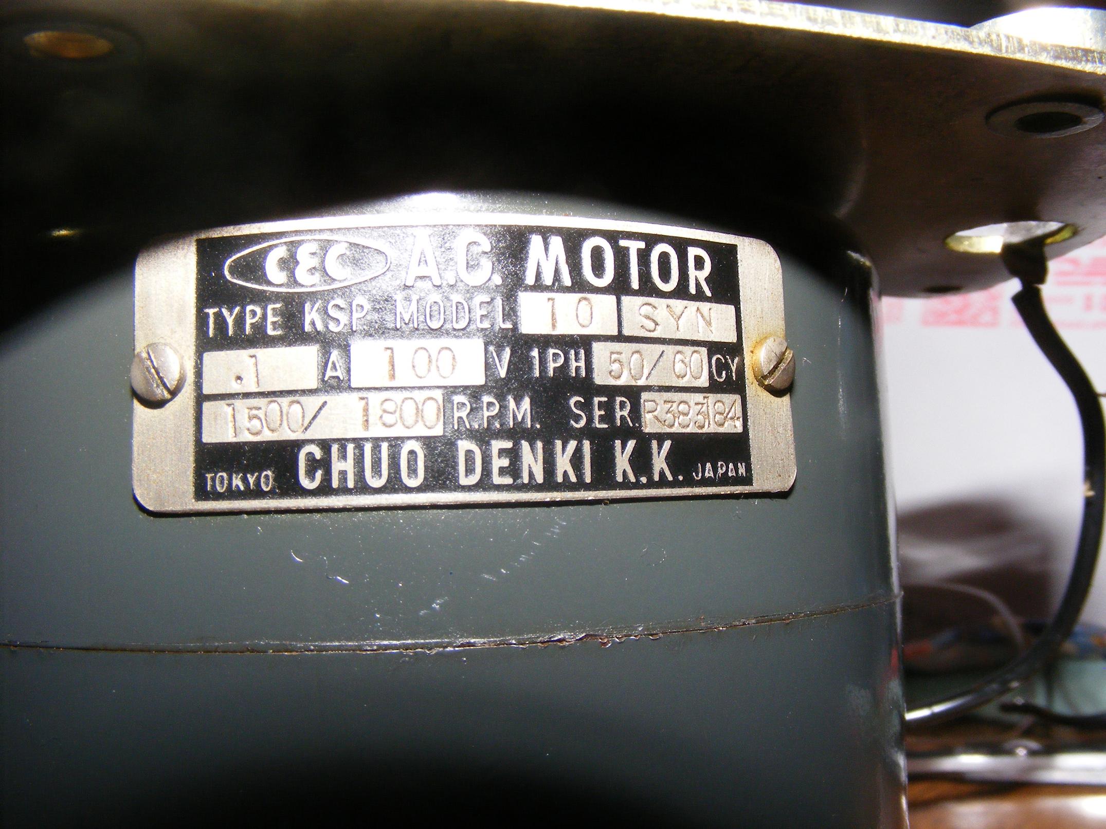

Hi Ralph and thank you for helping. Picture is attached. I just ran the motor without the 2K ohm resistor for 25 minutes and I couldn't touch it for more than a second due to heat. I did notice on the plate it states 100V and I have about 119.7. Could this cause the heat?

The 2kΩ resistor was originally in parallel with the lower resistance start winding (black/grey; 175Ω) and the combination was in series with the run capacitor.
This is the original configuration which appeared to work until the new capacitor was inserted, when the 2kΩ resistor went red hot!
