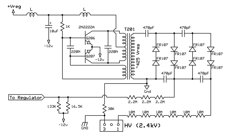

Hmmmm...it looks like most of the 500V and 700V parts of interest are out of stock at Mouser.
Here are some 2.2Mohm 1% 1/4W 1.6kV for reasonable price that will work great.
http://www.mouser.de/ProductDetail/...GAEpiMZZMsPqMdJzcrNwtILrAkg5Vgfztk%2bQpRSOEc=
With 1% tolerance parts, the difference between 2.21Mohm and 2.2Mohm is negligible in this application.
Have been very pleased with the Vishay HVR25/37 and VR68 series high voltage resistors.

It was the suspected defect resistor. I purchased the resistors you recommended, bolserst, and replaced all of them in both speakers (just as I did with the diodes and ceramic caps), so the HV section as all Vishay quality parts in it. What stuns me as how dead silent the speakers are now when no music is playing and how crisp they sound. Leaves me suspecting that the other resistors may have been on their way of going on the blink as well.

For future reference, I updated the schematic I had posted previously to show where the faulty 2.2Mohm resistors are located in the circuit.
