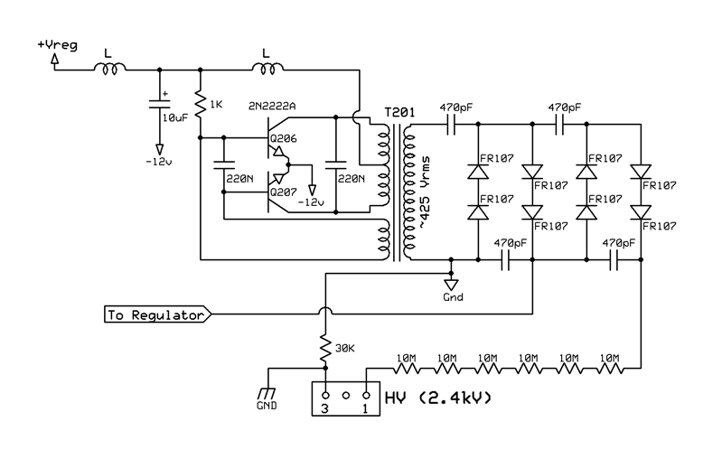

Attached is a schematic I traced out for the oscillator and HV multiplier portion of the board.
You may find it useful during your troubleshooting.

Dear Friends, I think I may have found the error thanks to a tip from another member of the forum. He indicated that he had discovered similar crackling in ML panels if the output voltage was too high and mentioned that he had occasionally found the resistors R211, R214 and R217 to fail under the permanent high voltage running over these, causing this failure. I unsoldered a leg of each and low and behold, R217 measures as defect part in my component tester, so this may be the culprit. I won't be able to tell for sure until I have replaced them (I'll replace all three on both panels as prophylactic measure) ... need to order these.
@bolserst: do you happen to know the rating of these resistors? I'm not sure with the third and fifth ring, if these are red or brown as the colour is so similar to the first two rings, which I read as red. I assume it is brown, which would mean these are 2.21m Ohm 1%... could that be correct?
Thanks in advance :)
A faulty component finally located. This is good news!
Yes, they are 2.21Mohm 1% 1/4W 500V resistors.
I had thought a couple times about having you check those, but the symptoms just did not seem to point to them, so I didn't. :eek:
These resistors form part of the voltage divider used for feeding the sensed output voltage back to the voltage regulator portion of the circuit. During normal operation, they will see roughly 1200 VDC across the three, so 400 volts across each. This is running pretty close to their voltage rating. Since there is room on the board, you might consider replacing them with 1/2W 700V resistors.
