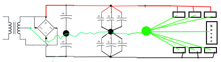

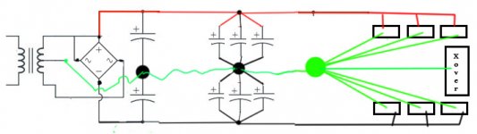

I tried my best as I understood from your direction . Kindly have a look.
Done.
Done too sir.
no.
The first pair of caps take the biggest charging pulse.
This circuit: transformer to rectifier to cap pair MUST be separate from the next stage of smoothing.
Use ONE wire link from first stage smoothing to second stage.
The use ONE wire from second stage to Main Audio Ground.
DO NOT put the Main Audio Ground between the smoothing caps.

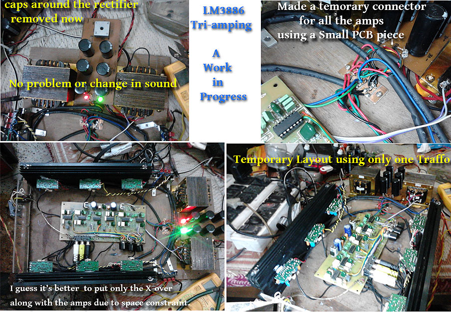

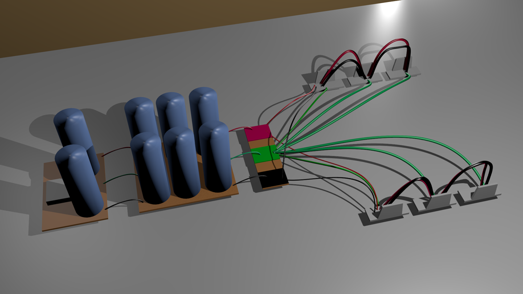

Work in progress
This is the update of my work.
1. caps around the rectifier removed now. No problem, no perceptible change in the sound quality, no hum, hiss or any disruption.
2. Each amp is connected to a common connecting point with heavily twisted wires using insulating tubes.
3. Now connecting the amps to directly to the AC 220V. Removed the bulb in series. Pretty loud thundering output with exceptional clarity even with one four amp transformer and 6 X 4700 uFd.
when the bulb is in series with six amps, the amps are not working now but with direct connection from the mains, the sound is magical.
No clipping at all when the volume ( 100K dual Volume control ) is at the maximum position. I have not used the preamp this time. Just connected the output from an MP3 player (with maximum volume) to the input of the X-over.

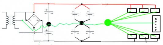

no.
Thank you sir.

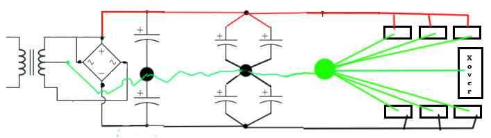

Posting my another effort ( expecting a "no" again) 😀
Kindly have a look.

It is +-33.5 VDC now with 6 set of caps now.
Can I add two more 4700uFd caps at the second stage of the PSU?
Will the voltage be under safe operating limit then?
Yes, but there is a point of diminishing returns, ie, you won't get much, if any benefit, from the added caps. If you are going to use the all the caps, I would divide them between the speaker cabinets; two per rail for each box, if you have eight. I use two x 4,700 caps per rail and, if there is any voltage sag, I can't hear it. (Mainly because, at that volume, I can't hear anything but the music, not even my own thoughts. 🙂 )
Yes. More caps does not affect the rail voltages, it only provides extra current when needed.
The unloaded PSU voltage is fixed at +/-33.5 VDC, at which the LM3886 datasheet gives the clipping voltage as 2.75 Volts.
