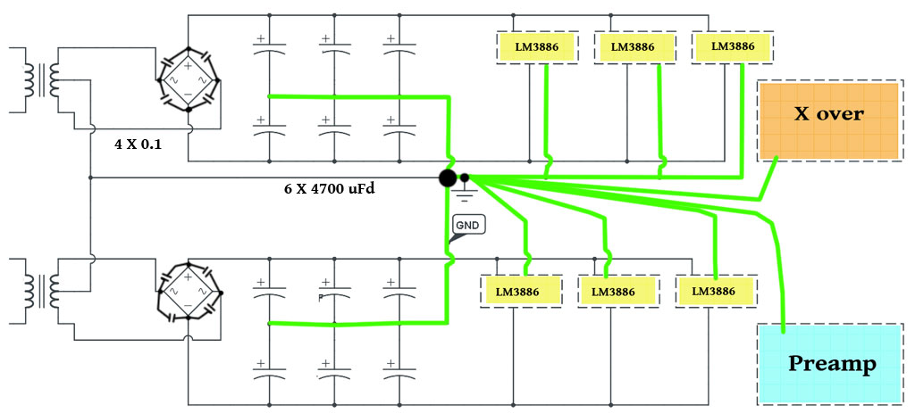

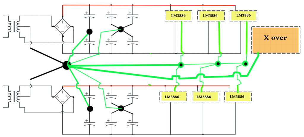

dear csom,
thank for your advice,i have two pair of mosfet 2sk1058 and 2sj 162 how will the sound of these mosfet do u have any experience .thank u sir
Dear Masood,
A good sound depends on several factors, as I learnt from reading innumerable posts by the audio gurus here and from my personal DIY experience and I am still learning each day here at Diyaudio forum with the kind help of all.
1. Quality of components.
2. PCB layout design
3. Adequate filtration of the power source
4. Proper grounding ( very important )
5. The quality of audio source and preamp
6. Quality of speakers and cross over
7. Your listening environment etc.
Any compromise is bound to affect the proper reproduction of the desired sound.
I assembled/ built/tested at least 6 discrete amplifiers. You know good quality components are beyond the scope of average Indian hobbyists. And more, the cheap commercial "high end" discrete MOSFET Amp kits available locally, use low quality components, badly designed PCB and inadequate filter capacitors. Result ? Hum, unwanted noise. They let you feel that they are switched on. But they are loud ( with distortion figure too ). I felt the same with classic 2N3055 kits too.
Let me share with you a fact. Last year I purchased a so called "high end 1600 watt MOSFET kit" with much optimism. When everything done, I felt a low hum. I informed the vendor and he simply said "oh this is normal with such a high power kit". What the ....! I spent my money to buy a High End Humming Amp!!!!!!??? I was utterly frustrated. I tried increasing the filter caps and somehow I was able to tame down the hum to a certain tolerable level. But there was a wonky crossover distortion. And in Indian local situation, there is a "no return" policy once the "...." is sold.
Meanwhile, I was reading about TDA2030 chip on the net. I studied the data sheet and found a PCB design there. It was so simple. I used a marker pen and drew the PCB layout following the datasheet and etched it. And when I casually finished the amp, .....oh my god! The sound quality was far superior than my purchased "High end commercial ...." kit. I felt that my speakers were in need of that chip as their perfect companion.
Then I went one step ahead. And made a two way active amplifier following Sir Rod Elliot's two way cross over. Result? Unprecedentedly astonishing sound quality. My cousin brother who works in a studio with high end devices, was simply addicted to the detailed and rich sound and listened for three hours at a stretch until dad reminded us that it was almost dawn and "we must take some rest"! And the sound was coming out of an amp that cost me less than 4 packs of cigarette! And there was no crossover distortion!
I just had to discard my "high end discrete .... " and "upgrade" to TDA2050 as I needed a little more power. And that experience made me a lifelong fan of Chip amps for good.
My point of sharing this personal experience with you is that listening environment is also important. Do you really need monstrous power at home? Why not learn to polish your PCB making skill, designing PCB layout of both the amp and cross over, and develop a small low cost board with TDA2030 ( which should cost you less than a pack of cigarette ) meanwhile? Even a set of TDA2030 in stereo tri-amping mode can give you a pretty loud yet very rich sound!
LM3886 will surely be available in your locality very soon, if not today, tomorrow for sure.
My humble suggestion is if you can afford, go for an active amplifier system like I made and it will definitely and clearly outperform any of the locally available commercial craps. You will be pleasantly surprised, I can bet.
I followed Sir Rod Elliot's advice about using active X-over system, given on his website and I now feel how right he is!
For proper ground connection, kindly follow Sir AndrewT's posts, for a dead quiet system.
Hope this helps.
