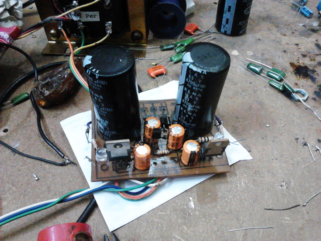

thanks for sugestion i have both 2030 ic and its pcb.i will show you the pcb and its amplifier soon thanks again yours masood

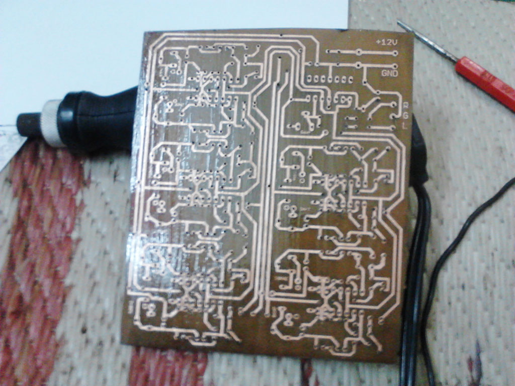

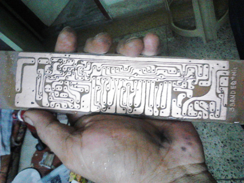

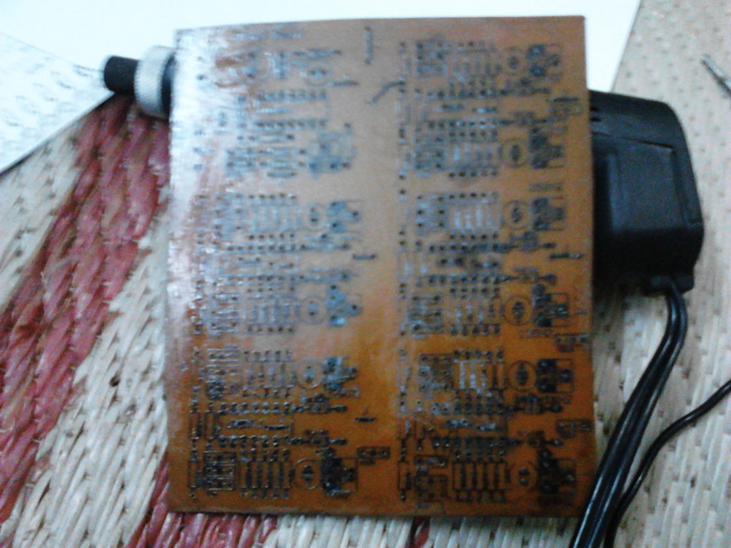

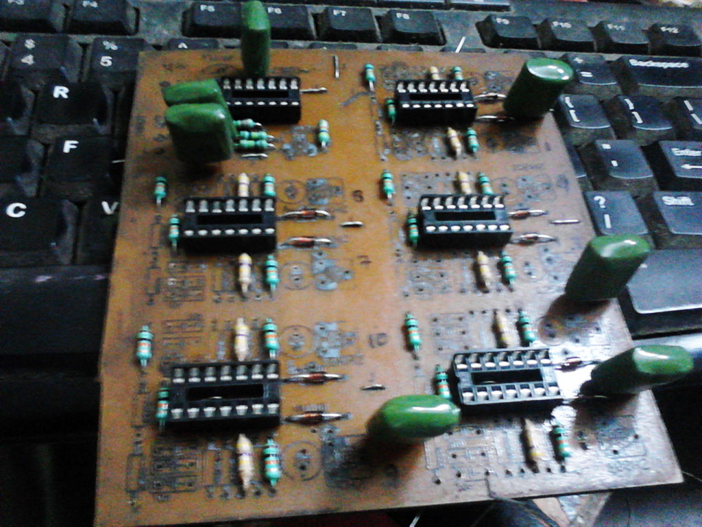

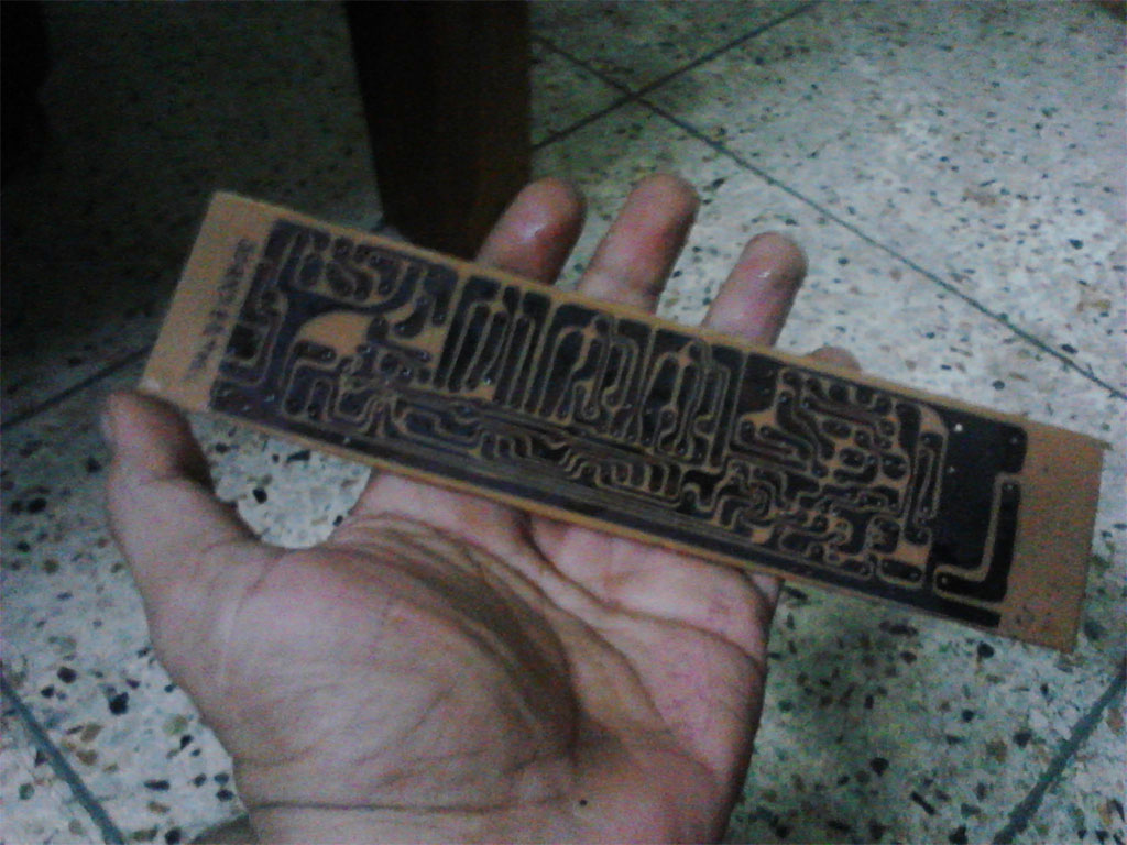

2. And regarding PCB making: Just follow the method written below and you will get a professional result at home like I do in my Bedroom-lab. 🙂
a) Print the circuit with a laser printer using a good quality inkjet photo-paper. This is the most important part. This will give you a great result, I can assure you.
b) Clean the Copper clad board of the same size (after cutting it) with water and Scotch-Brite that is used to clean the cooking utensils. Wipe it off with a soft and very clean cloth and let it dry for a minute or two. Never ever touch the cleaned copper surface with your hand once its cleaned.
c) Get a small sized plywood plank where you can place the pcb firmly. The surface of the plank is rough, so you won't need any addition fixing material to prevent the PCB getting slipped while you use toner transfer method. Also the pre-heating of the board is NOT required.
d) Set the knob of the electric Iron to the maximum temperature position and wait till it reaches the maximum temperature. Now press the tip of the iron to slowly but firmly over the photopaper and start pressing the paper against the board.
When each and every impression is clearly visible on the overleaf ( the white side of the photo paper where the circuit has not been printed) you can stop ironing. For a very tiny board like APEX GAINCLONE PCB, it might take some 4 to 5 mins.
e) Now slowly peel off the paper when the board is slightly hot. If it's a clean and excellent transfer, the photo-paper should come out easily.
If not, put the board into some cold water and wait for 30 minutes. Then use your thumb to rub and easily remove the excess paper.
f) Etch the board using your preferred method. I use Ferric Chloride solution (1:3) because I can re-use that.
g) When etching is done, remove the toner with Thinner solution and you will get the shiny copper tracks.
h) You can apply a solution to protect or weatherproof the copper tracks.
For this I use a little amount of resin diluted in thinner. It helps to solder the components too.
i) I print the component layer too using the method described earlier (except the etching part).

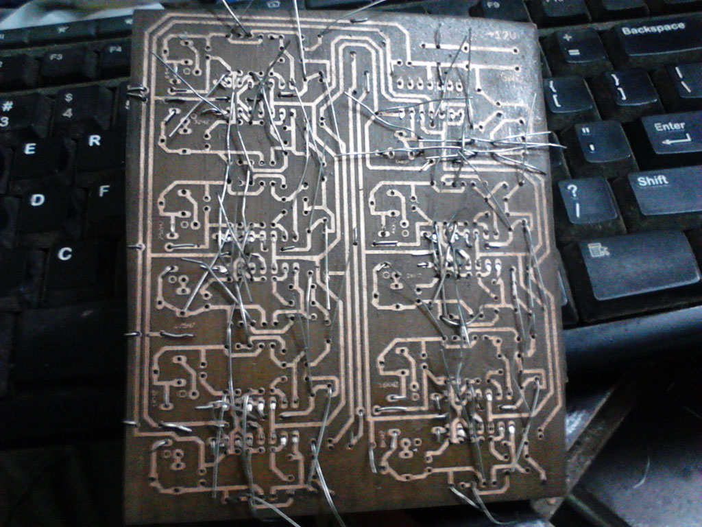

j) For the drilling part, I now use a high speed micro drill purchased locally.
Below is a link of an old video of mine that I uploaded earlier on this topic as my personal learning experience. But now, I neither use that transparent paper nor I pre-heat the board.
I use only photo paper now and that saved me from many hassles.
You can get some help for the etching part and the size of the container, removing toners etc. in that video.
I forgot to wear protective gloves etc. but you should definitely take care about your hands and eyes because it's a risky process. Follow the method with caution at your own risk.
Here is the link of my old video: DIY PCB: Home made Double Sided PCB-Home brewed dual layer PCB - YouTube

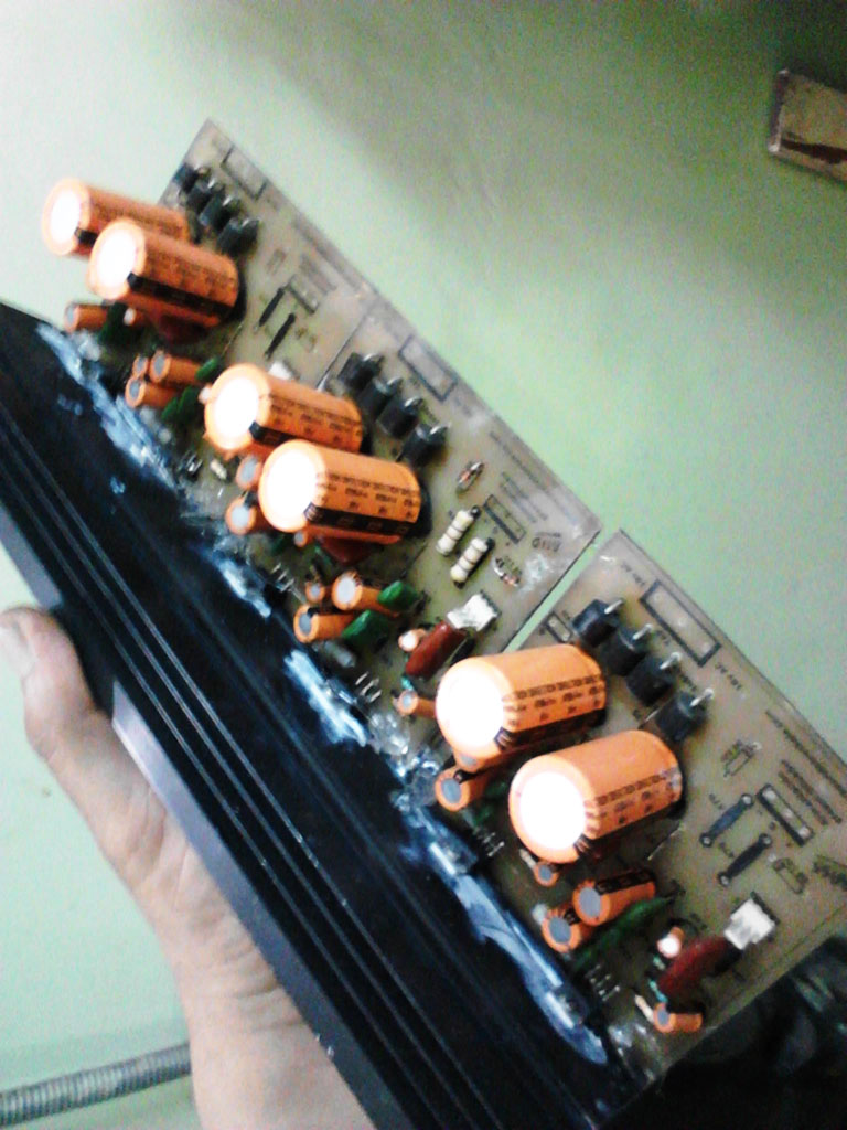

And here are some photos of the result that I get using photo-paper.
Good luck with your project.
