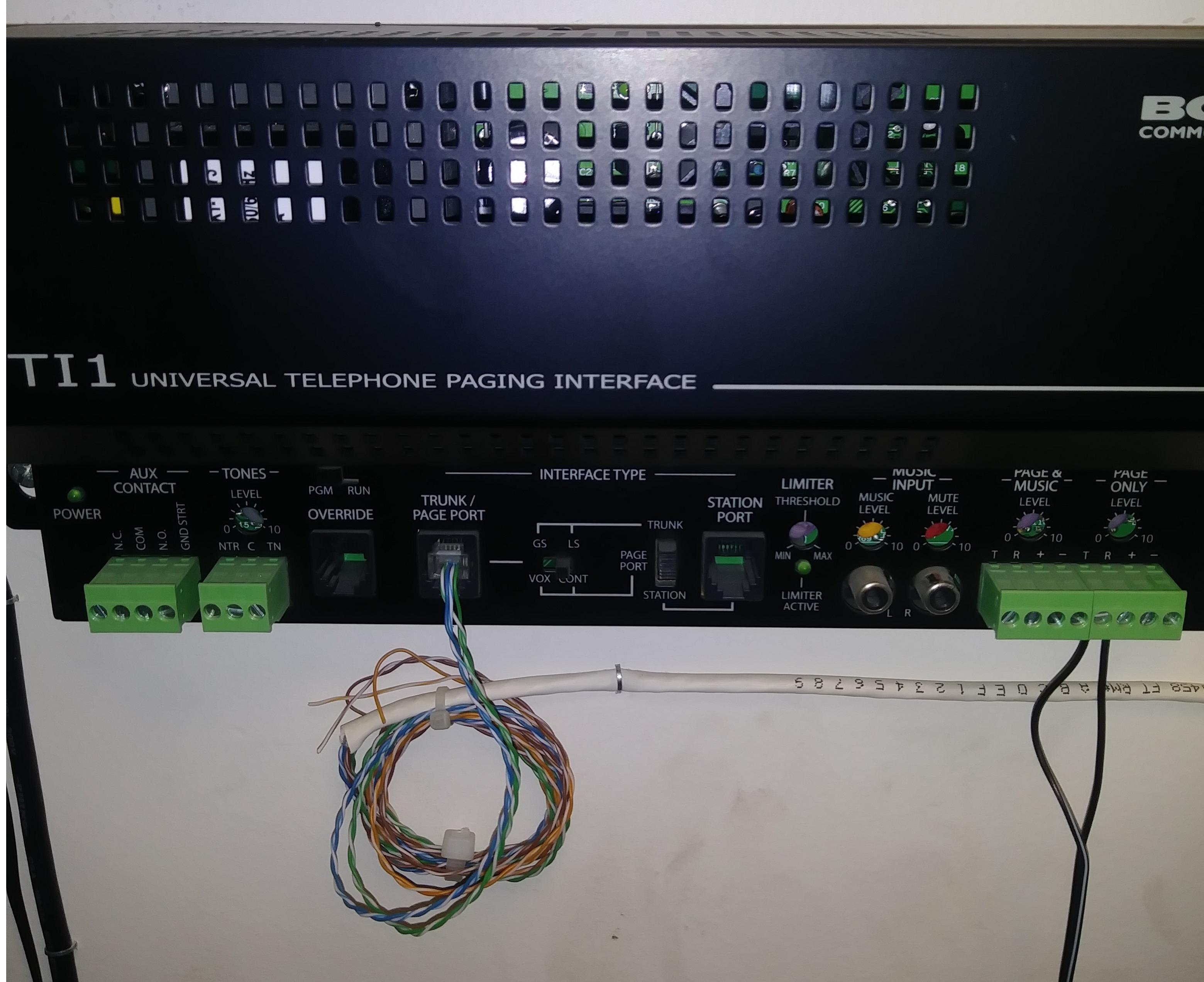

My paging system is a Bogen UTI1 Universal Telephone Interface.
Manual attached bellow.

I'm afraid that I do not know the ins and outs of paging systems!

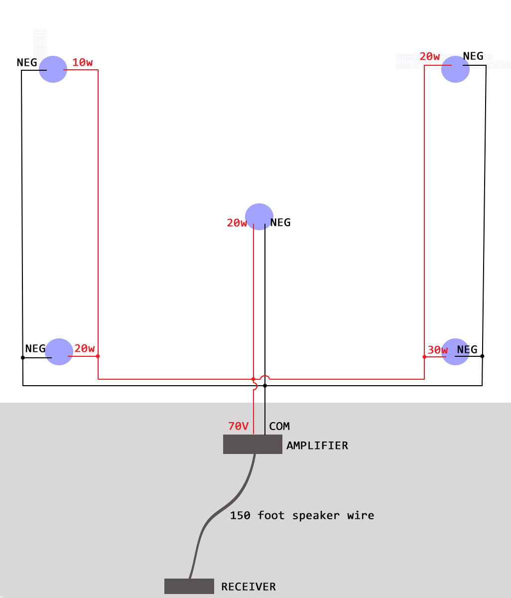

Thank you for that, while it should have been clear to me that since the speakers don't have a transformer, they would require a voltage line, i just never made the connection because i was soo obsessed to figure out what the proper ohm impedance should be.

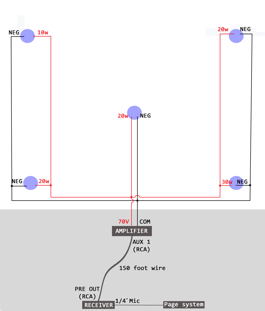

So this simplifies things. I made another diagram which should display the final line connection setup. Is that accurate? Also which is the best input to connect the receiver to the amp?
1) the speakers **DO** have a transformer, each of them.
It´s just "hidden" inside the beehive enclosure and they only show outside the power selection terminals.
2) your **speaker** wiring diagram is fine: all speakers in parallel, fed from a common 70V line, each with its own power setting, the total adding up to 100W
3) the receiver to amplifier interconnection is wrong. 😱
It is a "signal level" connection, not a "speaker power level" one, so they are NOT linked by a 70V line, at all, but from signal out at the receiver to some Aux input at the powwr amplifier, probably using RCA shielded wire cables.
You may use "just the receiver" but I think using the specific-for-PA mixer amplifier will be more flexible.
If you want to listen to AM-FM radio as oart of the program, you can connect receiver to mixer-.amplifier.

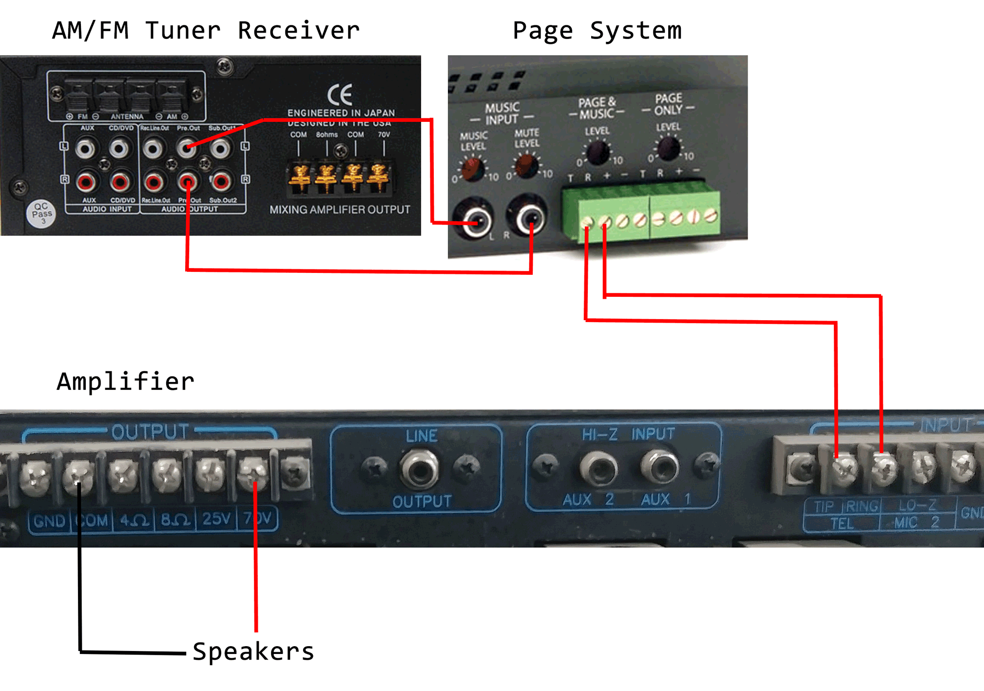

I've attached the latest layout of what i have so far.
Question, on the pre-out on the receiver, there are L/R RCA outputs.
Since the amp is going to receive a single channel, should i combine the receiver L/R channels or should i just use one of them?
You can take the output from just one the Pyle's pair of Pre Output Jacks i.e. the ones labelled (4) in the receiver's manual.
The Pyle gives a stereo output from its preamp, but you can simply make sure the FM radio is switched to mono (there is a switch on the remote control) and you will only need a single RCA screened cable to connect to the Champion.
It is possible to make a special cable which will combine, or mix, the left and right channels by means of a pair of 1,000 ohm resistors. I can supply details if necessary, but you'd have to be good at soldering!
One question, why does the receiver have to be so far from the Champion? The 70V loudspeaker runs can be as long as you like, but the screened RCA cable should be kept as short as possible. Consequently, I would locate the Champion right next to the Pyle. Is there a problem with that?

I was planning to put the speaker closer in fear that the lines would be too long and signal output would be lost but if what if, as you're saying, the distance isn't that big of a factor, I could simply put the amp right next to the receiver.
As for the tappings, I followed JMFahey's recommendation of selecting a higher wattage for noisy areas and less for quiet ones.
The RCA splitter would short the stereo channels together which is not a good idea! You would need to use a resistive combiner as I explained in my previous post. I don't think such a combiner lead is commercially available so you would need to have one made. The simplest solution is to use just the right hand channel output and switch the radio to mono.
Yes, put the amplifier next to the receiver as the 70V speaker cables can be as long as your installation requires - no (little) signal will be lost. The RCA lead between receiver and amplifier carries a much smaller signal so is prone to picking up hum and radio frequency interference and for this reason its length best not exceed 5 metres.
