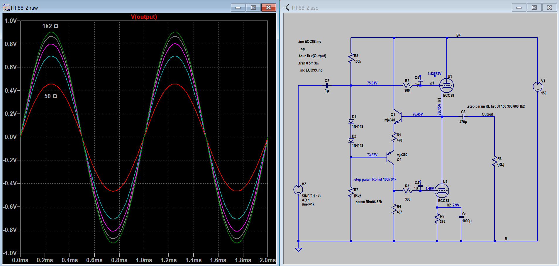

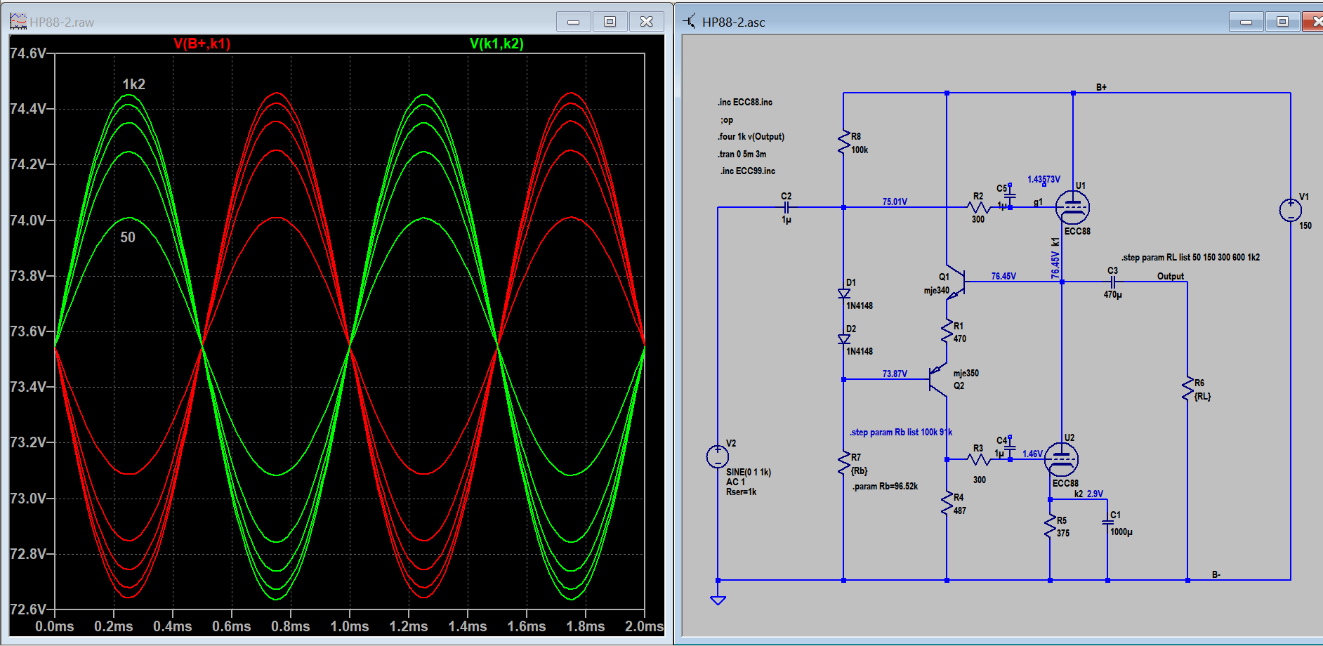

Need help reducing THD in ECC88 Over/Under design

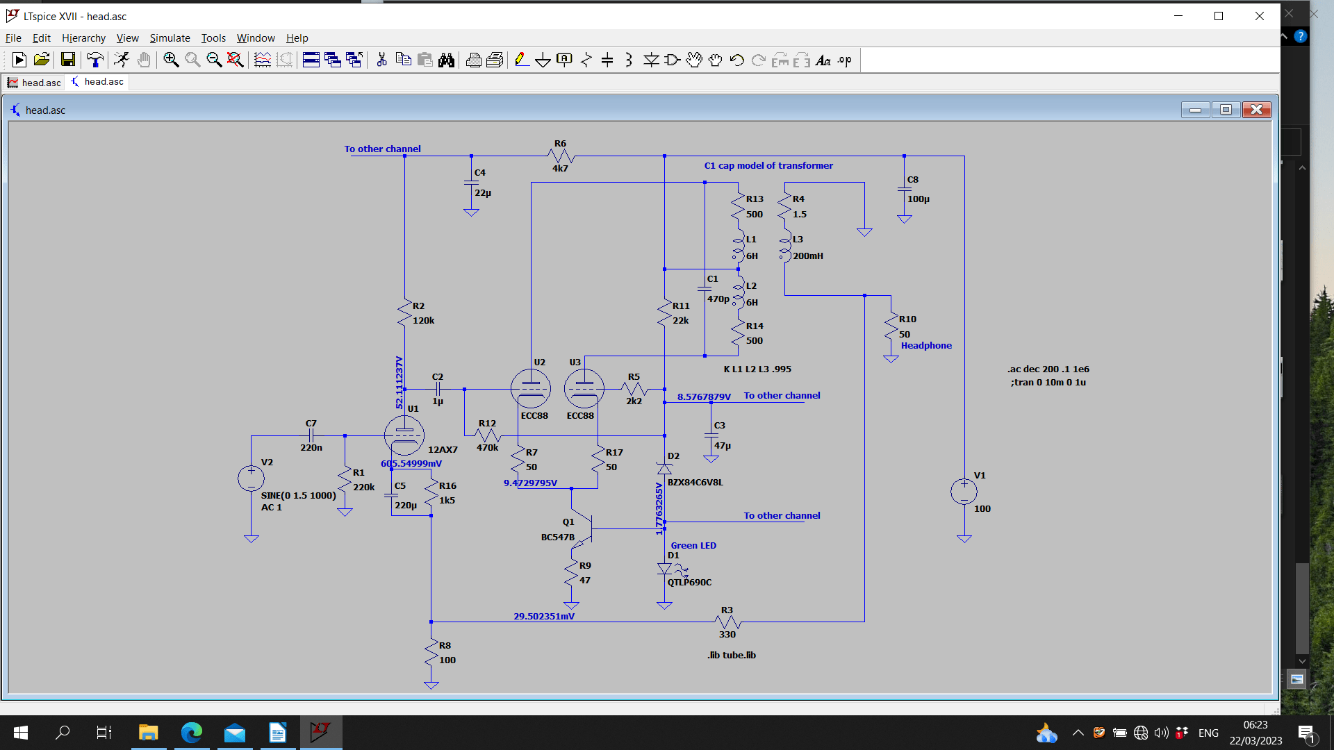

A few very small wires and cuts in the PCB the DAC now also works! The solution came to me whilst at work today so just ran all the incorrect connections by hand. Not my prettiest work but it works! 🙂
Now I just have to get both the amplifier and the DAC working on the same board! Once that's working it's onto the enclosure!
