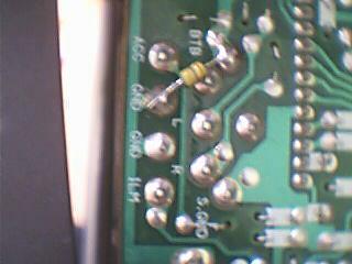

i`ve made some checking out....I found out the there is a resistor on the back of the board (i`ve found it ...frankly its the only piece there ) that bridges the bbp/bpm (don`t remember exactly ) with the ground.
i`ve measured it with the ohm meter and i get no reading.could it be that it is fried and replacing it could make the amp work without the bridged connection made this morning?
only problem and here is where I need your help perry, is that I don`t know the resistors value, and I can`t really find it on the schematic.

here are the photos of the resistor from the back part.the one I stated talking about.I`m posting it now.sorry , don`t got a better camera.it makes a bridged between the gnd and the btb of the DIN input
