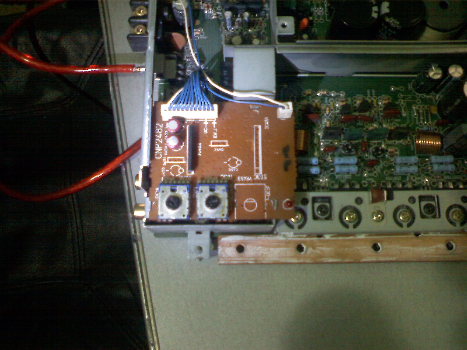

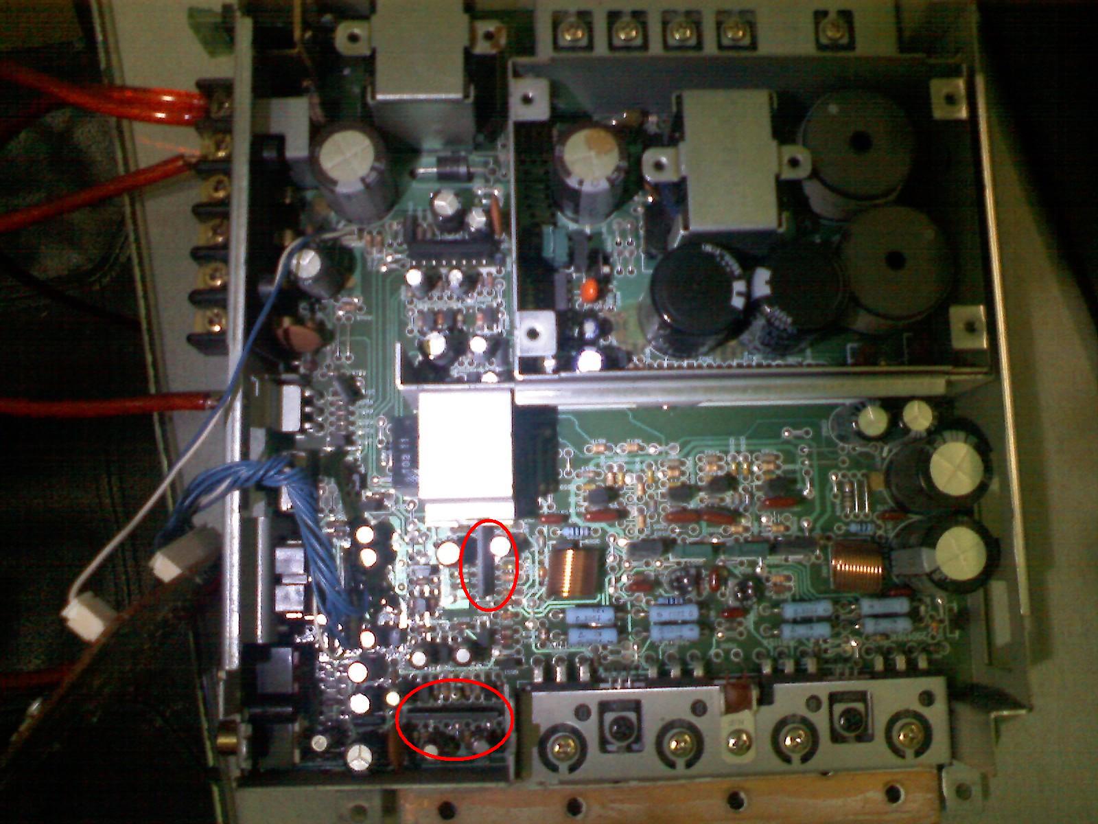

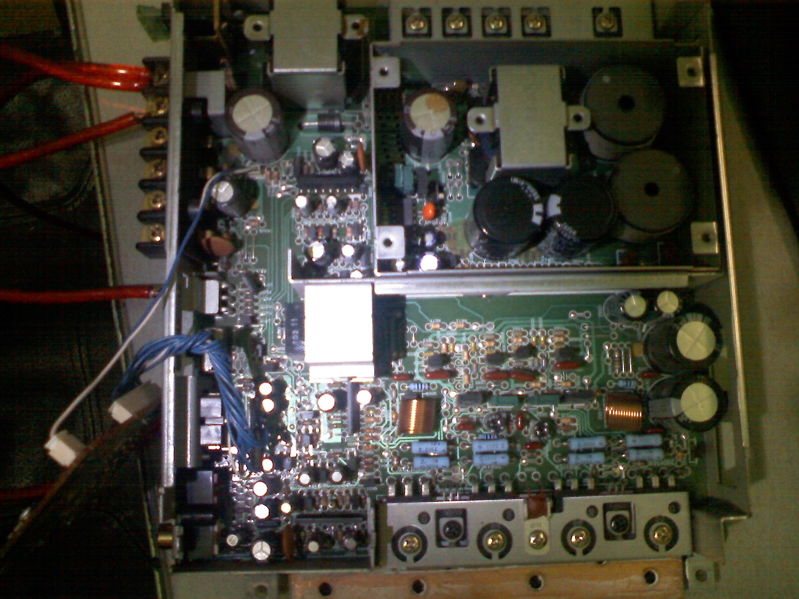

there are 2 on the main-board with the output transistors (their the long dark pieces in line with the output transistors and the one above), and only 1 IC (IC452) on the inputs, seen in the last picture attached. I cannot find anyother.If they are of diffrent form please let me know.
as I can only guess, the differente between the schematic and what is acctualy on the mainboard is due to the fact that I guess the schematic is for GM-1200, and not Gm-2200.Therfore there are a little bit of differences.
But on the input "line" there is only one IC.
As I can tell ti`ll now.

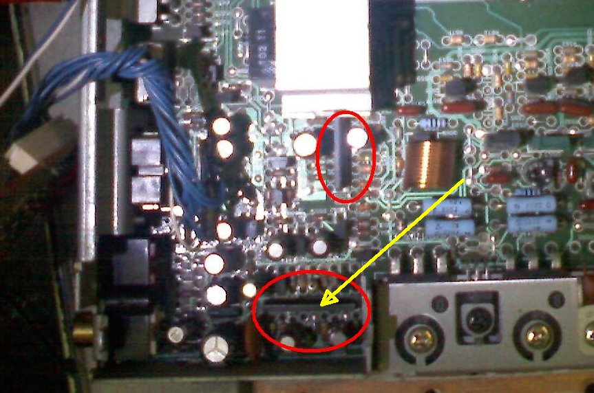

the op=amp indicated with the arrow , its use is in the left channel.
and this is the one with no negative voltage reading.
