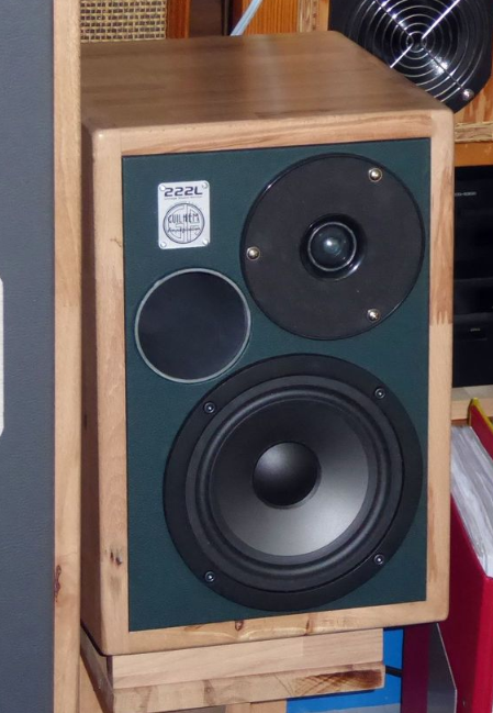

Do you have any recommendations of cool 3-way stand mounters or floor standing active system builds?
Yes, several:
LX-Mini - this can be run both with ASP or DSP, so that is another option for diving into a new area for the fun of it.
- If you are considering floor stands anyway, these are then integrated already ;-)
Pi-Speakers, for the non active build I think the 2Pi and 3Pi would still be just about ok for size.
I have not build these but the 4Pi's in a slightly different version, with the possibility to use both passive (external) and active filters.

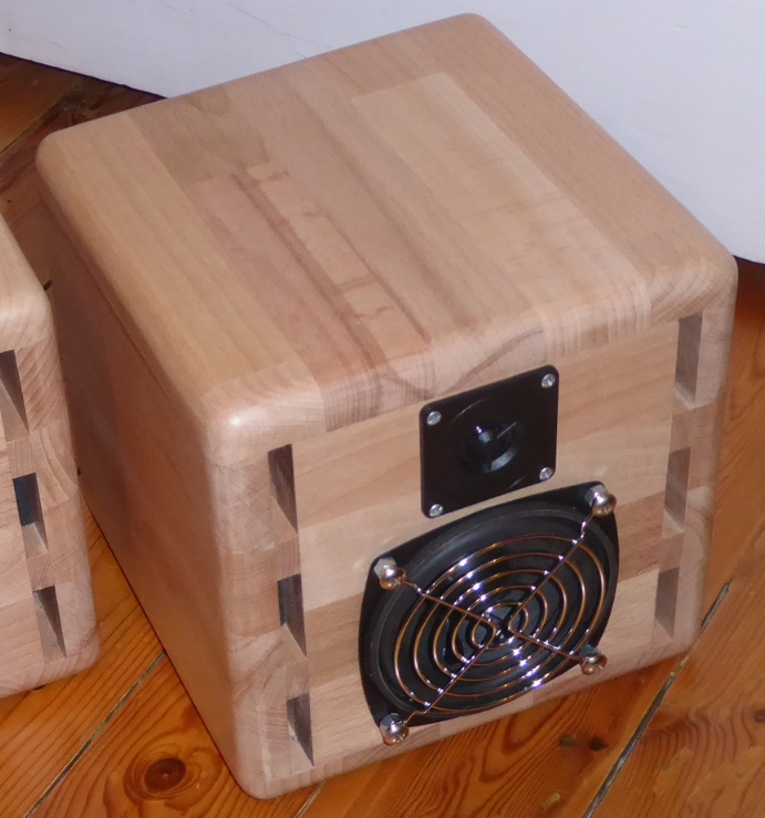

These were joined in the corners using Festool dominos, but I've also used bisquit joining a lot on other builds in the past. I can recommend both, (best option depends on the board dimensions and how much slack/support you need from the bisquits/dominos for your build).
Now, these are made from 40mm solid oak, and sandwich-built front and back's = they weigh in at 105kg each incl. the filter. ...and the wheels 😆 Performance is spectacular...
Unless you particularly want to buy the complete kit of the Gravesen speakers, I cannot see any limitation on getting identical parts locally except for the drivers.
