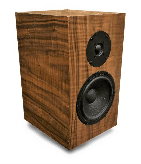

more on these speakers,Jule Fidelity
Anyone have experiences with this company ?
https://www.jfcomponents.com/jfpro-speakers
https://www.jfcomponents.com/product-page/ytmac-05-speaker-kit-pair
Jule Fidelity YTmac-05 Bookshelf Speakers
https://diy.midwestaudio.club/discussion/2462/yt-05
https://diy.midwestaudio.club/discussion/comment/51597#Comment_51597
hifiside
March 9 edited March 9
My subjective review on the YTmac-05.
Speaker placement around 8’6” apart and 44” from rear wall. Slightly towed in around 3/4”
Playing Bad Bunny ‘MIA’ for my low bass track (careful on the volume). The low bass fills the room well for a 5” I’m very pleased with the bass. Playing Donald Fagen ‘morph the cat’ the bass stays tight and loud with no chuffing of the port which any speaker I build MUST DO or there scrapped.
Playing 2Pac ‘dear mama’ for upper bass low midrange as Pac should stay exactly in the center of the stage I thought his gurgling voice sounded perfect while handling the (rap) bass notes. Also playing Eric Godoy’s “Aeris” for the low strings in this. I thought the strings sounded just thick enough and the background chatter (recorded in a bar) is still very audible.
For mine and many others I’m sure, i played the usual vocal artists. I believe the staging is open and does stretch well beyond the speaker placement Amber Rubarth “full moon in Paris” and with the speaker out at 5ft they almost disappear. With the speaker, I really tried to make the mid range and top end very neutral. The only hot sounding music would be some 80s hard rock like Kix, Autograph and Headpins certain songs.
Like I said, this is subjective obviously, but I will be keeping these so they will be at DDIY and Iowa 2024.
