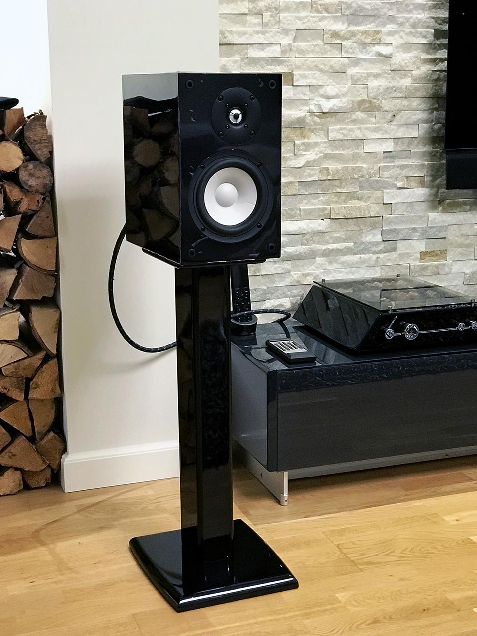

EKA Ceramic by StereoArt - same ceramic drivers with better crossover design.The Bromo from SB Acoustics is a strong front runner for me at this point.

The differene is componets in crossover. Then one for 280$ is with Mundorf MCap EVO Oil capacitors, MOX resistors and L-series Aircore coils,
another one is extra +140$ for Supreme Evo Oil for tweeter, Baked BL-series coils and MREC10 resistors.
Sound difference is like a speakers from next price tag.
Full kit with drivers with Supreme EVO Oil $662.74 With factory high-gloss cabinets (damping, port tubes, terminals, grilles) $1,165.66
Ask guys there for a shipping discount with UPS expedited or AirMail, they have some free shipping rules for certain amount and weight.
Probably you may get full kit without cabinets with free shipping.
The difference with Original Bromo is quite big. EKA Ceramic have much better midrange, off-axis (especially vertical) and phase transition from woofer to tweeter.
