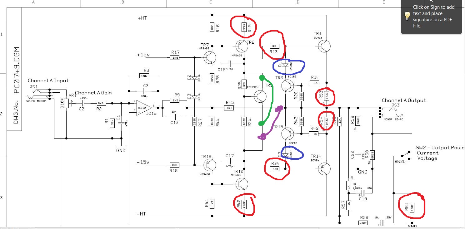

I have a Marshal 8008 power amp that I have owned about 15 years after about 4 years ownership it stopped working. I opened it up saw blown fuse (can't remember which were gone) tried replacing the fuse but I remember it just blew again so I put it in the loft and forgot about it as I knew nothing about electronics then.
I've been building my own effects pedals for about a year now and remembered the amp the other day, and now that I know a bit more I thought i'd have a go at repairing it. I've only worked on pedals so I am completely new to working on amps.
Image of internal layout:
Link to schematic:
http://www.amparchives.com/Amp Arch...Rack Mount Power Amp/rackmount_2x80w_8008.pdf
What I have done so far:
Pulled all 6 transistors on the heatsinks and tested them, found a short on the T64 /T65 pair on channel A. So I swapped them out for TIP 142 /147. (Although I did completely forget and bought them in a smaller package size than the original output transistors.)
Plugged a guitar into Input A and a 4ohm cab into Output A, turned guitar volume to 0 and amp volume to 0 and turned it on. The output transistors on channel A blew instantly and were smoking so I turned it off quickly. None of the fuses blew though.
So I lifted the base leg of all of the smaller transistors and tested those, all of them were fine.
So I removed the rectifier and tested that and it was fine.
While the rectifier was out I tested the voltage reading on the red and black wires on CON1 and got 57v reading.
Removed and tested the 2 big caps and both were fine so I put them back.
Does anyone have any Ideas what I should try next?
You need a methodical approach.
Initial testing would involve using a bulb tester to limit current and forcing the output stage to run at zero quiescent current. Also a basic check of the output stage components, in particular the low value resistors that may have been taken out by the fault.
Ultimately the fault is 95% guaranteed to be around the output stage but you can test and voltage check safely along the way. All easy stuff but is has to be done correctly.
It depends how keen and determined you are 🙂
OK then...

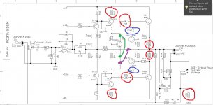

I've just picked one channel to work on. We begin with a basic check of the resistors marked in red. Confirm the value of each is correct. If they read OK in circuit then that is normally good enough. If any read low or high in circuit then you must isolate (unsolder) one end and check again. The low value 0.33 ohms on the output transistor are quite critical to correct operation.
If they are all OK we now remove the two diodes in blue. This will disconnect the protection circuitry.
A shorting link (green) is added across TR5. This removes bias from the output stage.
Its quite likely that the driver transistors are damaged (TR2 and TR10). If they pass all the basic static junction tests and don't measure as leaky then at some point we have to power the amp up and see what we can deduce. (These transistors should be checked with at least TWO leads isolated. In particular check for leakage from collector to emitter using a high ohms range. Meter polarity is important for this check)
There are two ways of powering this up. First is with new output devices fitted OR we can power up with these removed and confirm the operation of the main circuitry. I would probably recommend without as a first test unless you have found a specific fault in all these tests.
If you remove the outputs then ADD the purple shorting link. This maintains connects the feedback network connection.
Switch on briefly and confirm there no obvious signs of distress.
Then measure and record the DC voltage on the purple link. It should be close to zero volts DC.
Those are the first steps and hopefully should reveal a problem somewhere along the way. And use the bulb tester at all times. Also no speakers connected.

you need to test TR5 out of circuit, as well as the resistor that goes between Q5's base and collector, and make sure it's not open. a shorted (or open) B-E junction on Q5 or that resistor being open will cause the bias to be wide open, which would instantly fry the outputs.
Hello Everybody, i have similar problems with this poweramp.
I have already replaced OT and bias/driver TR5. Tested the other transistors and replaced the burned emitter-resistors. When i turn on the amp (with the "purple connection" suggested by Mooly) only one half wave gets to the output.
Without the purple connection, very much current is drawn (smoking OT and mains fuse flashing). I am not sure whats the next step.
Should i remove the output transistors again (they havent smoked yet), to fix the problem? Or is it obvious what to fix/change?

With the setup recommended by mooly in the drawing, one check I will do it is removing the output transistors and power up the amplifier. Then read the voltage going to the speaker of the bad channel. If the drivers are OKAY then the reading should be close to zero. It maybe pos or neg depending of the problem with the drivers if there it is any.
Confirm. With light bulb or room heater in series with AC plug, input shorted, from the very beginning 3,2,1 of op amp should be about zero. Then if that okay center R28 & R44 should be about zero. Etc.
