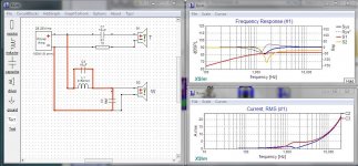

Not to compete with anyone... but I think I should point something out about the way I do crossovers.
When I work on crossover circuitry I generally avoid series resistors and parts that couple to ground. This is in the name of efficiency. Every part you run across a speaker or to ground and every resistor you put in series, reduces the crossover's efficiency... it takes amplifier energy away from the speakers.
In some cases this can be really nasty. The thumbnail below shows an "amp killer" that caused so much heat as to push it into thermal shutdown at relatively low power. I've marked the current path in red and activated the current monitor panel in XSim so you can see what is going on.
As the frequency increases the current through C3 and C2 will increase very rapidly beyond the crossover point. The current chart shows it can reach 20 amps... yes 20 amps. Not many amplifiers can provide that and especially not at high frequencies.
I've seen this mistaken design advocated as an easy "baffle step" on other DIY forums and it's obviously a terrible mistake. Even when accidental paths like this aren't fatal they do detract from the efficiency of the crossover. The telling line is "These speakers sound good, but they don't really come to life until I have 100 watts on them"... So, lesson learned, I try as often as possible to create crossovers with a bare minimum of parts connected to ground.
Now for clarity, I'm not criticizing anyone. The designs I've seen here seem just fine... What I'm explaining is why my designs may seem a bit odd at times.

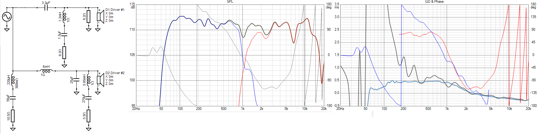

Ok, the 5.85mH shown is the 2.3, the 1.75 and the 1.8 in series. If you measure the resistance of them in series, take it off the 3.3 ohm resistor I have in the sim making sure to consider the 1 ohm listed by the inductor (in other words 4.3 ohms is wanted in total but you don't need to be too precise). The 1.2mH is the two 600uH.
Group delay in black with excess in aqua (I delayed both drivers equally extra amounts to make the job easier but forgot to change back for this).

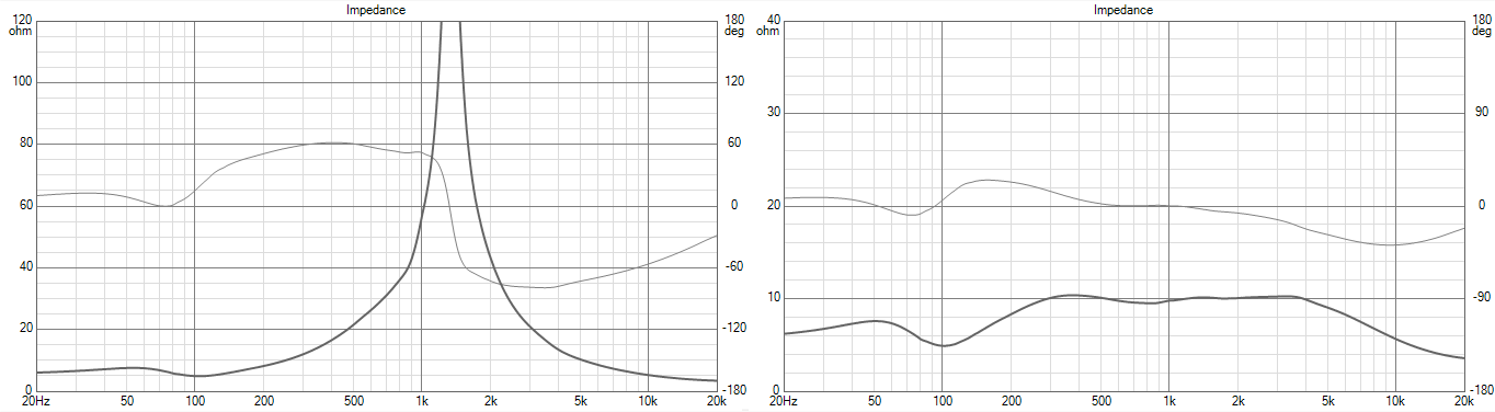

There was a honking great impedance peak (note the scale used between these plots). The LCR with the 0.22mH is only there in case you use an amp with a higher output impedance, or in case you decide you don't want this impedance phase near your amp.

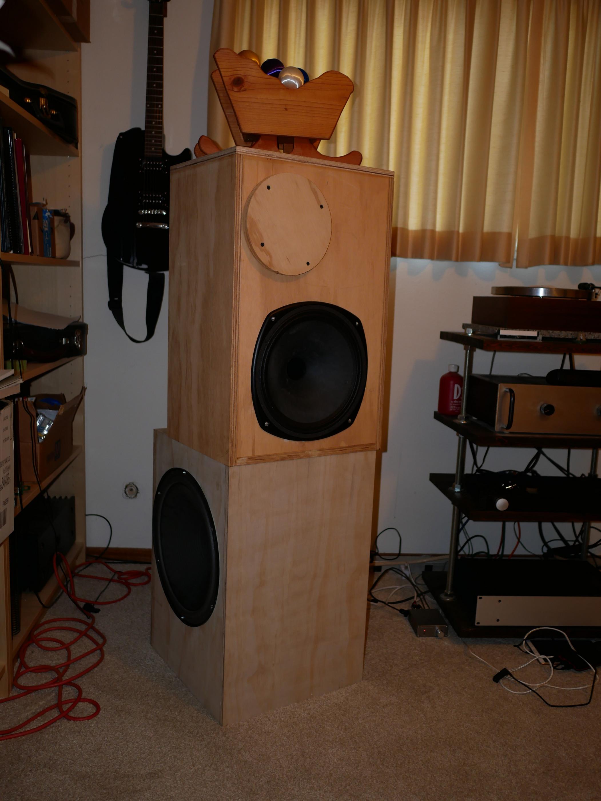

Update: The new woofers are up and running, so here's a picture. Cosmetics are not a priority at this point. The Tannoys are in boxes re-used from old projects, with the port holes blinded over. They are driven by two channels of the Modulus 86 amp at the bottom of the equipment rack. A miniDSP 4x10 HD handles EQ (4 peak cuts to flatten the Tannoy's FR but no explicit baffle step compensation) and crossover (150 Hz, LR4).
The woofer boxes are new, made from cheap 3/4 ply from the local home store. You can only see one woofer in the pic but there is a second one on the opposing side, with the magnets braced to each other and to a central brace in the cabinet. The drivers were $23/each Parts Express buyouts from several years ago, Jamo part number 30688. The 3 ft^3 box is too small for two 15's so the Q is high. The original intent was to use a Linkwitz transform to reduce the Q, but that has not yet been implemented and for now it does not seem to be a problem. The bass on this track has pretty good impact.
In room the woofers measure flat to 40 Hz, -6 dB @ 31, -10 dB @ 28. I use a couple of sharp peaks cuts in the miniDSP that correspond to room modes. The room is only 11 x 14 and I only have one real listening position so I am OK with using some EQ to flatten the bass at the listening position.
The woofers are being driven by two Breeze TPA 3116 stereo class D amps, one amp per side, one channel per woofer. That's the tiny box on the floor next to the rack, a big 30-some watts per speaker. That's not much in subwoofer land but with four 15's in a small room each of which is good for 93 dB/2.8V, I don't seem to be hurting for volume. The efficiency of the woofers just about matches the Tannoys.
This was a cheap experiment since I owned the woofers, the amps, the miniDSP, and plenty of wire. The only cost was a sheet of plywood (one sheet made two 3 ft^3 boxes including braces, I don't think I could get more volume than that) a couple of 4-post terminal cups and some more banana plugs. I think I got my $50 worth.
Next step, biamp the Tannoys using the remaining two channels of Mod 86. Maybe in January.
