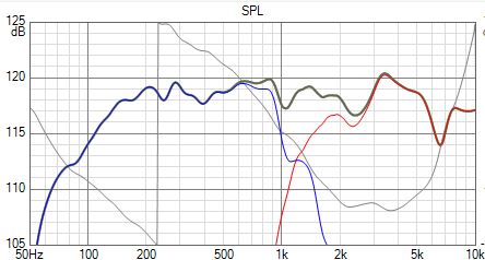

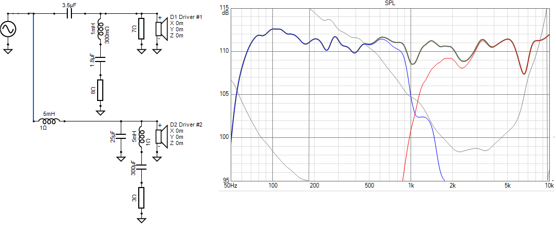

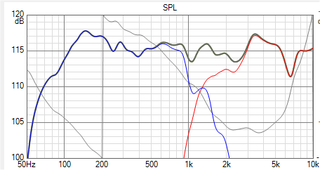

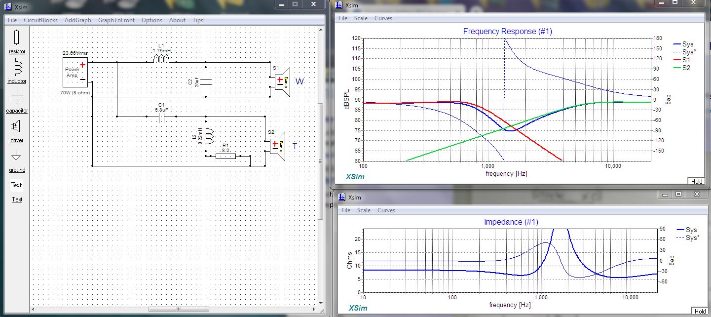

Thank you for the drawing. It shows a very basic Second Order crossover.
Modelling it in XSim, without knowing the exact driver specs...
I got what you see in the first Thumbnail. The cross over frequency is about 1.4khz and that's quite the drop out at the upper voice range.
The second thumbnail differs only in that I've inverted the tweeter (reversed the connections) and it looks a lot better.
The third shows a little bit of parts tampering which seems to get it even closer.
Now I can't promise success with this, but I would at least try reversing the wires on those tweeters.

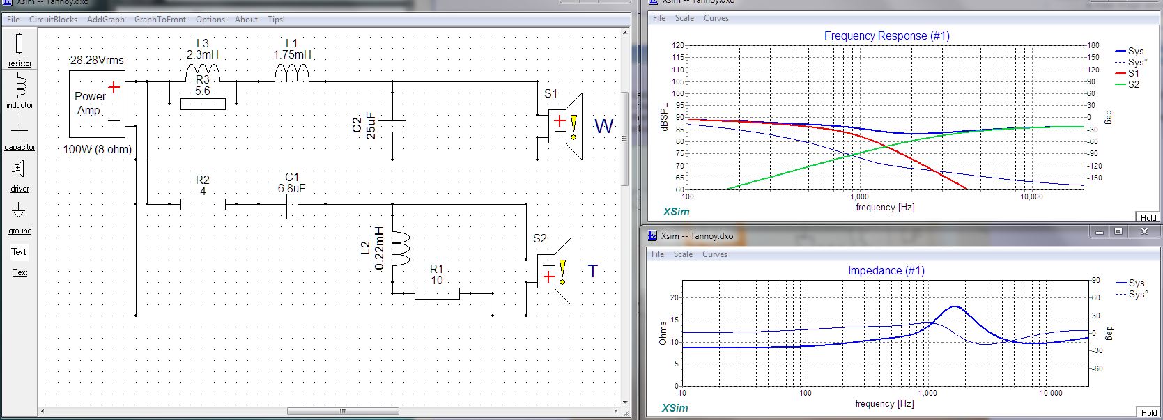

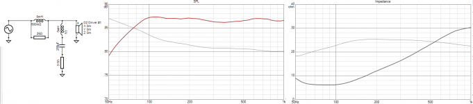

Just for clarification, I drew up what I'm running right now. I drew orange boxes around the parts I added, the rest is stock XO:
(I did reverse the tweeter polarity)

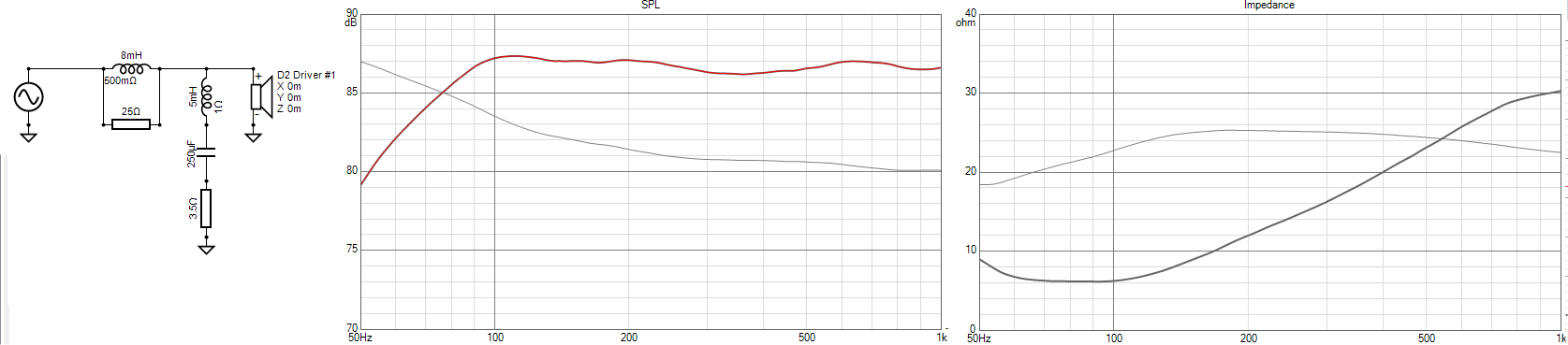

According to that online BSC calculator, that 2.3 mh & 5.2 ohm resistor should do 6db, but it doesn't sound like it, maybe more like 3db. Or it is actually doing 6db and the speaker needs 8db ?
The thing to understand with baffle step compensation is that you are essentially attenuating the woofer above a given frequency. As the frequency rises, the added coil carries less and less current until it's all going through the resistor... so you are essentially knocking down the overall bass in favour of a bit more apparent low bass. This is not always a bad thing. But please be aware that 5.6 ohm resistor with a woofer measuring about 6 ohms will be carrying half the amplifier's power throughout the mid-bass region. So be sure it's of a rating to handle it.
Modelling what you have now shows only a modest increase in low bass with a general loss of output across the rest of the range. I'm not sure it's worth it.

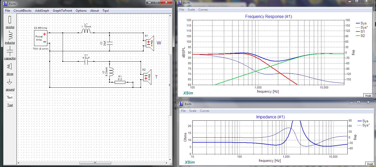

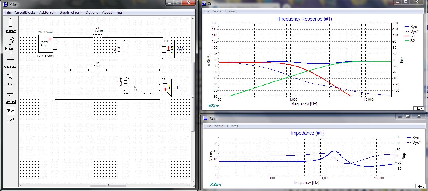

Also attached is my XSim model of the factory xover, which includes the measured 108 mm / 4.21" delay between the woofer and tweeter - a sim without the delay won't be too close to reality! I'd like to remeasure the FR's of the drivers in a better environment than my den but this does show how well the factory crossover works. It would probably help to be able to get further away. I should also use responses averaged over a window than the single-point sweep used in the sim.
I'm sidestepping the bass issue by crossing mine above the baffle rolloff using miniDSP. The woofers I'm using now are too inefficient to keep up, I need ~13dB attenuation on the Tannoys. The glue is drying on a test woofer box as I write that should be a better efficiency match (2 x 15" per side, sealed box with eq). At some point I'll bypass the passive crossover entirely and tri-amp the system. It remains to be seen which approach will stick. Or whether this is a fool's errand entirely.

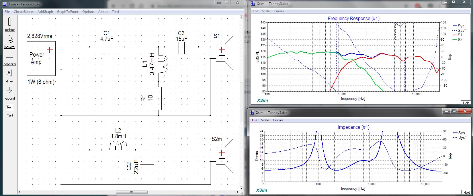

Been working on the high pass only for a while now.
One thing I have noticed, no matter how small a series resistor I use to pad the tweeter, it really robs the top end sparkle and makes the sound 'dark' (that's with and without parallel resistor).
(A note about my resistors, they're all Dayton wire wound 'audio grade', half of them already 'broken in' / not used for the first time. I do notice break in on these during the first few minutes when new, so I always wait a few minutes between making changes unless it's way off)
I've been trying different combos of series (2 - 4 ohm) and parallel (7 and 8 ohm) resistors.
I really wanted to make it work without series padding, as it robs the precious top end sparkle. I kept incrementally stepping down in series resistor values from 4 ohm all the way down to no series padding. With none, the tweeter is a little too loud of course, due to my BSC.
I then tried only a parallel resistor, first 8 ohm: still too loud but close
Then stepped down to 7 ohm and it puts the tweeter level in check, but also majorly transforms the tweeter response.
I originally was hoping the parallel tweeter would null the upper midrange peak that's noticeable on some program. However, adding a parallel resistor to the tweeter significantly smoothes out the mids WITHOUT robbing any of the top end sparkle.
I know, measurements would help.
Best way I can describe via my ears:
Before:
Studio monitor-like mids with tendency towards subtle midrange bloom (almost like a Klipsch but without the ice pick ramming into my ear drums, ie smooth, not shouty).
After:
Hifi like, slightly scooped mids now, great top end treble (top end unaffected, but less mids).
Needless to say I'm really excited about this. I will need to find the ideal value for the parallel resistor via more listening.
I realized that perhaps the parallel resistor makes the high pass sound in real life more like what the crossover would suggest on paper: a hole between the drivers, ie scooped mids. So I may start messing with increasing the 6.8 uf tweeter cap. But first I will listen for a while as is, it's quite pleasant but also less revealing. Maybe the perfect sweet spot is somewhere in the middle.

On one hand the hole is making up for a broad peak in the lower treble so there shouldn't really be a hole. Still, I think I like where you're going with this for now.I realized that perhaps the parallel resistor makes the high pass sound in real life more like what the crossover would suggest on paper: a hole between the drivers, ie scooped mids.
However the effect is going to be biased toward the low end where the series capacitor is filtering most, and also where the impedance was higher before adding the parallel resistor due to the amount of change (impedance plot).. and neither of these coincidences is necessarily tied in toward voicing.
Another option is to add a small capacitor in parallel with any series resistance to give back the highs.
Hmm, with the double impedance peak I figured they were using the default enclosure. I tried to cut the low end down to something more common, and I used the plotted response. I also used the plotted impedance, with derived minimum phase. It's usually better with measurements, but there's a way.which I understand is an infinite baffle
The upper impedance peak became a limiting factor so I used a series notch filter in parallel with the driver. Before this, the response was cutting off well above 100Hz (or peaking if I pushed it), Getting -3dB at 70Hz required cutting the midrange by almost 12dB.

Based on the factory DXO file provided by @lousymusician ... here is a mod you may like to try.
It's based on the 3rd order model and it does a baffle step, of sorts, by slightly attenuating the tweeter and evening out the response a bit, without wasting any energy on new parts hooked to ground or using inline resistors.
I used lousymusician's files to cross-check. Different results again, but there's always something to be gleaned. Thanks lousymusician, are these your own?
Comparing the stock crossover, to adding the 2.3mH, 5.2ohms, and 7ohms shows that the bass still doesn't reach well below 100Hz. I also think it shows you have good hearing regarding the tweeter. And maybe the 4k and up region shouldn't be falling away from 2k. Personally I go a little more as Douglas has, but the directivity of the waveguide plays a part and you are the judge.
