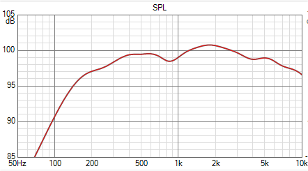

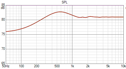

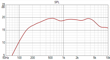

Comparing the stock crossover, to adding the 2.3mH, 5.2ohms, and 7ohms shows that the bass still doesn't reach well below 100Hz. I also think it shows you have good hearing regarding the tweeter. And maybe the 4k and up region shouldn't be falling away from 2k. Personally I go a little more as Douglas has, but the directivity of the waveguide plays a part and you are the judge.
Yes, these are measured in my 11 x 14 ft den, with REQ and the MiniDSP UMIK, and the S&L Woofer Tester II. The Tannoy is in a box measuring 24 x 15 x 12 (internal). I posted the measured TS parameters in one of KnR's other threads.

That looks really good, thank you for modeling that.
Looking at the sim of what I have now, it seems like if I had twin subs playing to about 100hz it would be great.
Looking at your third sim, with 8db of BSC, that looks about as good as I can ever hope to get these playing stand-alone. A -3db point of 60hz and reasonably flat throughout the whole range. Put my super tweeters on top and it's a wrap.
Since the cost of the required XO components is far lower than building twin subs, or big towers with active 15" helper woofers, I will go ahead and build the suggested XO.

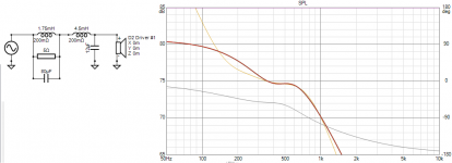

The next step with this is to try to make it fit with what you have and optimise a few things.is it OK to go with 18ga for the woofer and tweeter? Stepping up to a larger gauge does significantly increase the cost.
There are three inductors there, two are in series with resistors. The resistance of the inductors can be traded against the resistor value (note I've already included some nominal amount). This is the opportunity to use your inexpensive coils.

Ok, the 5.85mH shown is the 2.3, the 1.75 and the 1.8 in series. If you measure the resistance of them in series, take it off the 3.3 ohm resistor I have in the sim making sure to consider the 1 ohm listed by the inductor (in other words 4.3 ohms is wanted in total but you don't need to be too precise). The 1.2mH is the two 600uH.
