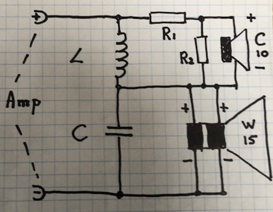

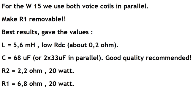

Ponger suggested this since the full range drivers are the same and the woofers are similar:
Audio Dandy - How to enjoy High Resolution Audio
Here's the x-over
and it's list of stuff to buy

Well you may as well as give 'Audio Dandy' a go, at least be pepared to modify the crossover design to suit your taste. You'll also have to replicate his 'wood work' to maintain some integrity of the design. Your woofer is about 3 db more sensitive than the one he is using so you'll need to attenuate it with a resistor. This is where you'll experiment a bit.
The L and C components in the crossover by themselves (shown in the above pic) forms a series resonant circuit, which at one particular frequency their reactances will cancel to produce a short circuit for your amplifier.
So, don't play audio through to your speakers if both of the drivers have been disconnected from the above crossover. Always leave one driver in circuit with the crossover when playing any audio at volume. Series crossovers are tricky in getting the balance right that's why parallel networks are generally preferred.
