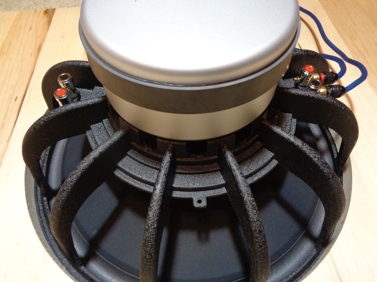

Now I'm confused. My woofer has 2 sets of voice coil connectors, but I only connected one set because I'm not sure how to wire both with my full range driver.

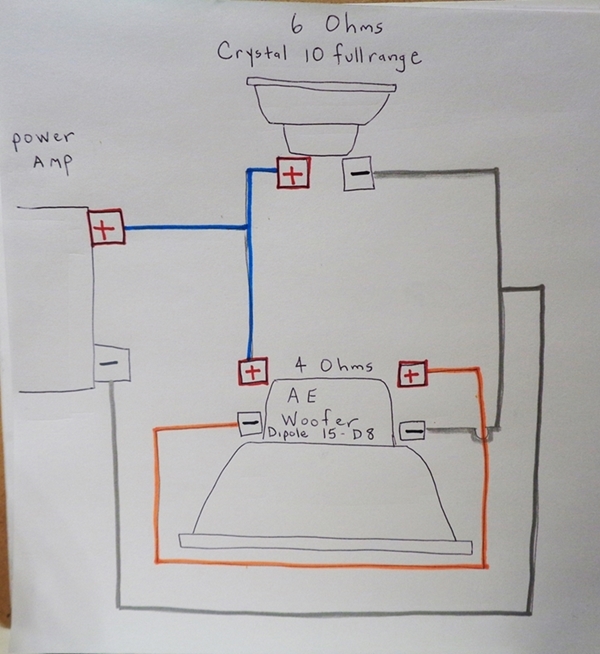

Ponger suggests series wiring. Would that look something like this?
Here's a close-up of one of the AE woofers.

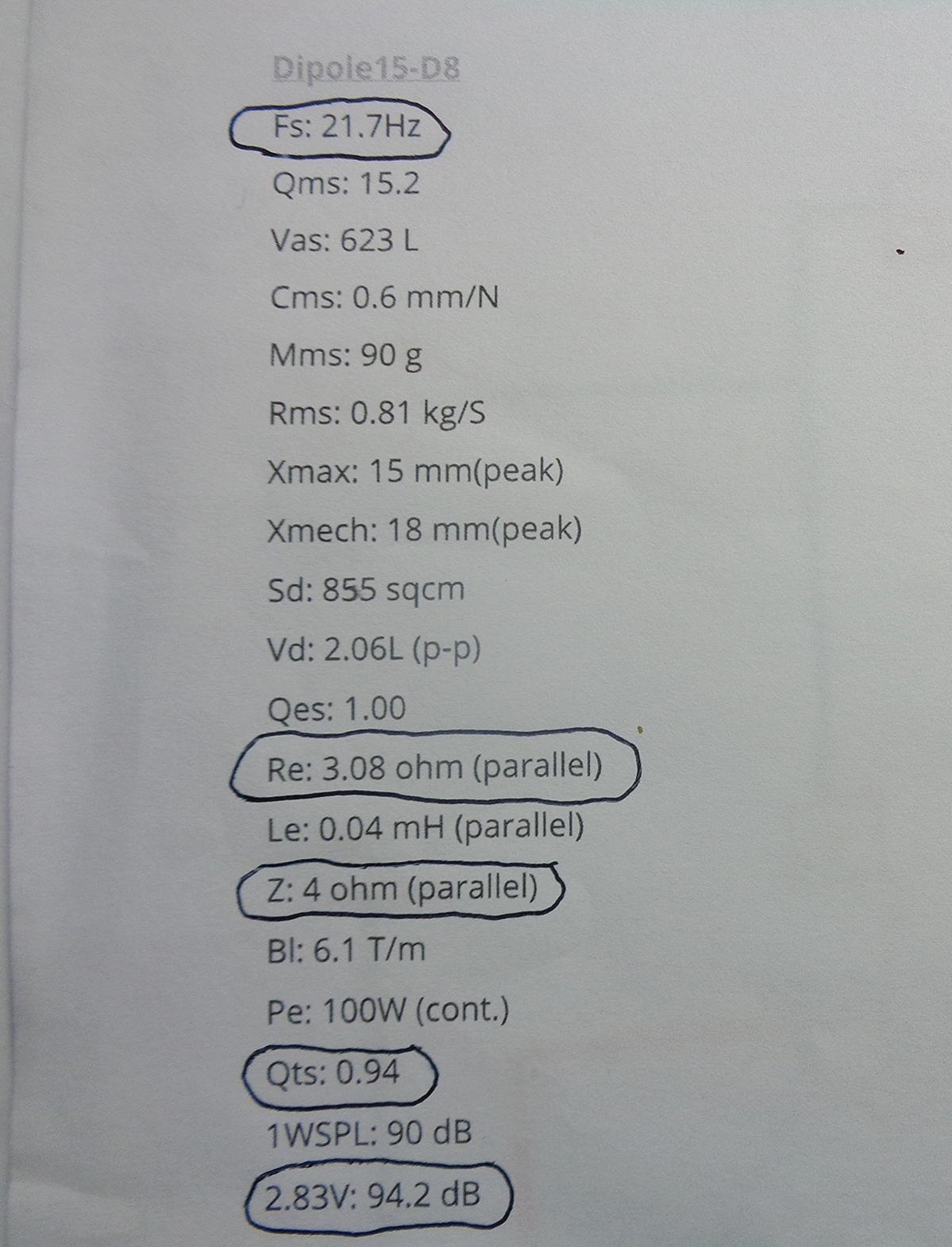

Tweet says they're 8 Ohms if wired in series. That would give me a 22 Ohm load. Speakers in Series Calculator - Geoff the Grey Geek says my amp can handle it. But Tweet (and the spec sheet) says they're 4 Ohms if wired parallel and that would give me a 1.5 Ohm load which would be very bad for my amp.
Is my understanding correct?
You should not be wiring them together without a crossover. At least not if you want them to sound good. But if you want to try it, just wire the dual coils in series to get 8 ohms. The impedance of the woofers is going to be rising anyway, so it's not 8 ohms all the way up. If the fullrange are 8 ohms you'll not be going under 4 ohms anyway.
No, the woofer's impedance would be 16 ohms if its voice coils are wired in series.
If the woofer's voice coils are wired in parallel the resulting impedance will be 4 ohms.
If you then wire the 10" Fulrange voice coil (6 ohm impedance) in series with the 4 ohm impedance of the woofer you would then have an overall impedance of 10 ohms.
But that's not a smart way of doing things as you would have to design a series crossover to work with that combination. A series crossover is not the easiest to work with and to pull it off. A parallel network is a better approach, where the woofer is wired through its own crossover in parallel with the fulrange and its network.
It would be better just to wire one 8 ohm voice coil of the woofer and leave the other 8ohm voice coil unconnected. This would give an 8 ohm impedance for the woofer to work with rather than 4 ohms which could possibly endanger your amplifier's output stage.
A driver's (Re) voice coil DC resistance is lower than that of its impedance and that can load the amplifier quite heavily over a limited bandwidth. That is why it is better to use a higher impedance driver with its higher (Re) voice coil than a lower impedance driver. The associated crossover if not properly designed can cause the impedance to drop very low so padding out with some series resistance at the input of the crossover will help protect your amplifier.
So aim for a parallel crossover network with some series resistance to keep the impedance up from getting too low for your amplifier.

No drivers are wired together yet. But the info is conflicting. Here's the woofer's specs:
So I'm thinking the voice coils are 4 Ohms each, not 8. If I wire a woofer in parallel won't it turn to 2 Ohms?

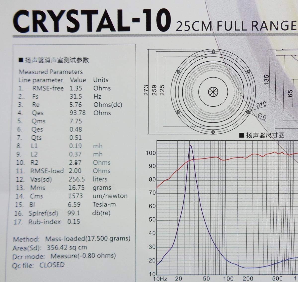

Here are the specs for the full range:
If I wire the 6 Ohm full range in parallel with the woofer wouldn't it drop below 2 Ohms? My amp can't do anything less than 4 Ohms.
