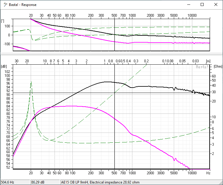

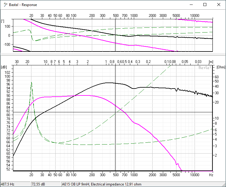

I'll try to do the sims today. With those woofers and your baffle size we need to see the projected response.
Here is what Basta! says for your AE Dipole15-8D woofers on a 24x36" baffle. XLbaffle agrees.
Black is the response on baffle with no filter, magenta is with a 9mH inductor in series. Also shown is impedance on the dashed lines. This shows that is you want the flattest bass response in a large room, you'll have to give up about 10dB in efficiency. That's typical. However, room gain will count for a lot, and you might end up with near 4mH for flattest low end. That room gain will help a lot. But it depends of course on your room and your placement of the baffles.
The second graph shows what the response might look like with room gain and the 4mH inductor.
Next you'll need to figure out what high pass is needed to put you 3dB down circa 450 hz. Nominally 44uF @ 8 ohms, but probably much less because of natural low end roll-off. That give you a first order crossover. If you feel that teh woofer is contributing to much up top, you can experiment with a large cap (~22uF) across the woofer. That will roll off the top end faster than just the inductor alone. I suggest buying a range of cap values from P.E. or Madisound to experiment with. Buy the non-polar electrolytic caps to experiment with, then figure out if you want to invest in $$$ caps when you settle on a value. Getting the value right is the most important thing. A nice film cap isn't going to sound good if it's the wrong value.
P.S. Just put the woofer in the center near the top. Moving it around on the baffle didn't make much difference, so keep it close to the fullrange drivers.
