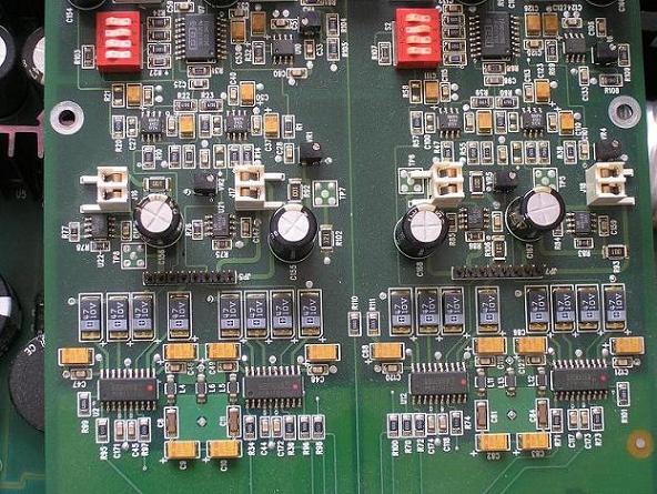

never posted before, but I think I should share some testresults regarding I/V conversion opamps, my advice is this: go for lowest distortion and high slewrate, try opa842, ad8045 or ad9631...
Wadia 27ix use opa642 (=opa842) as iv for pcm1702 and everbody who have heard it recognise it as one of the best sounding dac´s.
In my own krell kps30i and a friends kps20i we have tested opa842 up agains opa627, ad8610 and opa134. It was clearly superior with a much better definition mid and high and very analog in sound...
Only drawback is they need +-5V.
Attached is a picture of one of the two dacboards from a Wadia 27ix I had in for repair (most serious piece of epuipment i have ever seen, with a large margin...), hires is available on request

psu is current source and allmost everything is locally regulated and carefully bypassed. Notice the filtering for the shuntregulated dacs...
sorry about the dust...
regards
