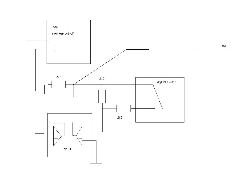

Dont think that they are readilly available my friend so I am flying with my eyes closed to some extent, I can understand most of the circuit, there is a filter built into the gain stage and the iv/out stage has sculpted decoupling and filtering (100ufdecoupling at that)
so what Im interested in is weather the lm4562 would be better, i was thinking of browndogging opa627/ths4031 but for the available technology in the unit a good supply rejection would probably be beneficial so the single channel of the lm4562 instead of the 627.
any way its based around a little something like this ...

wish I could, but these are soic's and so I am looking for some direction before proceeding, I was wondering if anyone has experience using the named opamps with filters in the said configurations or similar, or even mods to ARCAM dacs as they seem to be of common design (albeit a little rough around the edges) by the way I meant to say 100uf coupling as in dc blocking..(I should change my username to TYPO or something) dc servo how to would be great...

So anyway I threw a pair lm4562 at it cos i'm impatient like that! and I must admit that I am impressed, I would like to see a comparison between settling at different capacitances between that and the 2134, tonally a lot more balanced its like someone has gone accross the sound stage with an iron! I found that the 2134 in this app was fatiguing in the upper mid, sometimes drowned out sometimes aggressive in a small bandwith. and so is it fast enough for the job well it sounds awight so Its awight, I like it.
