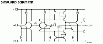

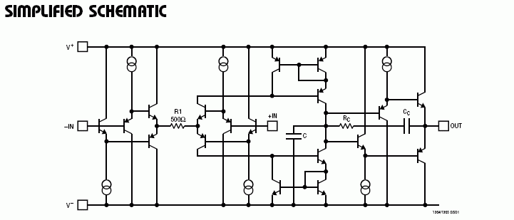

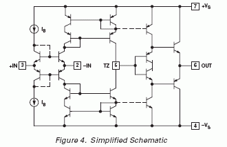

I just remembered I have a couple of these LT1364 blindingly fast ones that I bought a while back, what do you guys think for the I/V stage? Below is the simplified circuit diagram.
I remember I put them in the output stage of an MSB Link Dac once for a customer and they ocsillated like mad, so we went for some OP275 's instead, and he gave them to me, cost him $60au each.

I used it, but didn't really like the sound. Currently I use this quite famous circuit :
It gives the DAC a low impedance (an emitter). After the second transistor you add a RC filter, maybe even 2nd order, and then the signal edges are smoothed enough to widen your choice of opamp (or not to make the imput stage of your preamp slew limit).

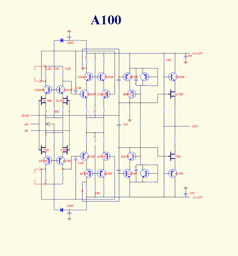

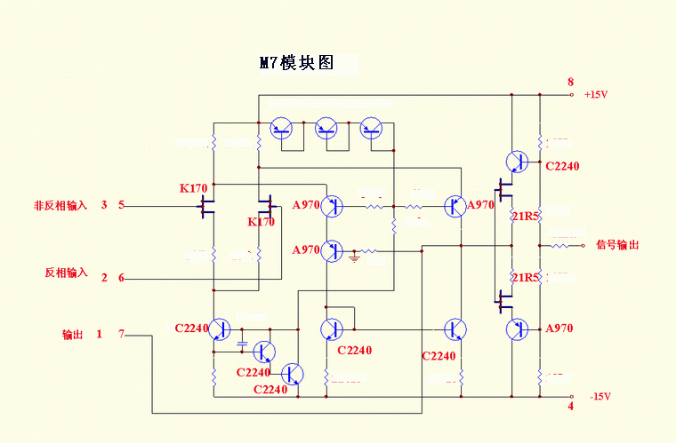

With the help of Ruach I found some cheap Chinese made discrete ready made opamps, for my I/V stage what do you guys think of them. Especially if someone can read Chinese.
http://www.audio-gd.com/PRO/diy/MD/MD.htm

georgehifi said:With the help of Ruach I found some cheap Chinese made discrete ready made opamps, for my I/V stage what do you guys think of them. Especially if someone can read Chinese.
georgehifi said:And this one.
Cheers George
They look like the kind of thing you'll find in a 20 year old back issue of the Japanese magazine MJ.

peufeu, what do you think of this one, it' got the low impedance input like yours?
Found a new one that AD built taking strong design for I/V conversion into account , note the input low impedance emiter loading, 2000vus slew rate and fast settling and 60mhz bandwidth. How does the schematic of this look for I/V?
http://www.analog.com/UploadedFiles/Data_Sheets/AD844.pdf
Cheers George
