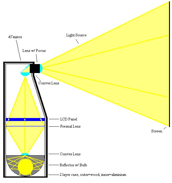

A 15" lcd has a viewable area of 12"x9". Therefore, the whole image shoud fit. The only thing that restricts the image is the Overhead projector. So if you were to make an enclosure then it should display the entire image with about .125" spare on either side. The fresnal could be tightly secured by two supports above and below the lcd (which will also stop excess light getting through). I'll include an image the show what I mean. And I'll also include my original design (has changed, but not on comp) to give an idea of making it.
Also. if anyone can help me find an aspheric condenser lens and a reflector to make a lighting design like at http://www.hommie.net/ that would be appreciated. Or if anyone has a lighting design to maximise the amount of light used and also evenly spread the light onto the fresnal that would be appreciated.
Note: The image isn't to scale, so that is not a 16:9 lcd on the fresnal.

This is my old design. Just to give you an idea of what I mean with making an enclosure. Once I finish drawing up my new design (or start for that matter) you should get a better idea of how I'm supporting everything and ventilation, etc.

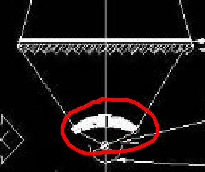

What if:

that design I drew before I had researched everything and so the ball shape of the light in my design is incorrect. I will be using a rod-like Metal Halide bulb, unless there are benefits of a light bulb such as yours?
What is that lens you are using to distribute the light onto the fresnal? I've included a close up of the lens circled. I hope you haven't already answered that already 😕
Could you include some pics of the insides of your projector at all? I've seen the pics at http://www.diyaudio.com/forums/showthread.php?threadid=8517 (great resuts btw) but I can't figure much out from that pic.
How big is your projector btw? If it's not too long (I have space constraints for where I'm setting up my projector) I'll just make it like yours instead of my design.

yes,the ball-like light is incorrect, rod-like Metal Halide bulb is very good, because it is fit , it can be set into space.
this is my lens:
