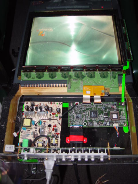

hey lifter
sorry for taking so long to reply but ive ben real busy with work
ok now to the good stuff u asked how i secured the fresnel i just cut the origonal mounts a bit mainly the small one so it wouldnt obstruct the lcd ,what i did was cut the top off where it used to hold the stage glass, and on the large mount all i did was remove 1 of the black hinge brackets so i can remove the top completly
at any time . there is also a long metal strip in the rear of the cover i has 3 slots cut out i removed it and bent the 2 outside peices flat to hold one end of the fresnel.
as for flipping the ohp the heat isue is still there i still need a fan to cool mine and i only have a 410w bulb i also flipped mine to go rear projection so i didnt need to use software to corect the image but nvidia has a program called nvrotate it comes in the newest drivers.
and i dont know why but when i remove the ground to the 2 h&v boards my lcd flickers constantly.
btw nice projector u got there 😉 looks like a sweet picture im gonna have to check out that movie .
i finished construction on my projector now i have to set it up somewhere dont have much room

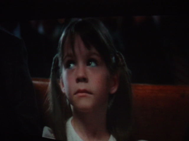

cruser said:oh ya lifter i just want to say thanks for turning me on to this lcd its ben real easy to work with and the results are impressive.
here is a rear projected image at 100" on a pulldown shade from home depot for $20
i cant wait to set up my real screen 😉

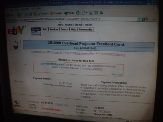

Well guys i sold my projector today and im on to a new one.
btw $750 for a $450 investment + time aint bad .So can anyone tell me whare to purchase a ultra sharp 15" 1600x1200 pannel
and compatable controller i seen a viper 2 controller that looked nice but cant find where to buy it

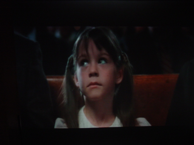

i dont know what to say to you ,if you are looking for a grand wega you should buy a grand wega. these projectors are not costing thousands to make for under $500 you will have a screen that will make you fall off your chair cause you feel like your in the game!! or at the theater . the circular rings lifter is talking about has to be a bad fresnel i have none of those rings
and for the screen door with an image of 100" if i sit 4'-5' away its nonexistent. I came to this fourm after gettin SMOKED on the 100" tv thing . after 2 weeks of reading i was ready ,and WOW i am verry impresed with the results from my first project . I had to sell my projector to my friend just to get him off my back, and dont use the pictures on this fourm to conclude what to expect cause its MUCH better quality than the pictures show.
My sugestion to you is get a 1600X1200 400:1 contrast ratio pannel + controller and a metal halide projector and if that dosent KNOCK YOUR SOX OFF then sell it ,you should have no problem gettn your money back ,and then you will know for sure if you can match the quality of that tv .
any ways heres another pic
