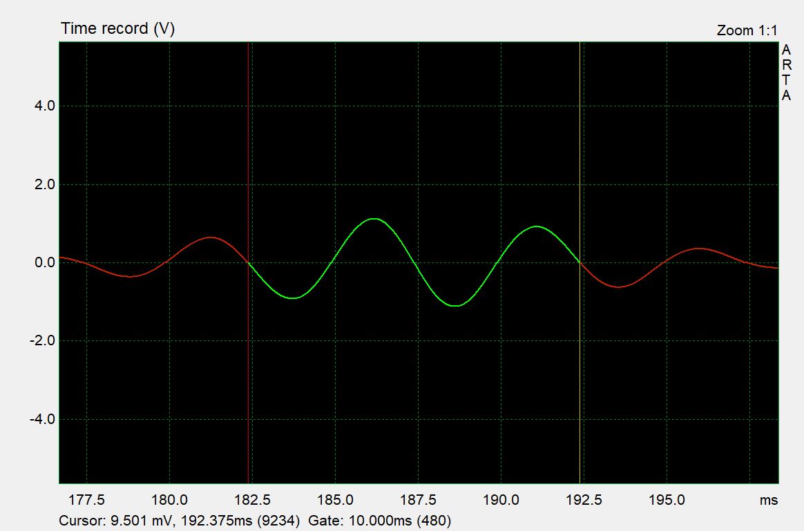

Correction:
I was making a mistake, saying the 200Hz wavelet measured with a slightly shorter period than the expected 5ms.
Here's a 200Hz wavelet carefully measured in the middle of a sufficiently wide bandwidth not to filter it.
As can be seen, 2 periods are 10ms, as expected.
My apologies...i reran experiments super careful, because prior 200Hz results just didn't make sense.
Also reran slowly moving the wavelet frequency into where it becomes filtered by xovers. The measured wavelengths change very predictably, ala what Mark, Ron, (and myself) have been thinking.

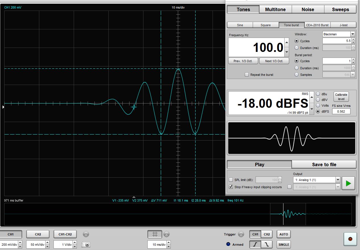

I've continued to play with wavelets for low frequency timing work and remain super impressed with their repeatable accuracy.
But that's not the point of this post...
Just want to share how well, how easily, REW also works for this.
Screen shot shows the Signal Generator and Scope.
I used Channel 1 of my soundcard as mic channel for capture [CH1], and set Scope to trigger off CH1 with rising edge.
Then simply click on 'Single' which Arms the trigger and turns on the Recorder for a single shot take like with a regular scope.
Press Play on Generator with whatever Tone Burst you've set.
Done...that easy.
Quite a cool little scope really, cursors and all...nice job REW ! 🙂

I am kind of confused with this. Normally, to find out delay, I would use two channel measurement with a loopback (or the Acoustic reference feature). The scope in Rew can be used in single channel mode e.g. with UMIK-1? I would think this is not possible. If I undestand it correctly, the scope triggers from Ch1 input and the time will have its zero always at the beginning of the recorded wavelet - or will it count the time actually from when the signal starts being sent to the USB device?
Scopes normally trigger on a timebase at a point along the vertical scale. This is done so you can reliably see the result.
I just do not understand how to measure any relative delay when the scope is triggered alway by the recorded signal. I could understand that if the scope was triggered by the loopback.
As I wrote, I am not sure I understand it properly, so that is why I ask. I think the wavelet method can be used only with dual channel measurement, I just need a confirmation if I am right or not.
Hi pelanji, yeah, I'm not sure how, of even if, REW's scope can be used for finding TOF. It does have two channels...maybe triggering off soundcard output on 1st ch and capturing mic on 2nd....dunno at all.I just do not understand how to measure any relative delay when the scope is triggered alway by the recorded signal. I could understand that if the scope was triggered by the loopback.
It's a beautiful scope for looking at a single wavelets, but when i realized there was now way to save and overlay wavelets, I quit working with it.
ARTA's dual channel recorder works great for TOF via wavelets/bursts. And it's files can be exported into REW if there's a desire for a better "scope look"

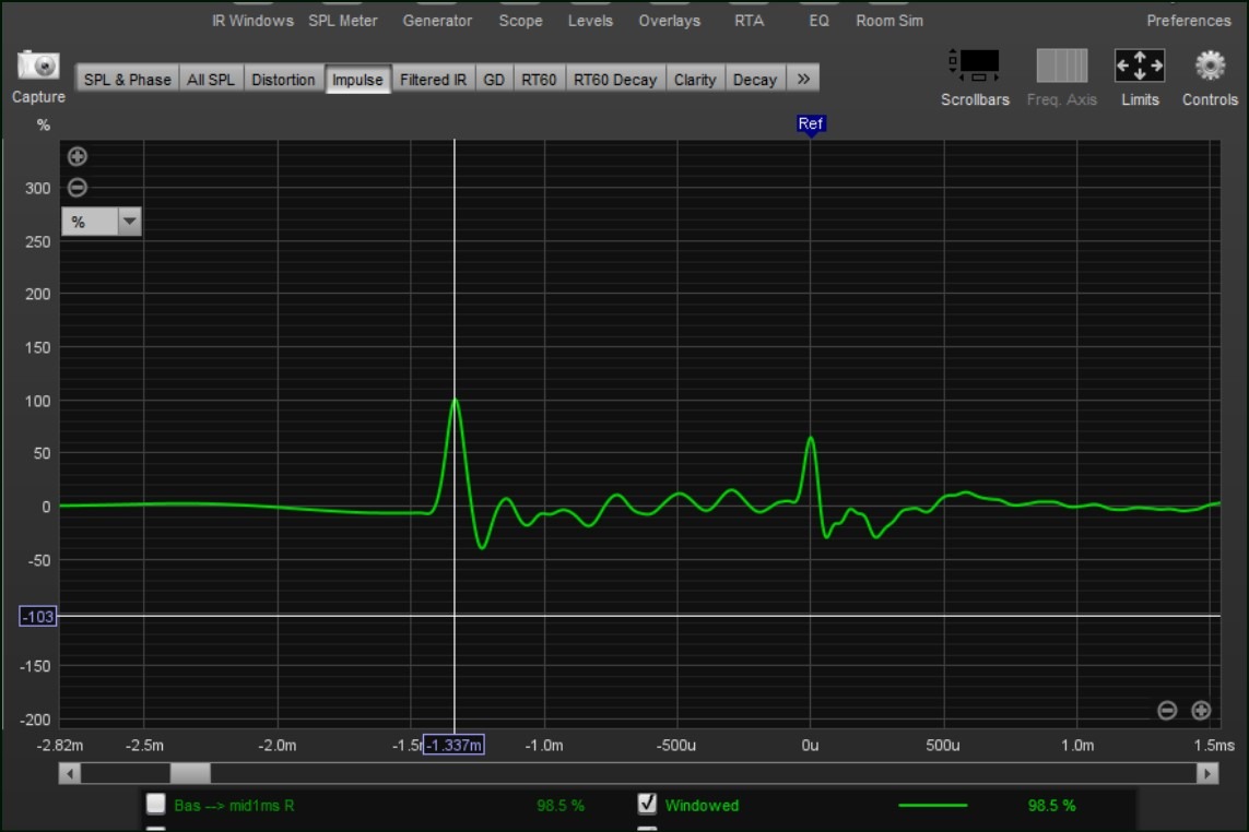

This one i did in REW, one have to put in 1ms on the most distant driver (in the xover) then swap the result with the one of interrest minus the 1ms (used for a gap) One only need one channel in rew out and in, and can bus to L & R out (in miniSHARC 4x8 for ex).
If the signal is strong enough you can tell the polarity is right also. Be sure to limit the after coming sweep to 1000hz to protect the tweeter. So in this case the tweeter earned a delay of 0.15 (5cm).

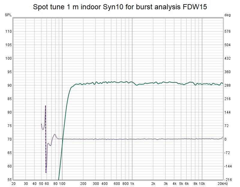

So to test that, I did a quick FIR-tune-to-a-spot of a Syn10, a 4-way MEH used from 100Hz up, with xovers at 300, 700,and 6300Hz.
To get flat mag and phase, and see what bursts look like.

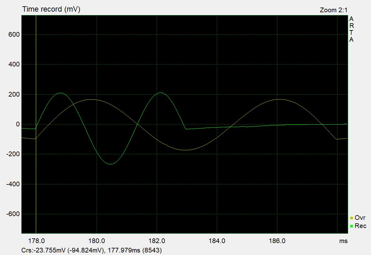

Here's a150Hz burst from the middle of the low drivers' range; and a 300Hz burst at the low-to-mid 300Hz LR4 xover frequency.
Note how the starts align up as surmised.

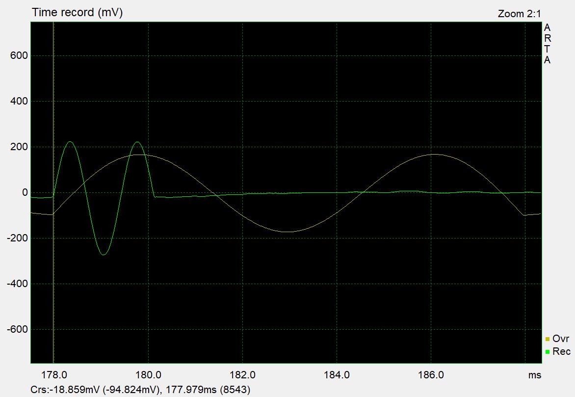

Here's 150Hz; and 700Hz, the mid-to-HF LR4 xover frequency

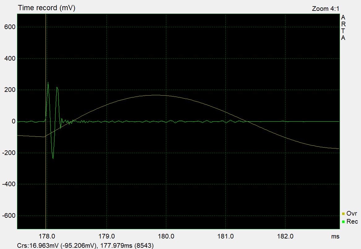

Same 150Hz; with 6300hz burst at HF-to-VHF LR 96 dB/oct xover.
The starts lined up, no matter what frequency, what driver, entirely in band, or in a xover region.
Again, this is for looking across sections ....not for looking at an individual xover.

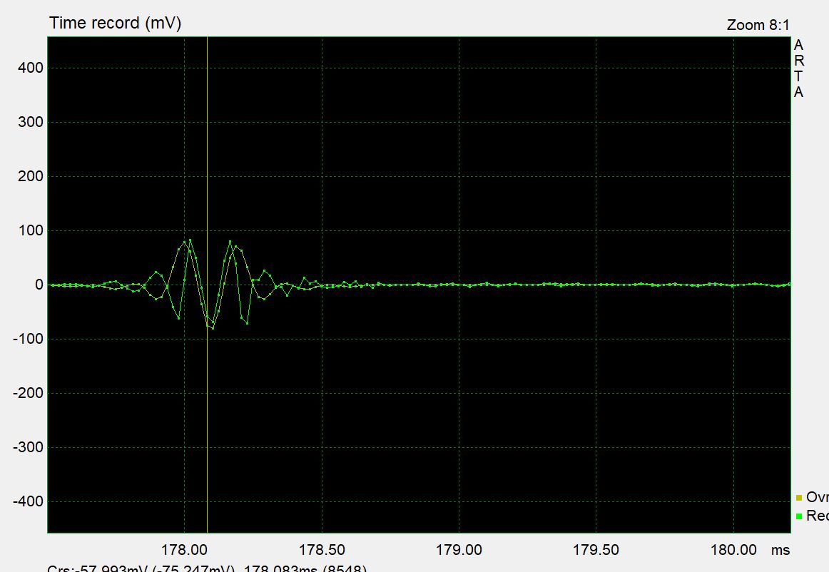

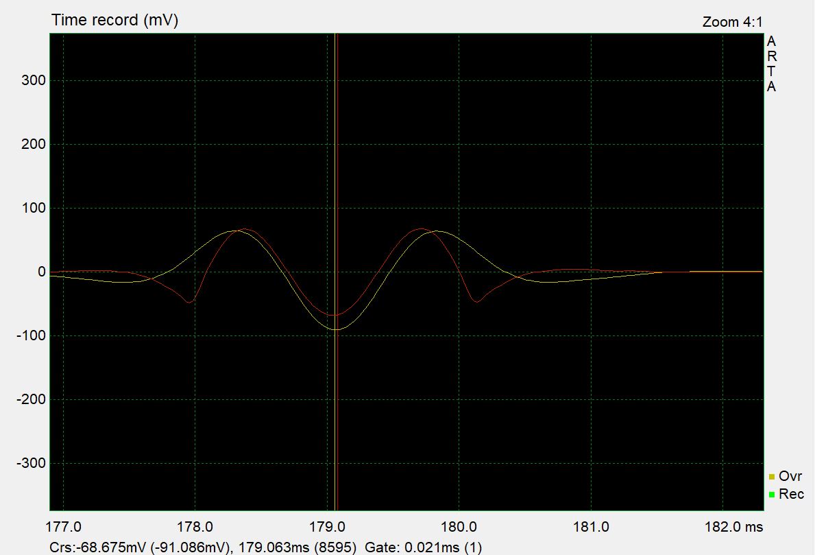

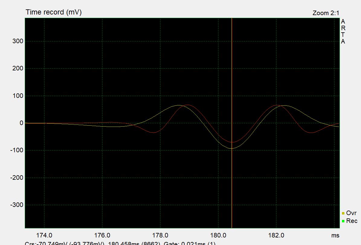

Here's the three xovers. 300Hz, 700Hz, and 6300Hz.
Note the centers align. And note a sample or so (0.02ms) misalignment on a couple of them ....that's the precision available if one cares.
(The last 6300Hz xover was at the limit of ARTA's resolution.....I should have used higher than 48kHz with soundcard)
Ok, hope that helped explain when to use, what part of a burst, for what task.

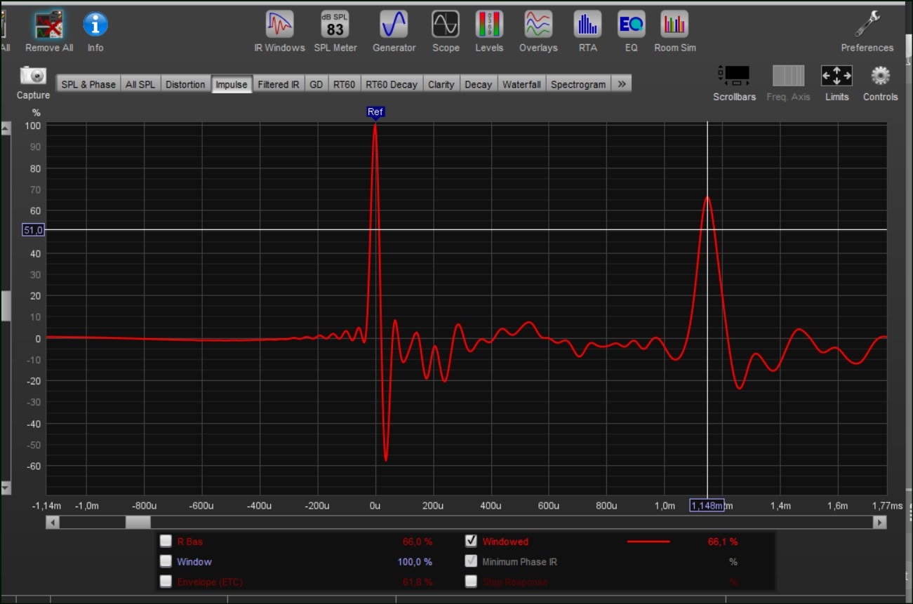

Mark, you have problem reading at sweet spot? I have great succcess with a 48v microphone.
Showing mid bass with 1ms temporary expander on mid. (3meter)
Hi viper_user, I'm not really understanding what you've done.
What two divers, or sections, are those impulses from? What were the passband ranges they covered?
And what was the stimulus signal...looks like normal sine sweep?
The thing is, with linear view impulses, each single frequency gets one vote as to where peak impulse timing is. So HF/VHF dominates the timing of the linear view impulse peak, and that's not what we need to time lower frequency sections.
We need lower frequency sections impulses alone, representative of the passband they will be operating in....to see where they begin, not peak.
Ime, impulse responses that cover significantly more higher frequency bandwidth than the driver section will be used for, don't work well for time & phase alignments. Unless peering into the driver section's bandwidth-filtered impulse response that decently matches up with the intended passband.
The starts rising from zero, of those filtered impulses need to be time aligned.
Aligning peaks across driver sections causes misalignment........that's what i hoped to show with my prior wavelet post.
Sure, I can catch decent sine-swept impulses at distance in a room, with repeatable TOFs (time of flight, aka excess delay, etc) provided there is enough HF energy...like at least up to 1000Hz.
But for subs, or low mid drivers, repeatability suffers, more and more as passband frequency range decreases.
That's why I'm so thrilled with the single-cycle tone burst for time alignment across sections....its repeatability is rock solid.
I knew i could use the bursts repeatability for xover alignments, e.g. sub to low, with greater accuracy than either phase overlay or filtered-impulses. (aligning burst centers.)
But until recent experiments, i didn't realize how accurate and repeatable the bursts work for timing across driver sections. (aligning the bursts' starts).
