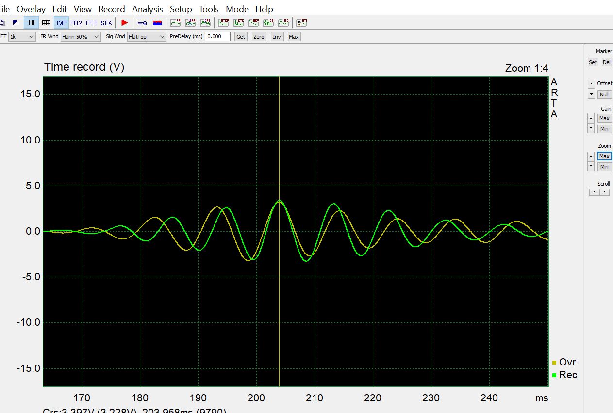

Using Arta in dual channel, go to Imp mode.
Under 'Record', open drop down option 'Signal time record'
Select Sine Burst button, and use settings as in screen shot above in #16.
Hit Generate, then Record.
A single wavelet will be recorded....Zoom and scroll for a good look.
Set as Overlay when you like the wavelet's size/position.
And then repeat Generate & Record for next driver/section, for comparison to overlay. (after using same zoom/scroll as per first wavelet capture)
That's it 😀
I guess that what you are seeing is caused by the sidebands present during amplitude modulation of a sinewave.
If a wavelet consists of three (sinewave) frequencies, filter two of them and you are left with the third.

The delay time for the two boxes without any xover in place was 0.3ms, which accurately reflected time-of-flight to mic distances.
With the linear phase LR4 in place, delay moved to 0.46ms.
With the LR16, it moved to 0.8ms.
Those delay times were derived from aligning the central peaks of the wavelets.
The 0.5ms variation in delay, from no xover to LR16, is surely minuscule compared to the group delays your examples provided, but I really expected there would be zero variation.

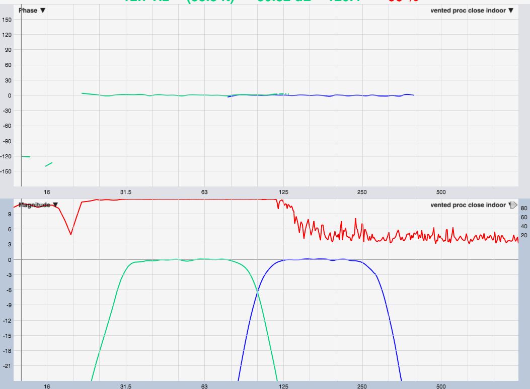

So onto the processor. Turns out there was the suspected FIR slippage from using 4k taps for 100Hz xover and 96 dB/oct.
Switched to 16k taps, and as can been seen below, problem solved....
fully complementarity at xover now.
Vented 18", 30Hz BW4 hp and 100Hz LR16 lp ; green traces
Sealed 18" (used as low-mid), 100Hz LR16 hp and 300Hz LR lp, blue traces.
Measurements/tunings made indoors at about a foot from dust cap.

As you mentioned, could be the FIR processing. Remember FIR filters have preringing and HP and LP will be different, and will be different with order.
Sorry John, my previous reply didn't fully take in what maybe you were pointing me to. I'm hoping so..
I saw 'preringing' and shortsightedly said, oh please not more preringing fault finding.
But I get if HP and LP aren't truly complementary, which they weren't because of prior limited tap count...well, then yes, there can be preringing.
Again, hoping that is what you pointing me to.
Happily all is well with truly complementary.
