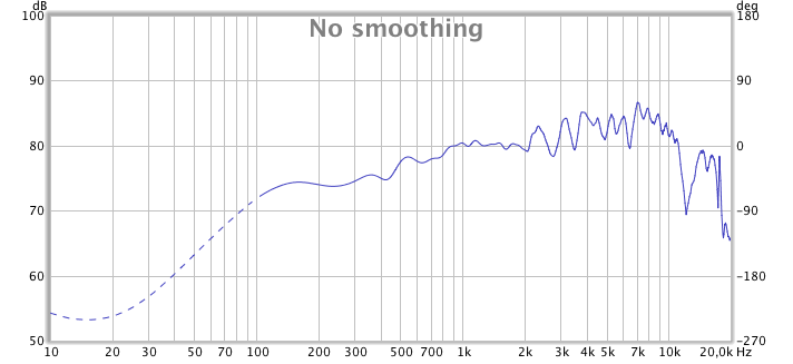

I've tried to use the blender .xls with a 8" full range driver. Unfortunately the near field and windowed response don't show much similarity in the blending region (200-600Hz). How to approach this?
I've attached near field and windowed response. The windowed response was measured in 1m distance and is gated after 3.5ms.
First Question:
Have you included the diffraction (baffle step loss) data? This has to be added to the nearfield measurement before trying to blend it with the far-field data. This is because a true the nearfield measurement does not include the baffle step response, but the farfield does, so in order to get them to line up for blending you need to add on the baffle step response, obtained from a model, to the nearfield. There is a built in baffle step modeler in the Blender, or you can use an external program, write the model data to an FRD file, and then import that into the Blender.
Second Question:
How close was the microphone to the driver dustcap or cone when you measured the nearfield response? The nearfield response shows a dip around 300Hz which I would not expect to be there unless the microphone was some distance away or some other factor caused a cancellation at that frequency. For a nearfield measurement the microphone should be no farther than 1cm away from the radiating surface for an 8in driver.
I imported your data into the Blender. I was able to get the windowed and nearfield responses to lie more or less on top of each other where I would blend them (between 500Hz and 1000Hz). To do this I had to entered -9 in cell B25. This value is added to the low frequency data. The idea is that the farfield data has the correct SPL level and you need to move the nearfield response up or down in SPL to match it. I uploaded a pic below taken from the blender to show you the result.
I hope that helps. Feel free to post more questions or problems and I will try to help, or you can contact me directly.

Regarding your 2nd question: the mic was a couple of mm from the dust cap.

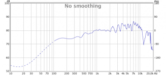

Here's a ground plane measurement gated at 8,7ms:

I think that you have highlighted an issue that I was concerned about. By blending from 500 - 1000 Hz, the final result could contain near field problems that would not appear in the far field. The large hole at 300 Hz is a classic issue. It does not appear in the ground plane results. I don't think that it is really there.
I agree with Earl. I think that your nearfield measurement is suspect. That's not the only way to create low frequency data for the blender. I suggest that you instead measure the Thiele-Small parameters for the driver and use a box modeler to create the response. If you use Woofer Box and Circuit Designer you can export theTS model response as an FRD file. You then import that into the Blender as the low frequency data set and add the diffraction model to that, just like you would do with nearfield data.

The ground plane measurement is gated at 8,7ms so there are not enough data points that would reliably show the hole.
What would be the explanation for such a hole showing up in a near field measurement if it's not really there?
Does the driver have a whizzer cone? I am curious what might be causing the nearfield to have that dip at 300Hz. Any ideas?
No whizzer cone. The driver is a Visaton B200. Here're the specs:
B 200 - 6 Ohm
Could there be something about 30cm away that is causing a reflection that is picked up in the nearfield? How about the back of the cabinet? 30cm is about a 1/4 wavelength at 300Hz. The reflected wave would return to the front 180 degrees out of phase and could cause cancellation that results in a dip. This just a guess on my part - you could try doing another nearfield measurement with an open back type mounting to see if the dip goes away.

I has to be something about 1/4 wavelength away, so it could possibly be the floor. At that distance (30cm/12") the relative strength of the reflection compared to the cone might still be strong enough to cause interference. Usually boundaries that are farther away have reflected signals that are so much lower in intensity compared to the direct sound that they do not really show up in the signal. Remember that the microphone is very, very close to the diaphragm for the nearfield measurement.
True, but we're splicing nearfield to farfield. A properly designed 2.5way goes a long way to reduce this null as the two drivers at different floor bounce positions create two nulls that shift lower with distance, but one covers the other to reduce what they each produce. Same thing as room modes, with proper sub placement can mostly correct. Just another PITA "cause and effect" thing to deal with.

Well, first I don't think anyone is advocating splicing in the 500 - 1000 Hz range. It's just used to assist is aligning responses, but even then, that's a bit higher than I would recommend even for that.
Second, how does close-mic'ing the response result in a hole at 300Hz? Nothing at this wavelength should interact with the a mic a few millimeters from the dustcap, unless this is a REALLY large driver. Or unless reflections are close to the same magnitude as the near-field response, but that would be odd given the proximity of the mic to cone. I agree with you that it likely isn't real and won't show up in the far-field, but I usually only see nulls like this above 1000 Hz even with 12" woofers. 300 Hz seems quite odd for a null using this measurement method.
If the mic is placed in the center of the speaker only a few millimeters away from the dustcap / cone you should get a much cleaner looking response plot than one posted above. Something doesn't look right to me.
