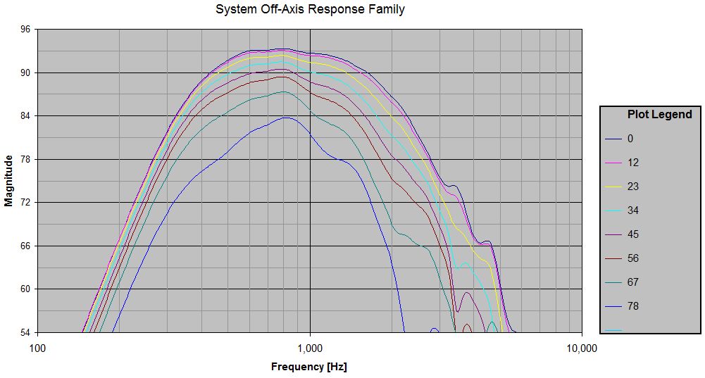

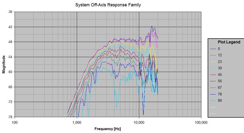

I recently began measuring my speaker projects on many axes in the horizontal and vertical planes. This helps me get a better idea of problem areas (holes or peaks) in the off-axis response. This information needs to be made available while you design the crossover (I think that is what you are showing above, not sure).
To address this need, I added some new functionality into my Active Crossover Designer tools to make it possible to import a number of off-axis measurements and see how the crossover influences all of the responses (both on and off-axis). Note that the data comes from actual measurements and not a model of the off-axis response for each driver.
I have attached two examples of this for a single driver with some EQ and filters added (e.g. not the system response). Please note that the version of ACD that can create these plots has not yet been released. There is also a new interface to generate surface and wireframe 3D plots instead of the line plots. I am waiting to get more experience with these new features, but everything is working well in my trials.
-Charlie

Glad to see that people are finally starting to realize that an axial response alone is not enough to do a good crossover. Too much goes on off-axis that is important. I have been doing this for almost a decade now.
I use a finer set of data near the axis than further away since this is where one wants the better accuracy. I use 5 degrees up to 20, 10 degrees up to 60 and 20 degrees to 120, then 150 and 180. The data is then fit to a radiation model which yields 2 degree accuracy over the entire field. I only do horizontal polars currently as this is what matters most. There is always a pair of nulls above and below the horizontal plane and you have to look at these on occasion, but then one finds that they stay pretty well constant with the crossover point and separation distance and can be ignored for any other issues.
