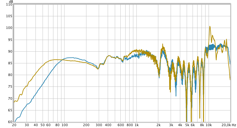

I agree with Earl. I think that your nearfield measurement is suspect. That's not the only way to create low frequency data for the blender. I suggest that you instead measure the Thiele-Small parameters for the driver and use a box modeler to create the response. If you use Woofer Box and Circuit Designer you can export theTS model response as an FRD file. You then import that into the Blender as the low frequency data set and add the diffraction model to that, just like you would do with nearfield data.
Does the driver have a whizzer cone? I am curious what might be causing the nearfield to have that dip at 300Hz. Any ideas?
Or use the built in box model in the blender. It's not as sophisticated as the full box model I used in the Woofer Box and Circuit Designer, but within reason the results match exceptionally well. Credit there goes to Don Keele who gave me the math I used for the simple box model that put in the Blender.
I'll redo the near field measurement on the "naked" driver without the box tomorrow.
Here's near field (dust cap) of the driver in the box (blue) vs. free air (brown):

Regarding your 2nd question: the mic was a couple of mm from the dust cap.

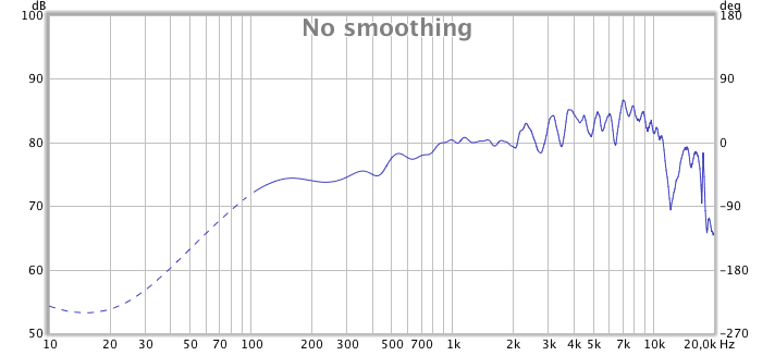

Here's a ground plane measurement gated at 8,7ms:

Why are you gating a groundplane measurement .... ?

Groundplane Measurement is best for measuring outdoors at least 5m from the nearest building or reflective wall. Doing gating indoors is ******* in the Wind, just drag the cabinet outside ...
Because it was done in a room with the nearest boundary about 1.5m away.
Does it matter?
Yes, for best consistency and relavance almost best to use some kind of reference voltage ..
Std voltage is not important here, I think. But for actual speaker xo work it sure is. We must remember that it is winter now at northern hemisphere, outdoor measurements are out of question now, for this discussion. But again, for "a real case" necessary.

Of course free field is best but there are obviously various reasons why it is not practical for everyone. That's why we're discussing alternatives to free field measurements in this thread.
Nevertheless my example apparently shows that the splicing technique doesn't work for each and every driver.
