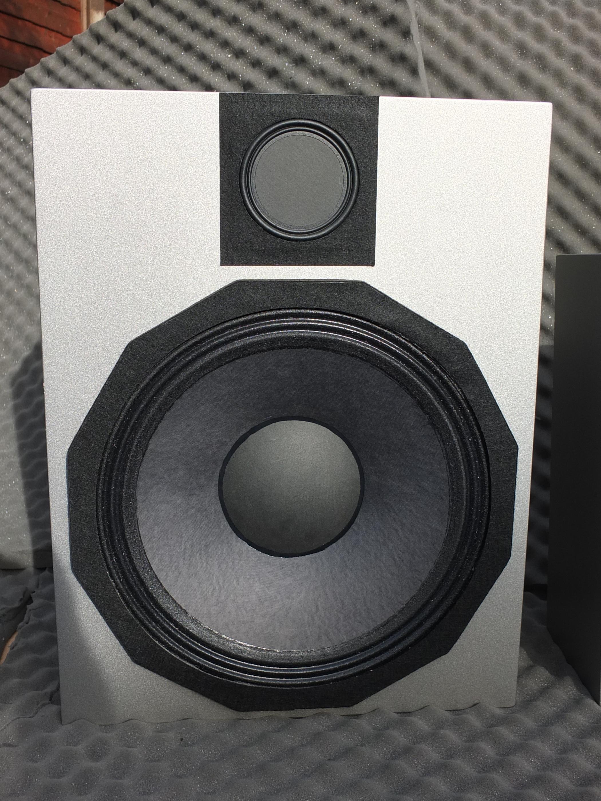

Great Derek, I look forward to hearing what you think of the 155N01's, what sort of size cabinet will they need ?
Thanks for the picture,that looks like a serious monitor ! Any chance of some pics of the new satellites & arrays ?
